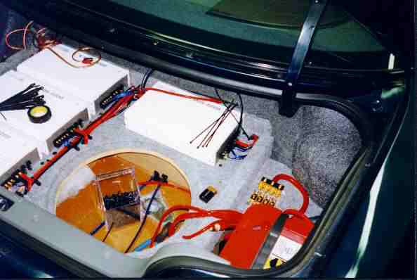

Theres 2 pictures of my trunk that I found online. It is a funny shape with the spare tire at the bottom, which Im removing to save weight. There is a hump at the back which is for the gas tank which my amps are sitting on right now. I will take a pic of my trunk soon and get some dimensions, but for now, search s14 trunk online and you may find more.
Im open to suggestions on how to fit 2 ported boxes big enough for 2 12s in the trunk.

I had that same car (my wife drove it) anyway it is a weird trunk, I do not see how you would get 2 - 12's ported without using glass.
I had 4 - 8's in a sealed box and had no room left in the trunk for anything.
Yes it is a very strange trunk, thats for sure. Lots of space thats just not usable. Think one 12 in a ported box is doable?
