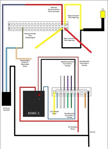

Hardwiring the factory reverse camera
It has the 40 pin connector

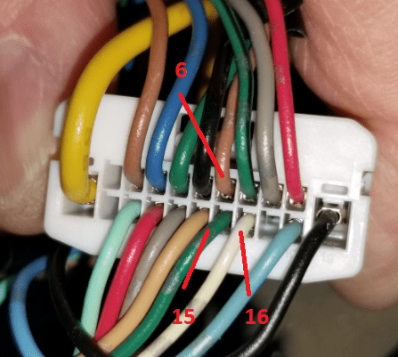

Jerry at Axxess sent me the photo so I knew what wires to tap into
Has anyone installed in this vehicle before? Anything surprising?
I have already pulled the head unit out and sent pics to axxess to make sure on the 40pin. Jerry mentioned he has seen 3 different 40pin configurations on this year Frontier.

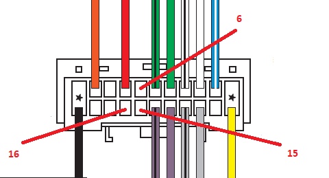

Well I got a Axxess AX-NIS40SWC wiring harness. And thanks to Jerry Ferguson at Axxess its gonna be a simple plug and play

On this wiring where the yellow line is at, that should be grounded. Where the red line is at is where the ground from the RCA should go.

On the steering wheel controls I will want the black wire of the ASWC1 and Pin 15 grounded. Pin 6 will be the green/blue wire from the ASWC1. Pin 16 will be the grey/red wire from the ASWC1
