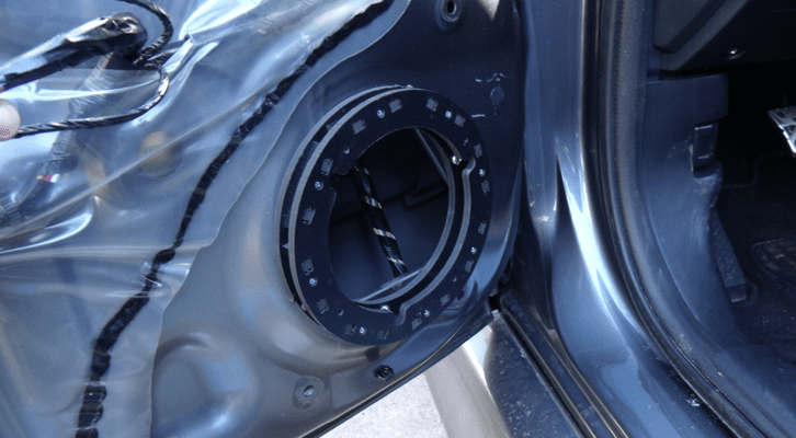

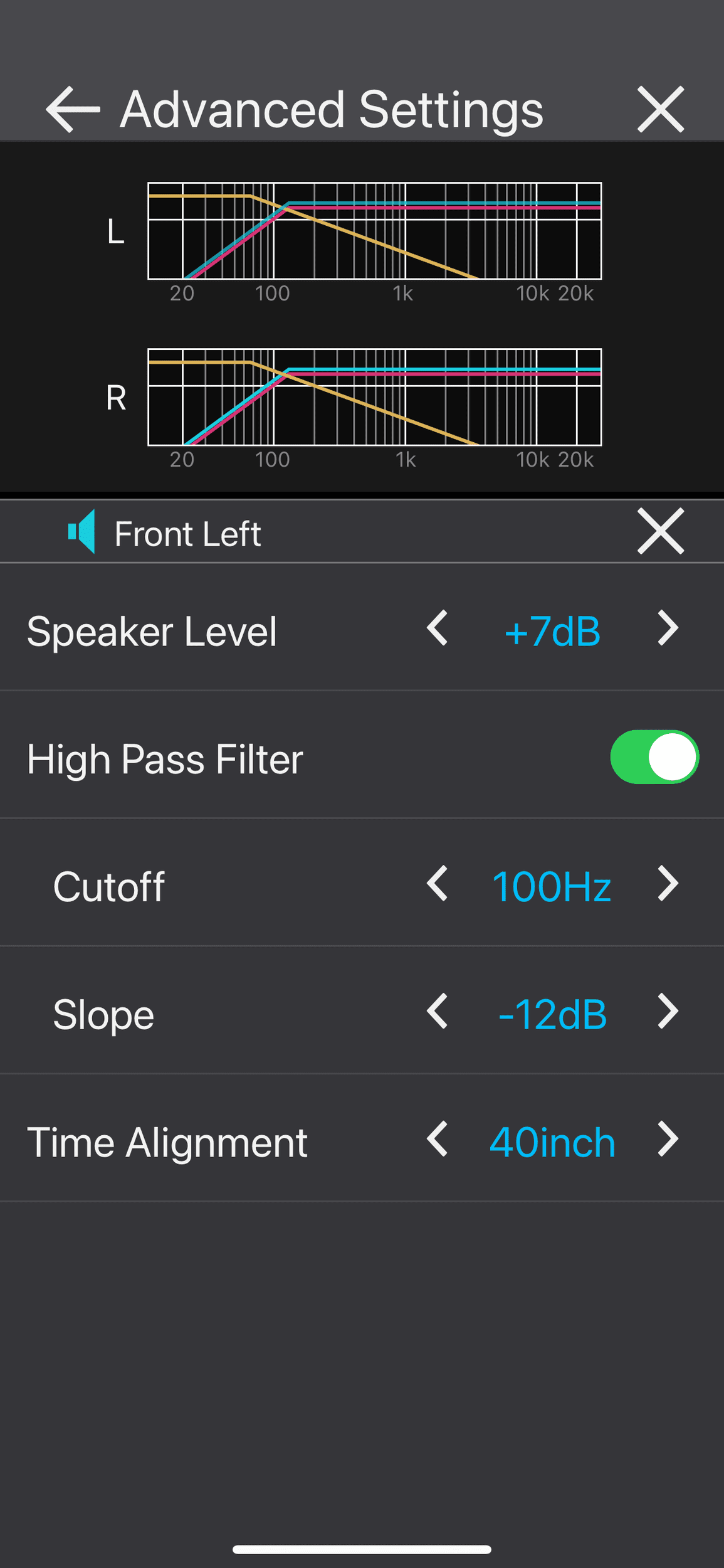

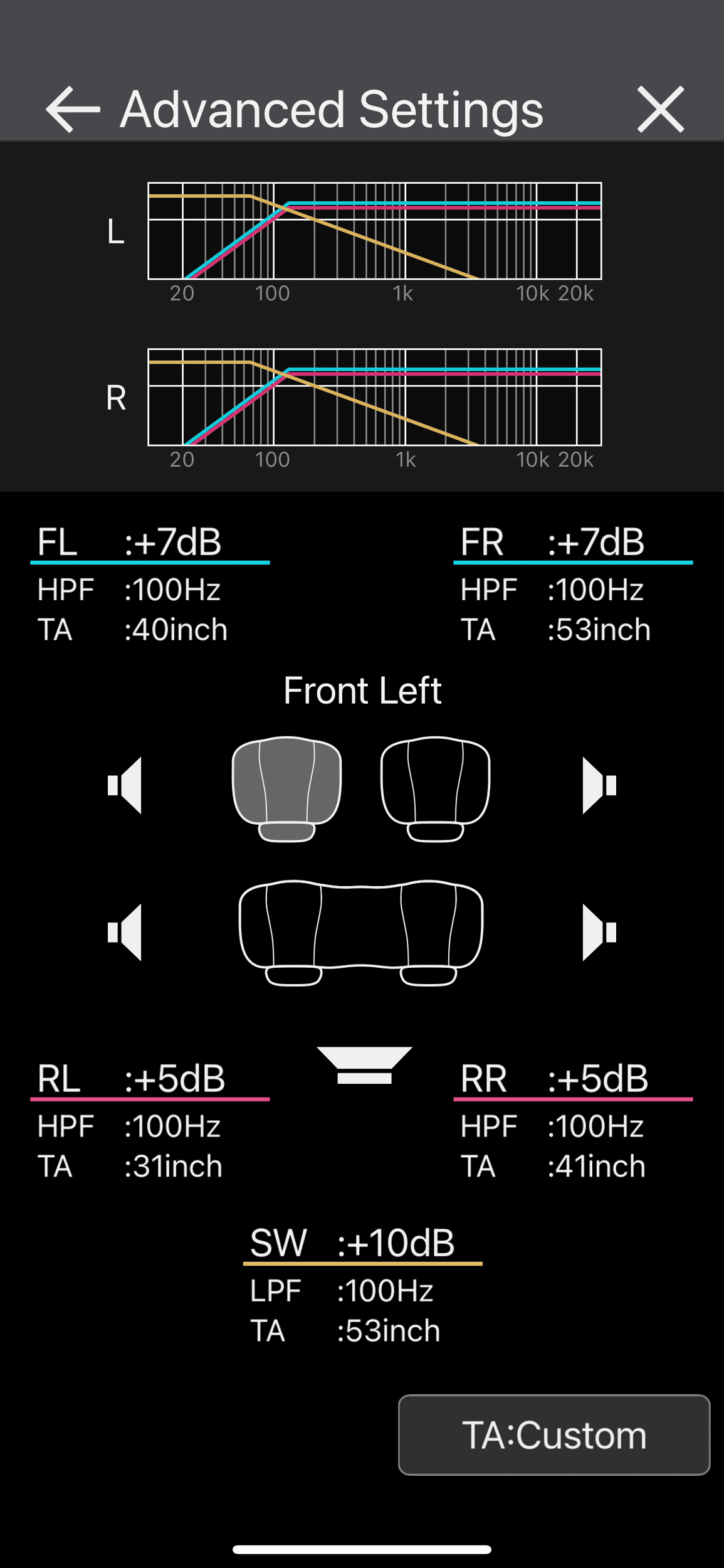

I’ll try and get some pics this weekend. But I finished the amps and sub install. Waiting on some new speaker adapters for the doors before I do the sound deadening. I tried tuning using usb with tones downloaded from Rockford. But it must be bad. I couldn’t get the gains set worth a damn. So I gave up last night and went out this morning and used Bluetooth with a tone generator thru my phone. All of the gains set almost identical. And it sounds great.
Those Sound Ordnance 6.5 components came alive with some good clean power.
I have it tuned for a max volume of 51 without distortion. I can’t go over 31 for my taste. But I’m old. lol
I’ll try and get a video up tomorrow

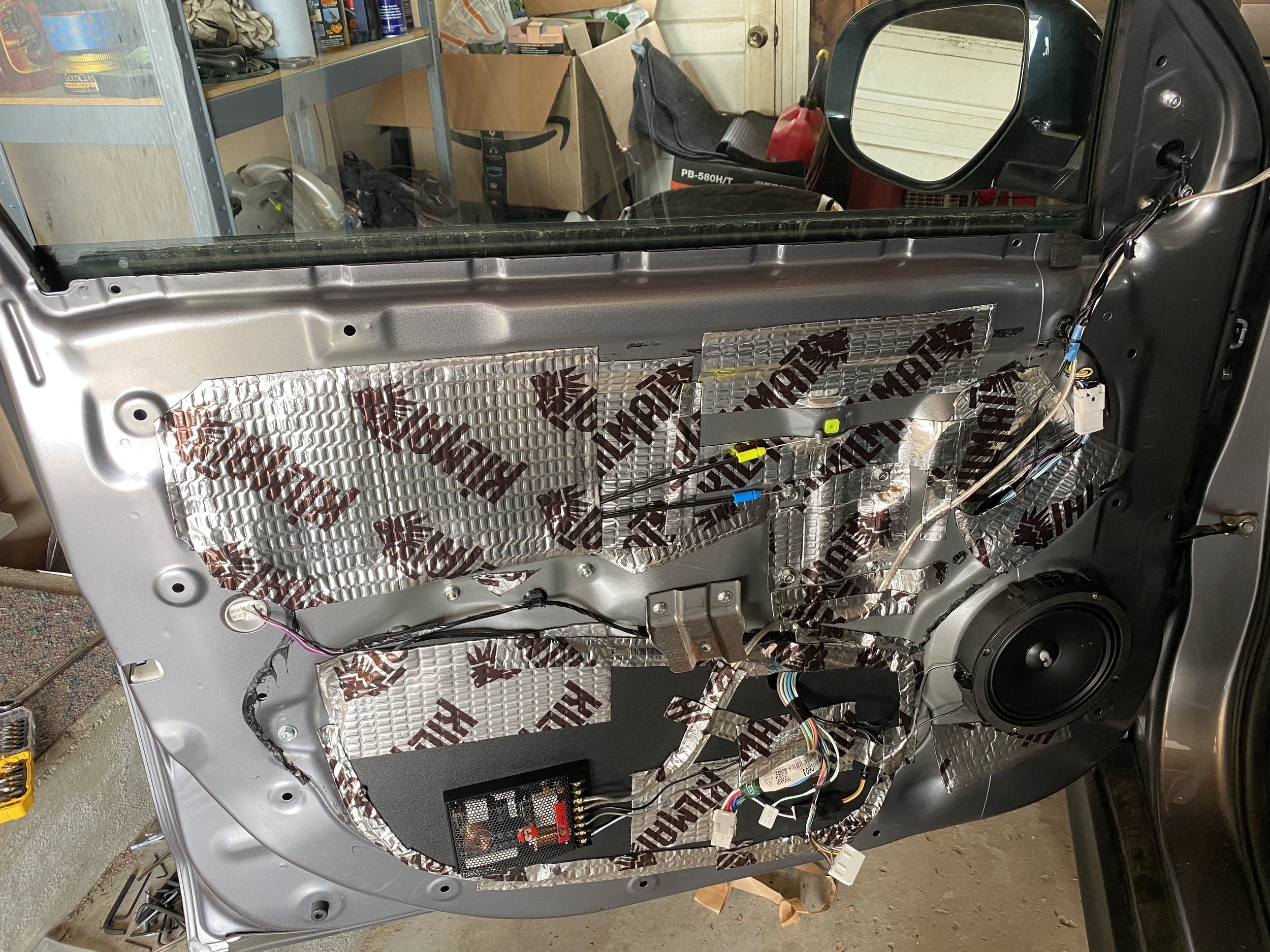

Gotta finish this weekend. I have 2 sheets of blown PVC to cover the holes in the doors. Then get all my sound deadening done. Finally get my CDT mids and tweeters installed. I'll get pics up once I am done this weekend. Gonna try and get it done early in the mornings. Gonna be another hot *** weekend.
