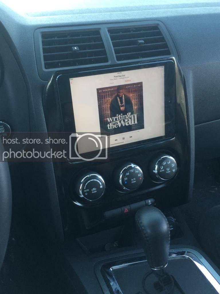

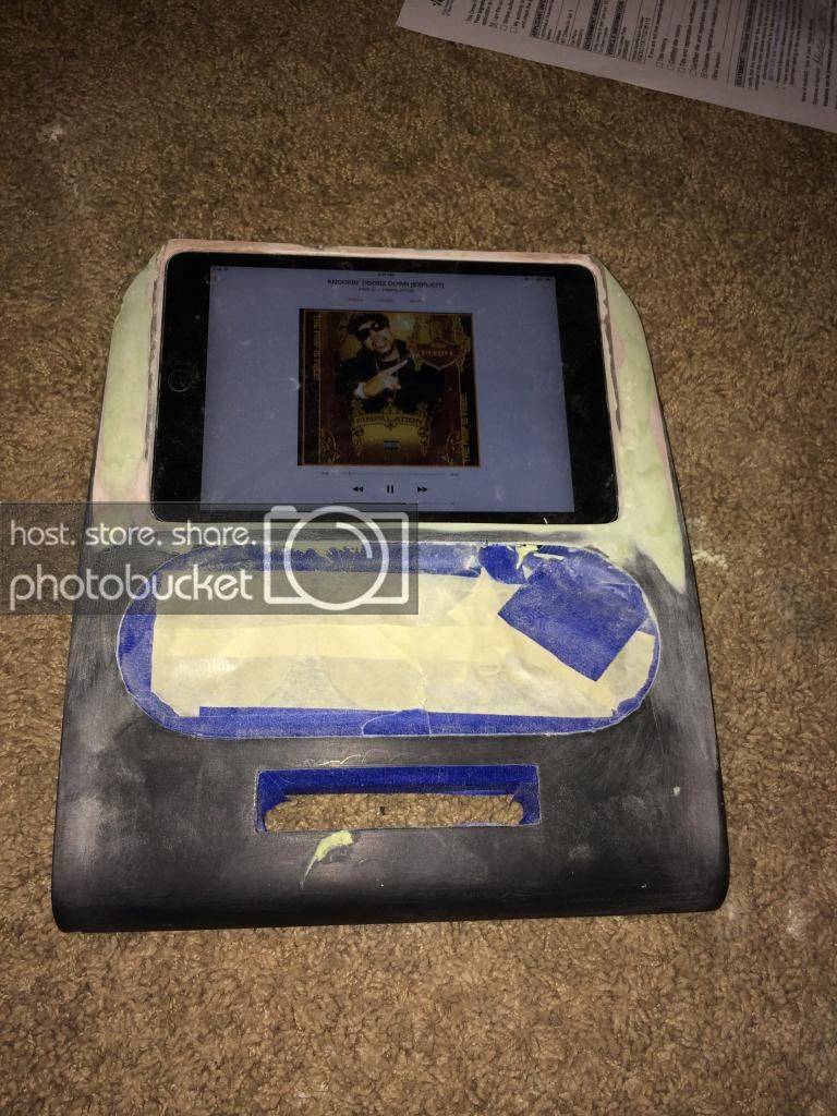

dash build of 2014 Challenger. done for someone i work with, after seeing my dash he wanted me to see if putting an ipad mini was possible (since there are very few pics of any challenger ipad mini dashes)

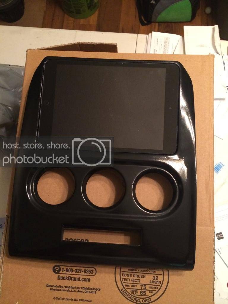

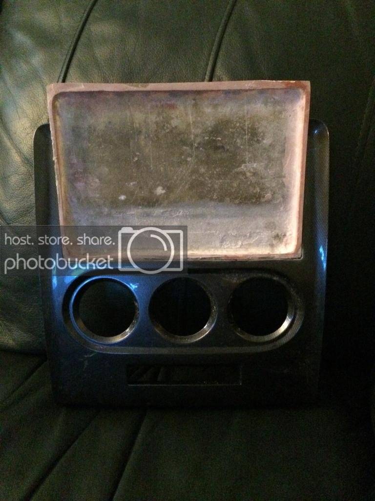

1. a mold was made and it was the ipad was not going to fit in flush and it extended height wise, but it fit in there width wise after some shaping.

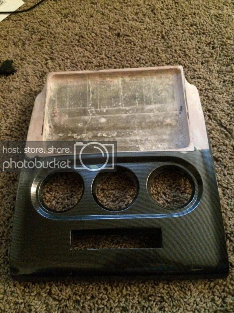

2. after was glued in place and so some body filler was put in and it was sanded to make it look transitioned.

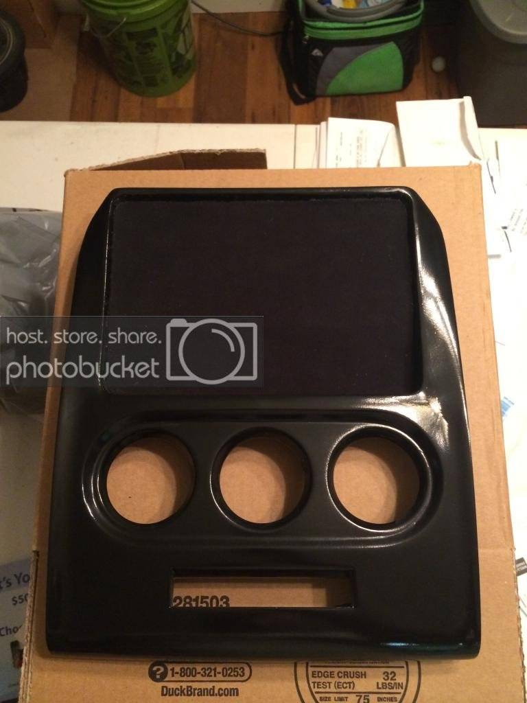

3. some more body filler and sanding and it was taking shape. the dash had a nice carbon fiber look to it that was from stock, i had to sand it all off and smooth it out.

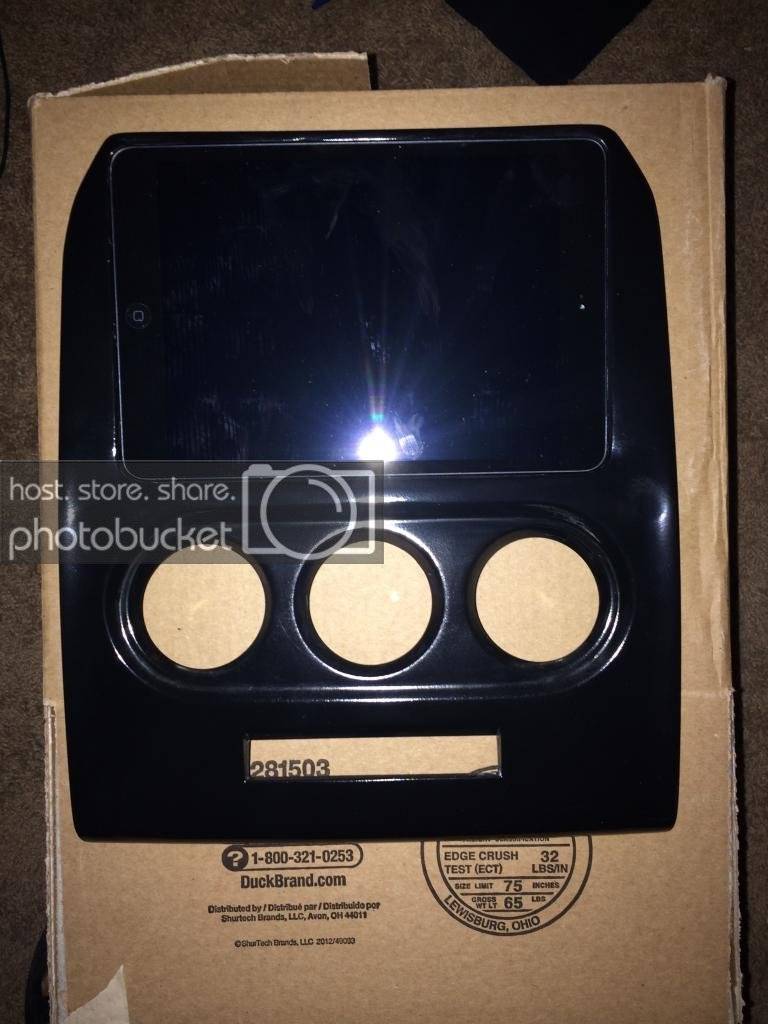

4. painting it a gloss black and this was the final result
