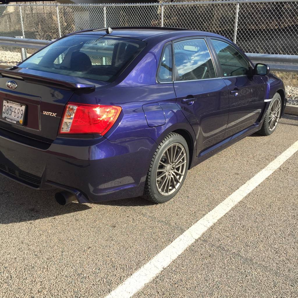

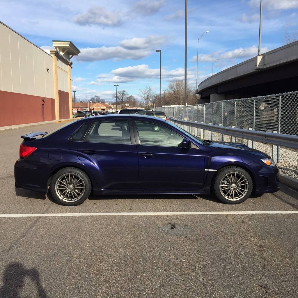

2013 WRX SQ ish build

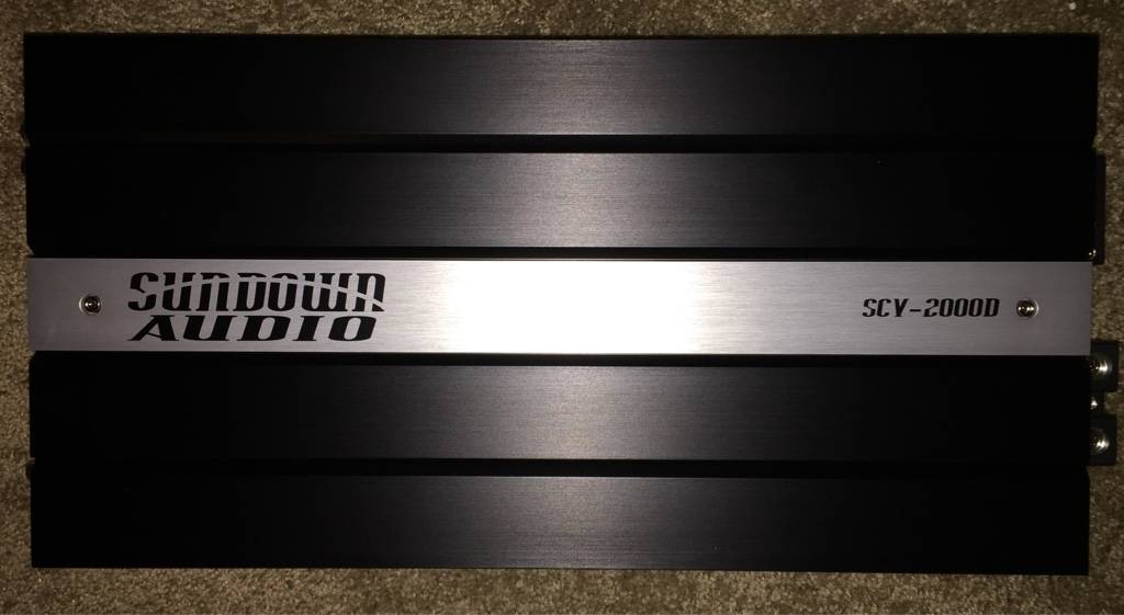

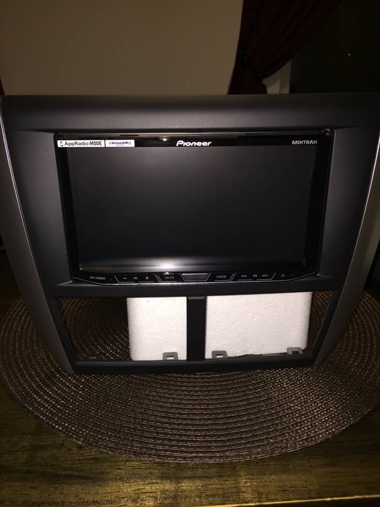

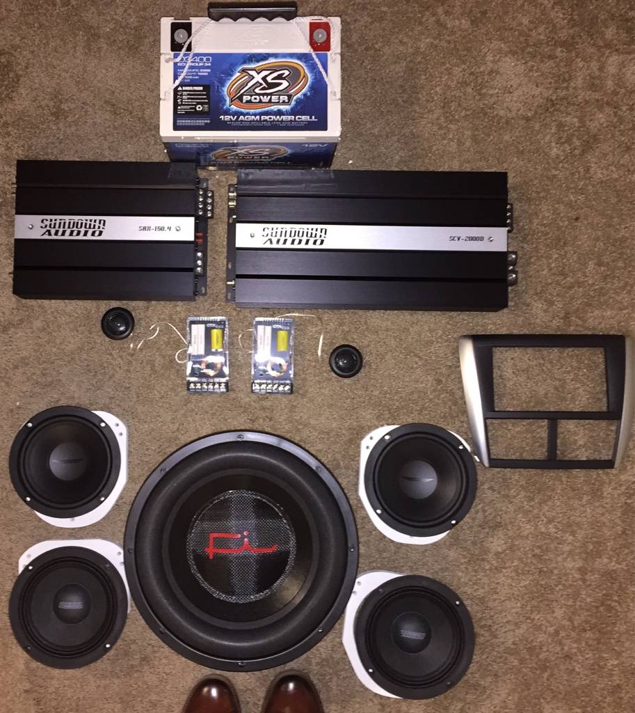

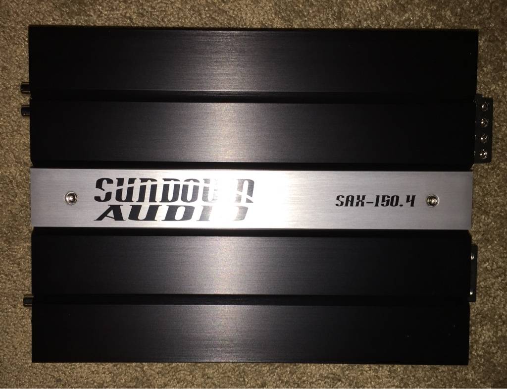

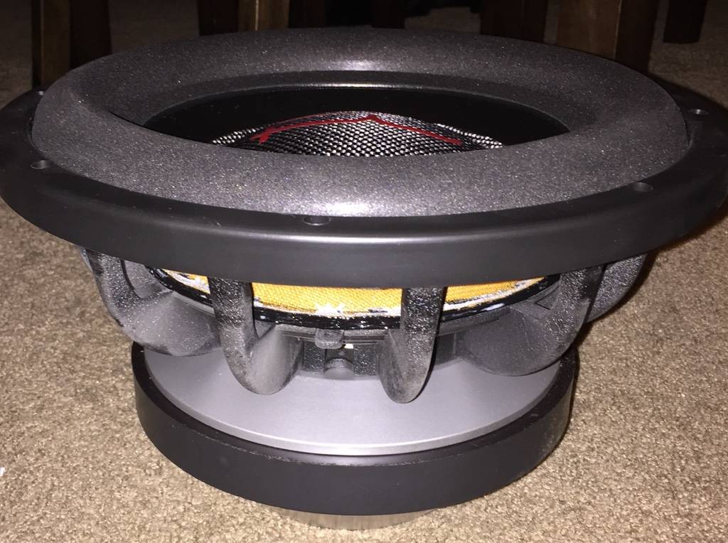

Here is my equipment that I either have or is on order going in a 2013 Blue Plasma Pearl Subaru WRX.
Front stage:
- HU: Pioneer AVH-4000NEX
- HU harness/adapter/AWSC-1 (ae64.com)
- JDM radio bezel

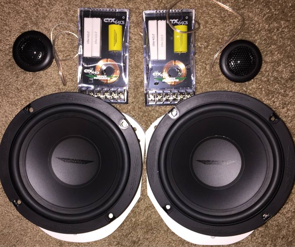

- Custom speaker mounting brackets (subaruaudio.net)
- Amp: Sundown SAX-150.4
- Components: Image Dynamics CTX65SC (100w rms)

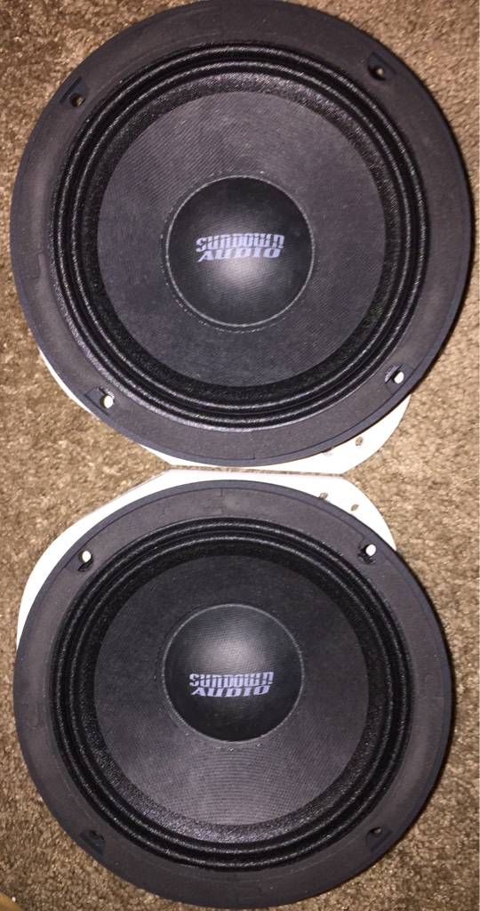

- Mids: Sundown Neo Pro V2 6.5" (150w rms)
Sub stage:
- Amp: Sundown SCV-2000d
- Sub: Fi Q 12" loaded (1800w rms)
- Custom ported box flush with trunk (2.5 net cuft, 40sqin port, 31hz)

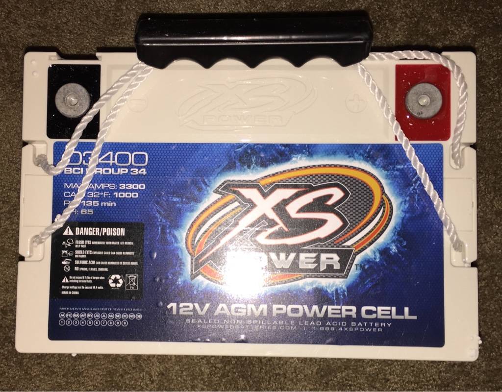

Electrical:
- DCPower 250a h/o alt
- Front battery: XSPower D3400
- Trunk battery XSPower XP950
- Big 3 (KnuKonceptz 1/0g)
- Knu 1/0g,
- Knu knf23 dist. blocks
- Knu Krystal RCA's
- Knu 16g speaker wire
- Knu 10g sub speaker wire
- Knu terminals, etc
Misc:
- Knu 100 mil deadening 65sqft (doors, and trunk)
- Shrink wrap, wire loom/flex
Equipment looks great! Tell me how the neo-pro's are, as I plan to get some soon
Thanks man! I did some research and bought within my budget but I think I landed on a good well rounded setup and most of all focused on clean power.
I will let you know how the Neo Pro's are just give me a bit to get it all installed currently my car is being fixed from a hit and run.
I chose the Neo Pro's because they are oriented toward delivering punchy mid bass in car doors specifically and will makeup for what most normal components especially when mounted in car doors lack.
