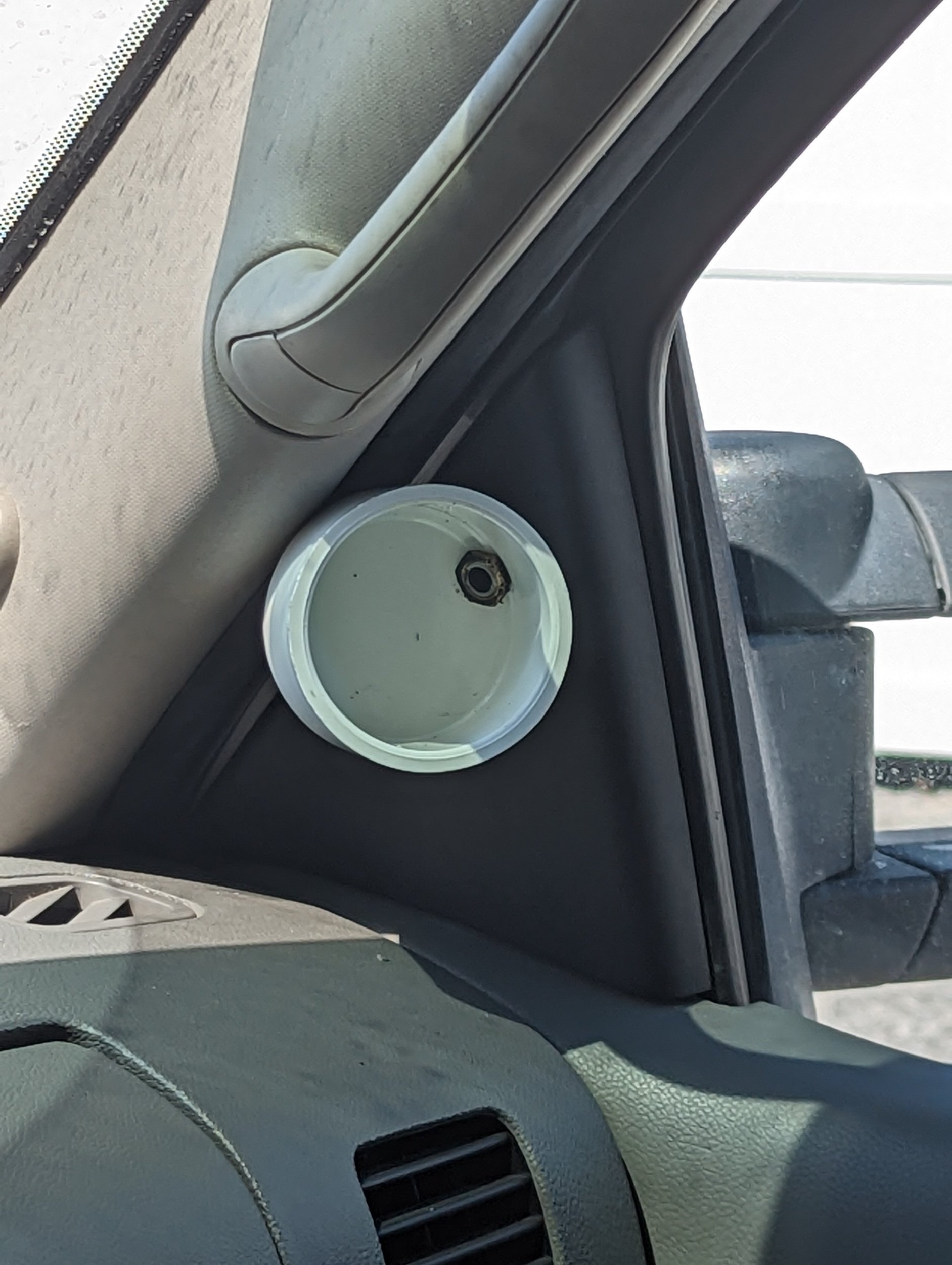

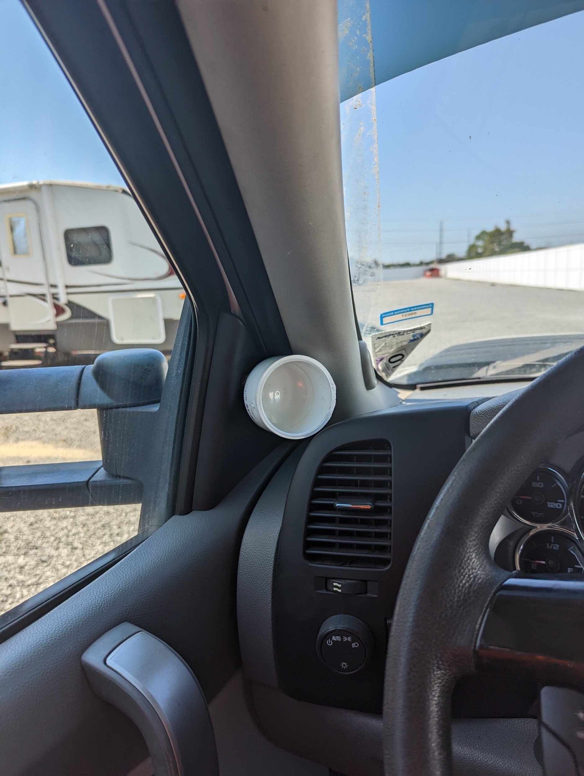

Started on some temporary pods for the tweeters. I've been dealing with failing tweeters for 4-5months so quick pods will. Do for the short term. Gonna order custom machines ones later. These still need to be painted, wired and the tweeters installed. That should be by the end of the week once the tweeters get here.
View attachment 43468View attachment 43469
Ive got a 2014 Chevrolet 2500 HD LT 6.0 LS in it 4dr long bed truck that I still have all stock HU ect in it. I use for a work truck. I plan to retire it next year, and do an install in it. I appreciate the build log and would do a log on it when I get the time. I think i have plenty of gear to choose from. Ill need to locate a DD HU that meets my needs for it. I can contest to the Road Noise that you have taken care of and plan to do the same. I have yet to pull any door panel as of yet. Id ask of how much depth do you actually have or room for the door speakers/ Clearance? I have another set of CDT HD Euro Sport 6.5s Id like to use or Image Dynamic CXS 64 v2 components. I like the tweeter location chosen as well. I am thinking of Pods for those as well, to inter-change from time to time.
