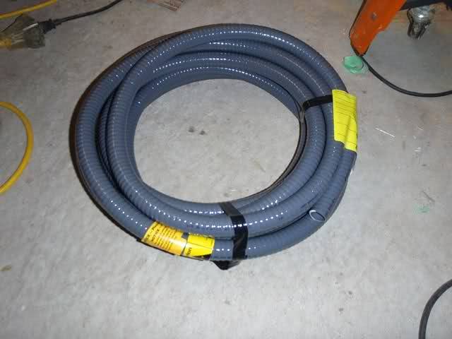

Today's mission, install conduit for power cable. There is plenty of room underneath, so I plan to take full advantage of it. Carflex Liquidtight is awesome for running wires externally, however, its wicked to work with in the cold. It will snap like an twig if you're not careful. I know we won't get many more mild days, so today is the day for this stuff.

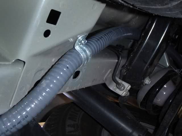

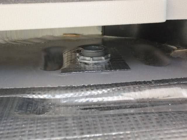

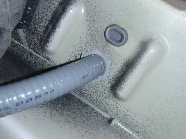

Got the conduit install done, just in time as it's supposed to get pretty dang cold tomorrow. Not the easiest of vehicles to run, but its in and its free and clear of anything I'd be concerned about.
Use the metal clamps, not plastic ones. Stainless screws and spray a little Krown rust proofing in the drilled holes.
Bottoms up. This is the left rear corner, behind the wheel.
Where do you get that conduit or whatever it's called?
Lowes or Home Depot would have it, though you want the stuff that's called Carflex Liquidtight. There are other brands and variations out there, but that's the one you want.

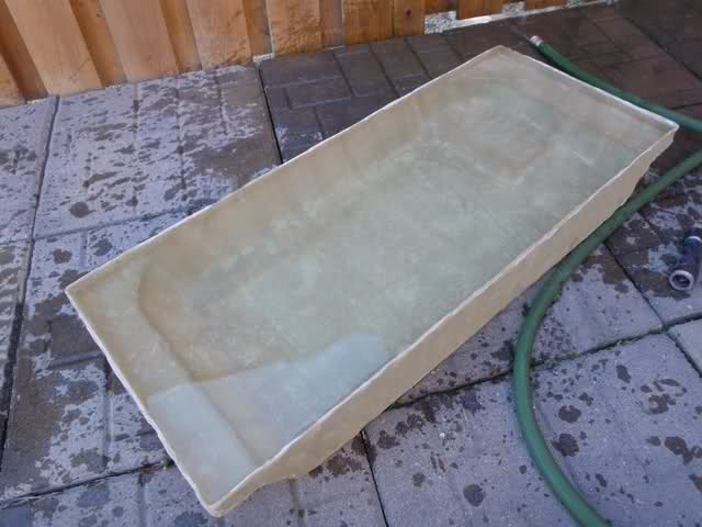

Been a busy last week, just haven't had time to spend on the install. Good news is the fiberglass sub mold is done and the volume is right on the money. By going with fiberglass and having the mold made to fit the spare tire well I gained a significant amount of volume and can keep my floor flat and not lose any width or depth in cargo space.
When the computer designed the mold, my pal gave me the volume numbers before he CNC'd the positive, I had to confirm the volume for myself. I won't doubt him again!
