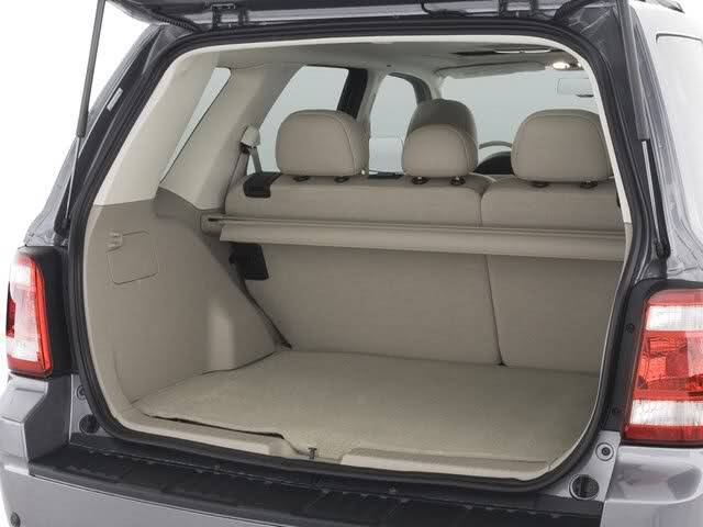

Speaking of what I'm up against, here's the factory dash and rear cargo area. This is what I have to work with.
Factory deck, no sub, no amps. I DO have the steering wheel controls (not shown)
Rear cargo area.

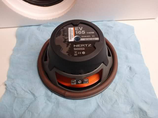

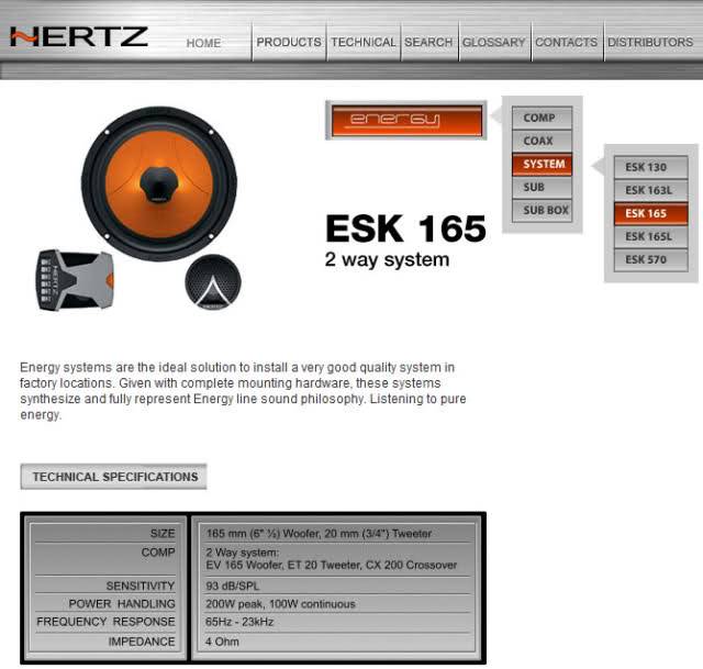

I picked up a set of Hertz component speakers (Energy series). The set includes a 6.5" driver and 1" tweeter, along with the corresponding cross-over. This is the first goal in the build, ditch the front cans.

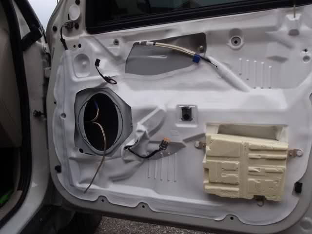

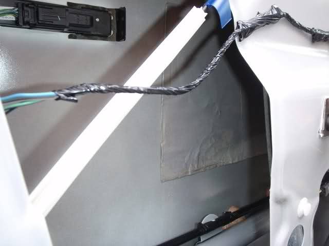

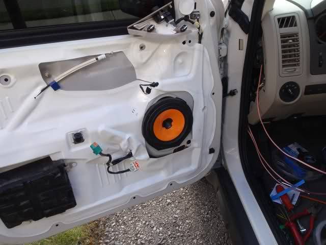

I didn't take a photo of the stock speakers, however, here is the void left from the speaker. Contrasting the stock hole is the outline of the 6.5" woofer. I also replaced the stock wiring, which is no easy task given the wire harness from door to body:
The inside of the door panel looks like such:

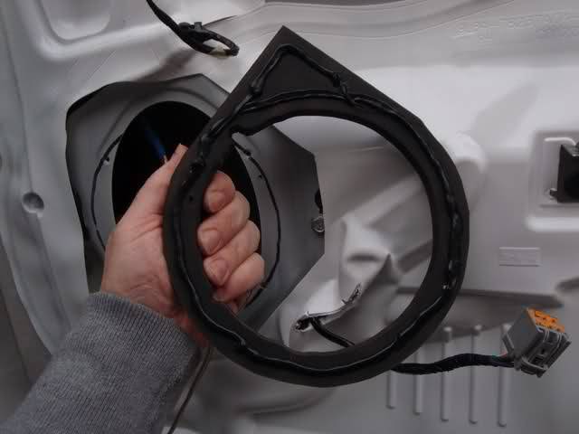

First order of business was to create a mounting ring. Cut, pre-drilled, and beaded with acoustic caulk:
I nice clean strip of high-density door seal and it's ready to mount:
A little bit of black spray paint to finish the MDF ring, mounted the speakers and voilà!:

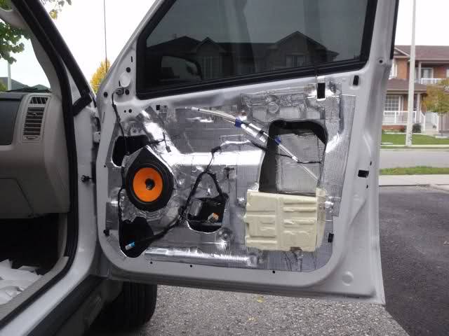

So while I poked away in the doors I noticed Ford installed 3 cents worth of foil covered tar in some kind of attempt to knock down the road noise:
I kind of expected as much so I ordered up some acoustic treatment from the good folks at B-Quiet. I'm not about plugging people for the sake of business, rather I mention the people who treat me (and hopefully others here) well. B-Quiet sent the stuff fast, included a nice roller and even called to make sure I got my order.
Install of that stuff to follow.

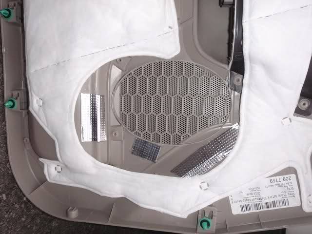

Got the doors done last night. Two layers of B-Quiet Extreme.
I also placed some B-Quiet on the door panel itself, particularly around the speaker area. Should give it a little more mass.

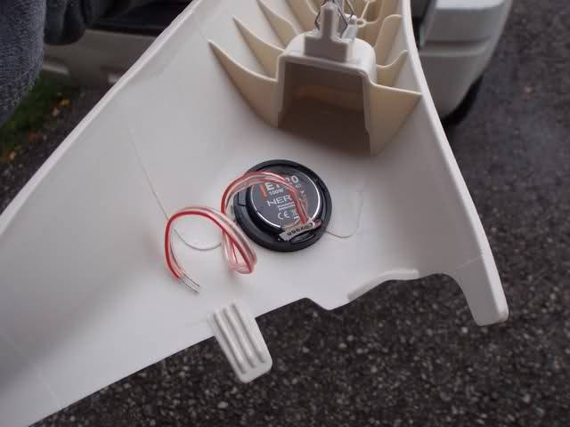

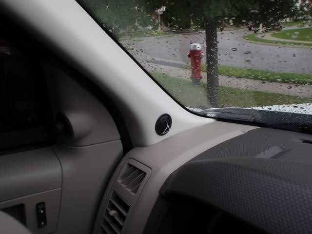

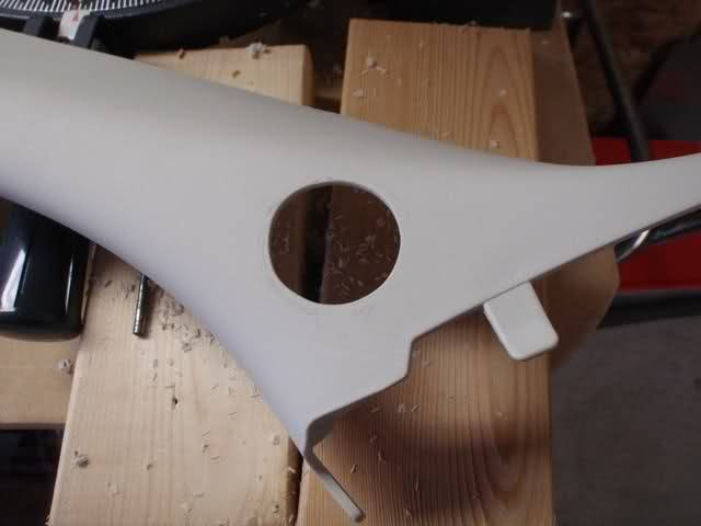

Next up, I decided to work on the tweeters in the lower A-pillar.
Drilled and touched up with the Dremel.
Tweeter in place. Only thing I did after this was add a couple spots of hot-glue to keep the tweeters in place, though they were already tight fitting.
The finished product.
