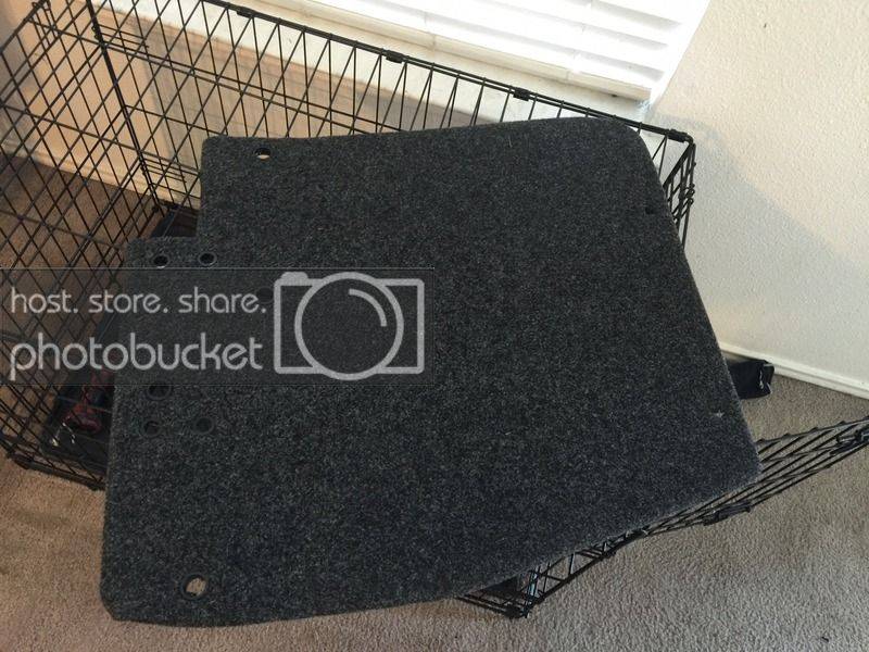

i would think about making a support for that floor mat board that is laying over the amps. i didnt, and now my chargers trunk floor board is cracked and sinking down right where your amps are at. there are indentations in the floor board where the box sits in that spot over the last 4 years ive had my box in the trunk. just a fyi. those things are pretty stiff out of the factory but after a few years they start to weaken .

Thanks I'll look into it!

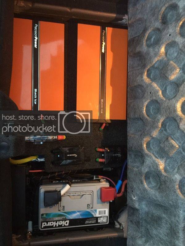

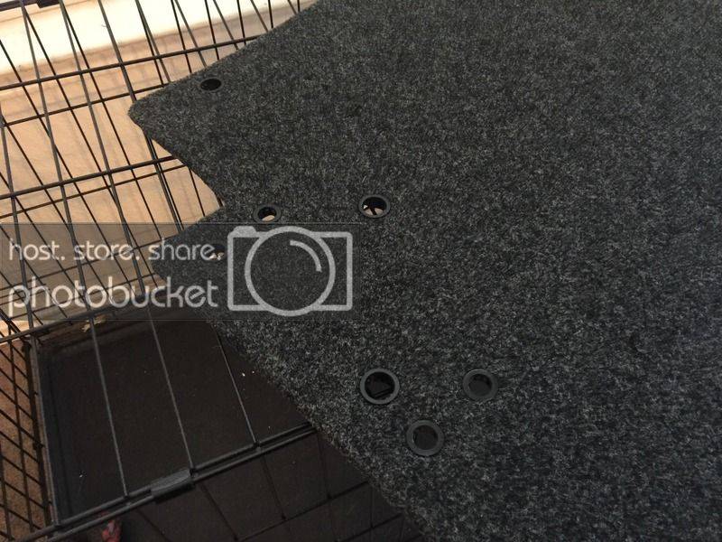

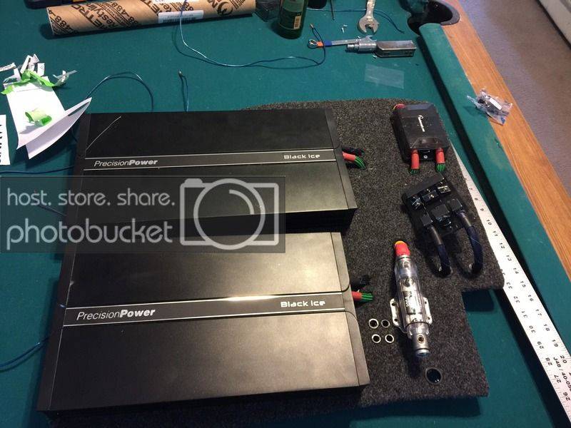

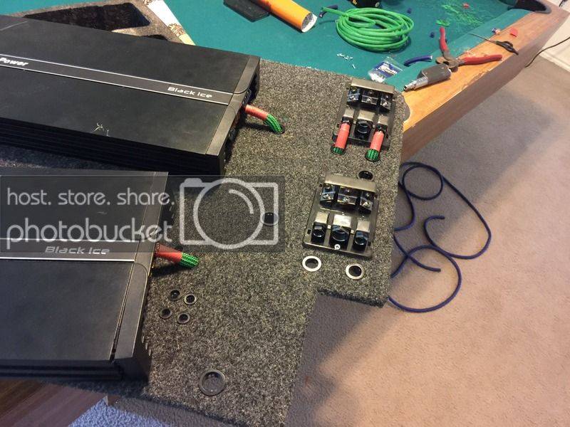

Weekend progress, started the amp rack. Only to find out I didnt have enough snap in grommets. There will be here soon. First thing I did was did the layout how I wanted it inside and drilled the holes for grommets.

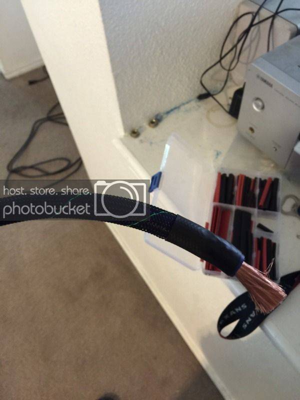

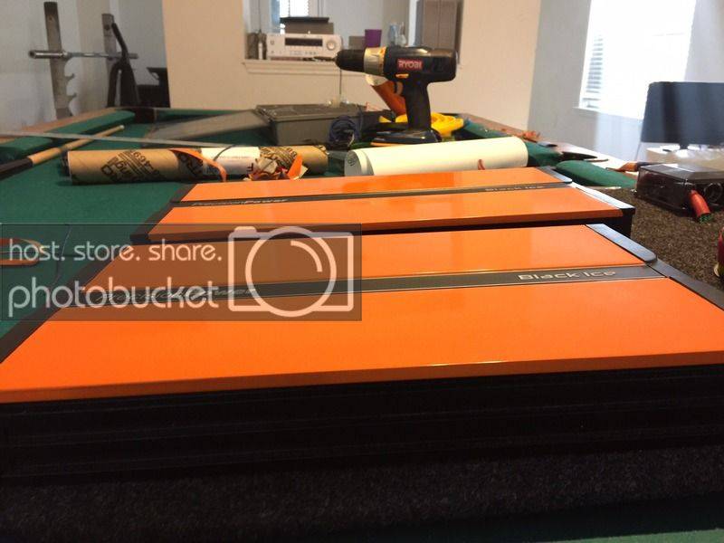

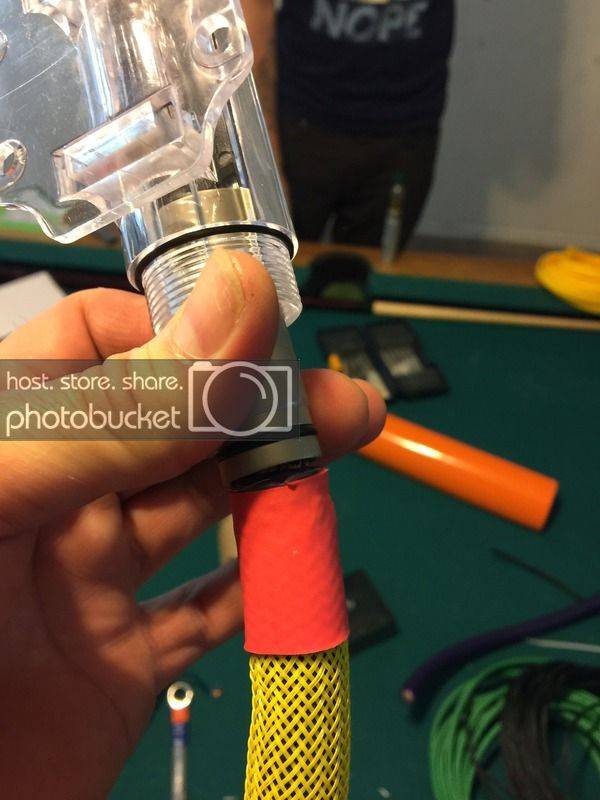

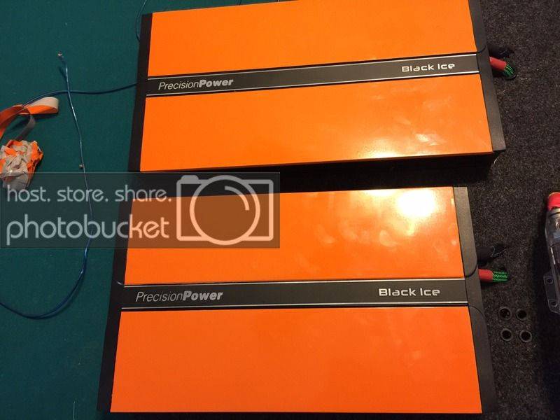

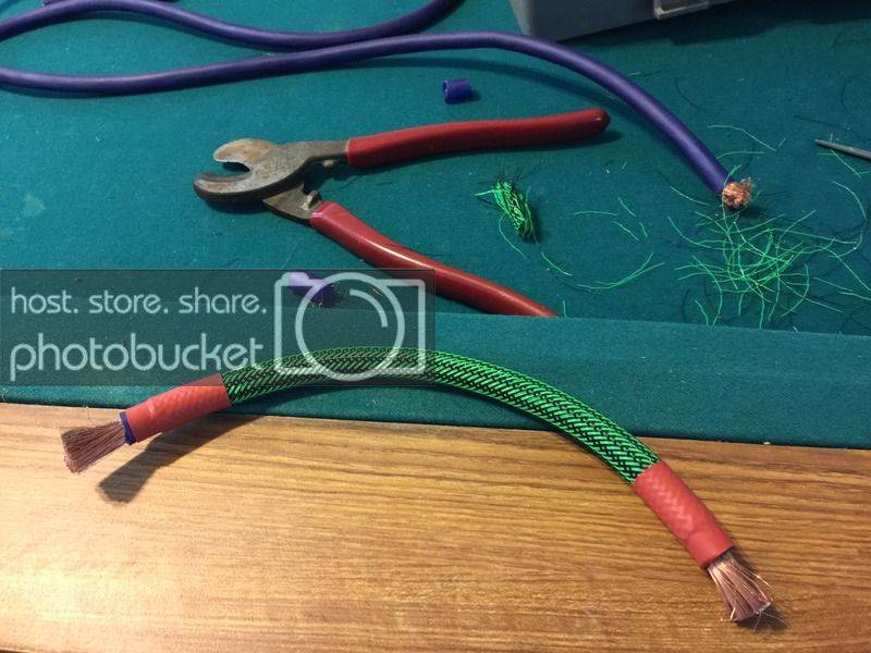

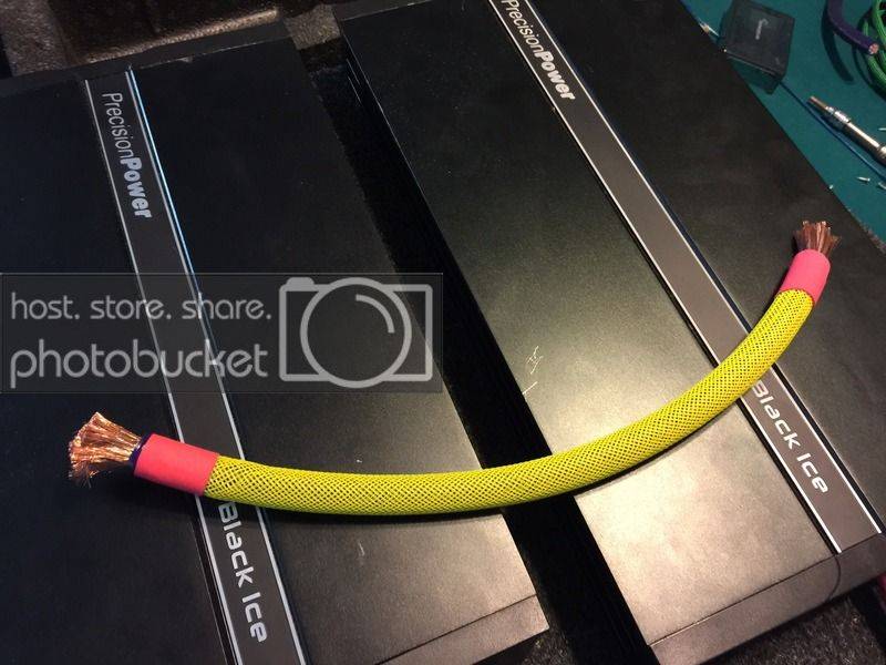

Even though I would be swapping out amps eventually , I didnt want to put alot of time and effort into this. However I wanted it to be simple and clean looking while I save money for the amps I want. So lots of techflex were used and knokonceptz as well. It turns out my amps were scratched from being on the couch, so I improvised and bought some 3m vinyl wrap. Its not an exact color but its close enough for me. Now for pics of the rack
Now to the 3m wrap, I highly recommend this. It is really to work with and get all the bubbles out. I was even able to cut it along the edges with my finger nail.
Test fit in my trunk
Still waiting on the rest of the grommets.
Will be working on my rear deck next, making baffles and deadening the crap out of it lol
