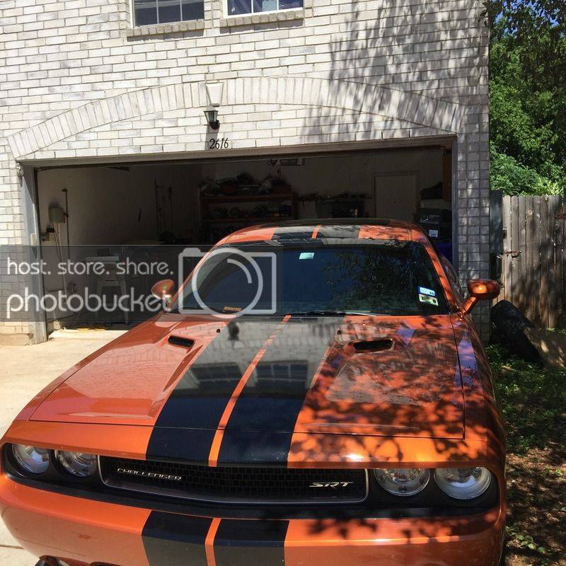

Hello everyone! Bought this car back in February and absolutely love it! However the stock kicker system is not cutting it. Some of the equipement will be temporary, some will be permanant and will also be adding in the near future. This is an ongoing build so I will update once a week what I have done in my little spare time from work and life.
Now some pics of the car....

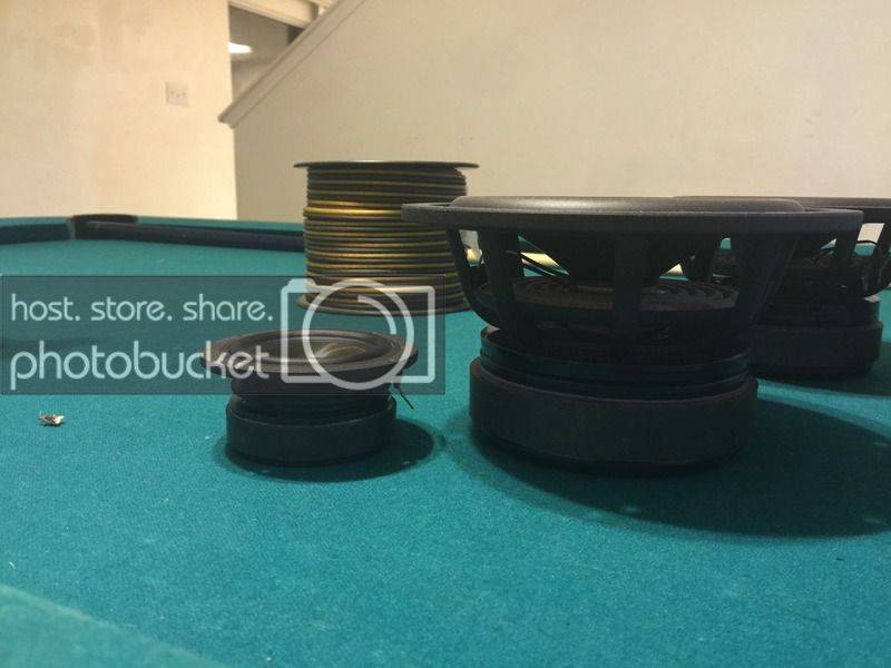

Subwoofer: 15" Exodus Audio Tempest x2 (xbl^2)

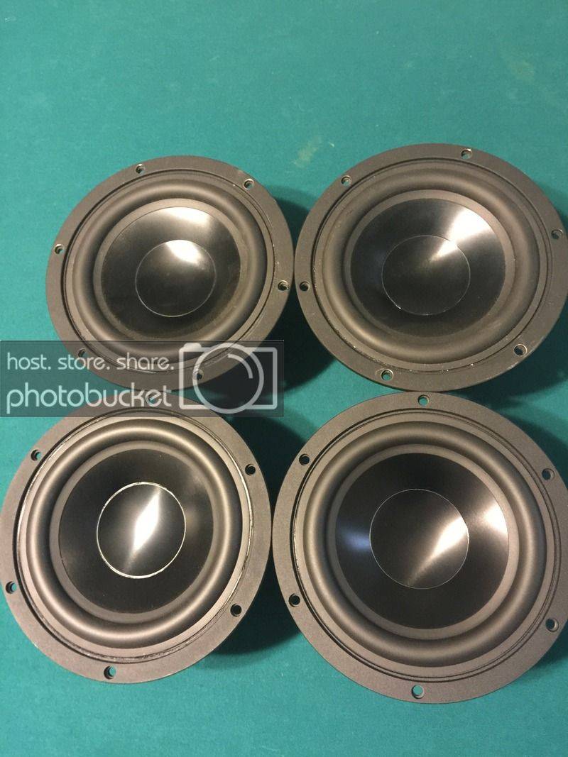

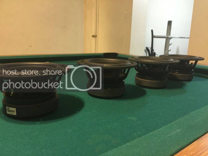

Midbass: 2 pairs of Exodus Anarchy's (xbl^2)

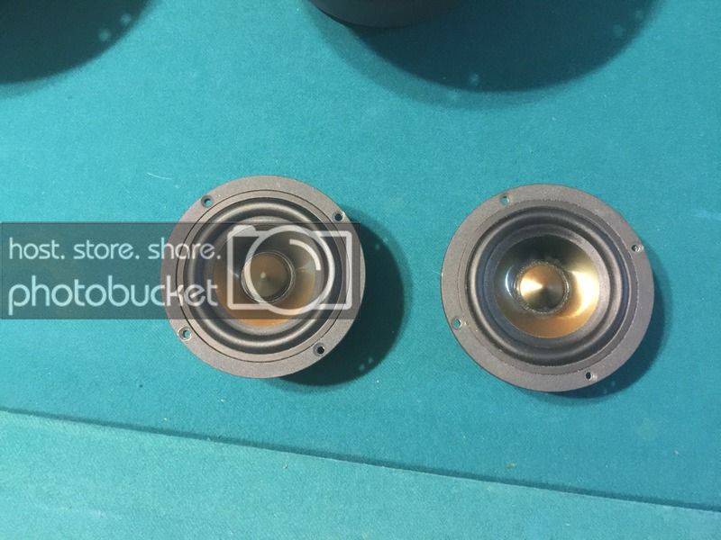

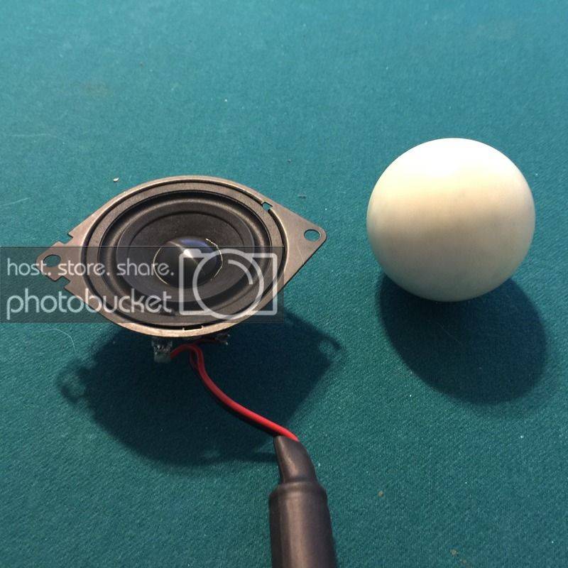

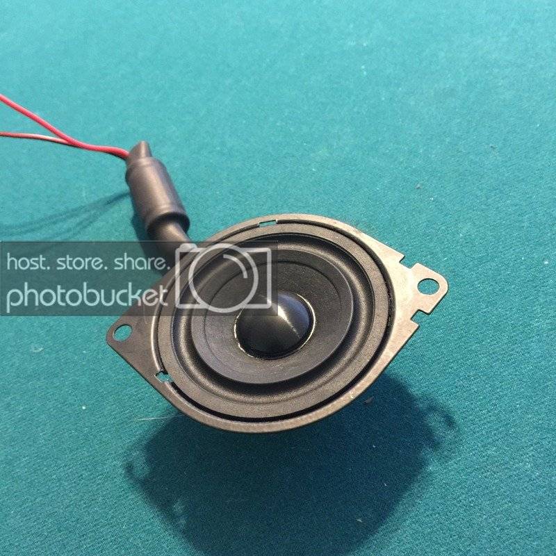

Midrange : Pair of Sundown 2.75FR Wideband speakers Going to attempt a tweeterless install because I do no how to fabricate . Maybe in the future one day.... Got these free from Jacob as long as I did a review.....http://www.caraudio.com/forums/subwoofer-speaker-reviews/614524-sundown-audio-sa-2-75fr-subjective-review.html
If these dont work out then I have a pair of 3" Audible Physics wideband speakers I will try.

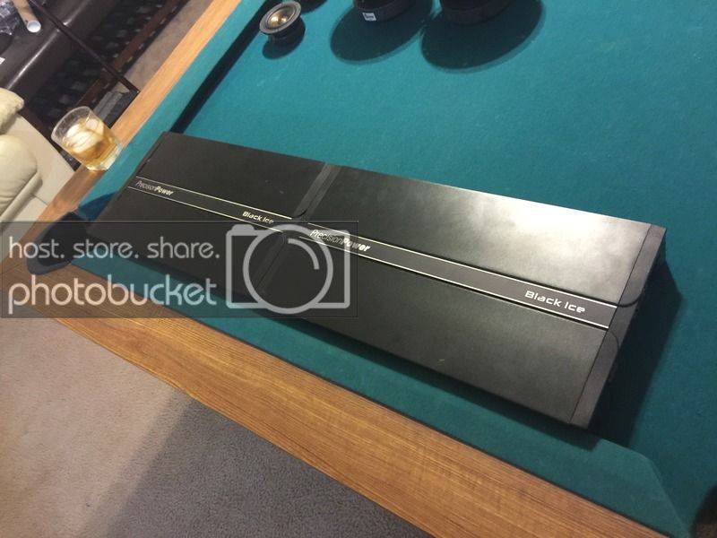

Amplifiers: PPI BA5000.1 and BA1600.4 , these are only temporary. Have my eye on some mosconi at the moment.

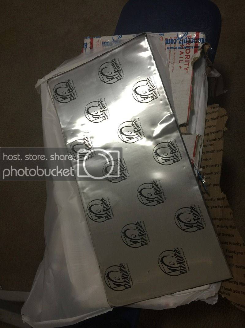

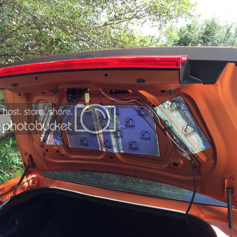

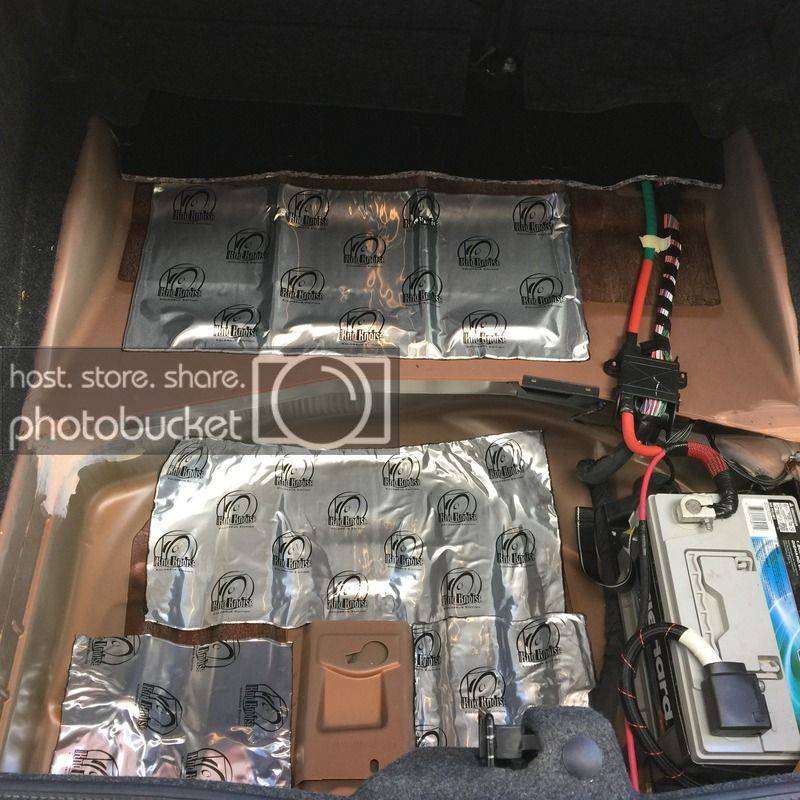

Deadening: Knukonceptz knu kollossus , MLV, and ensolite

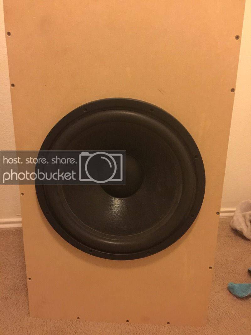

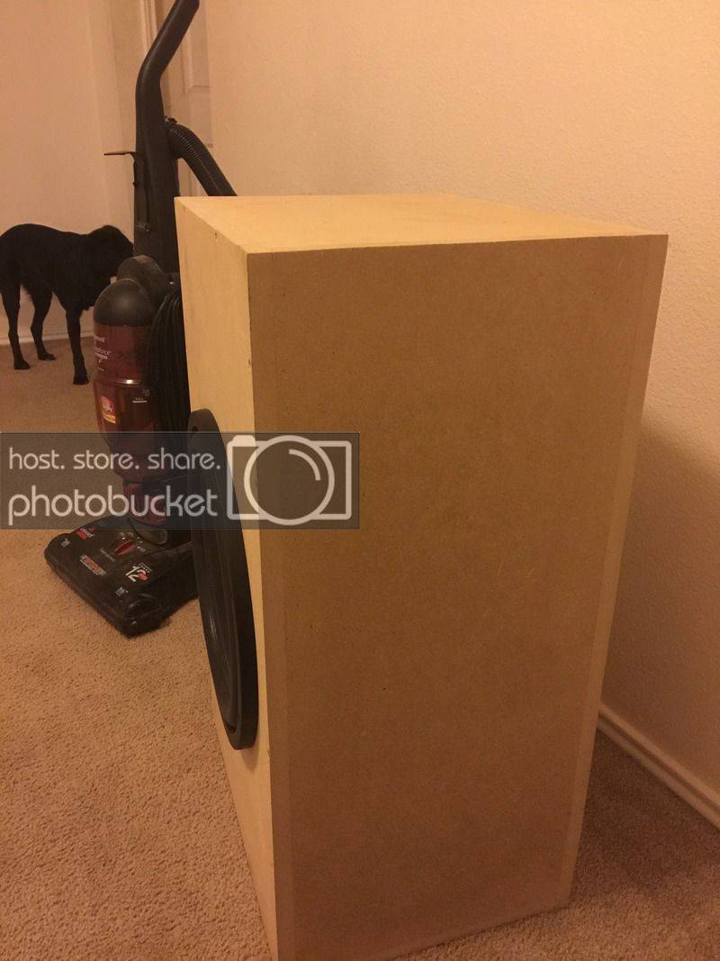

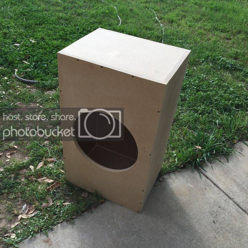

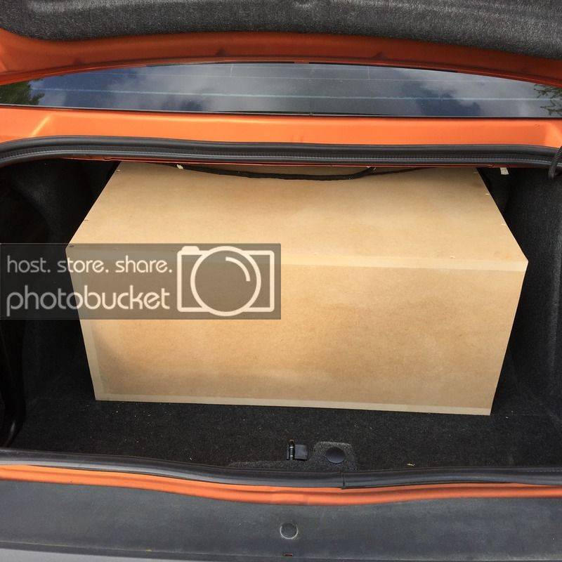

subbox 4.5 cb box sealed, I have built both. Currently have a ported one in my room 6 cubes tunes to 30 Hz, sounds phenominal! However I love this sub sealed, sounds so much more musical to me.
midbass duty

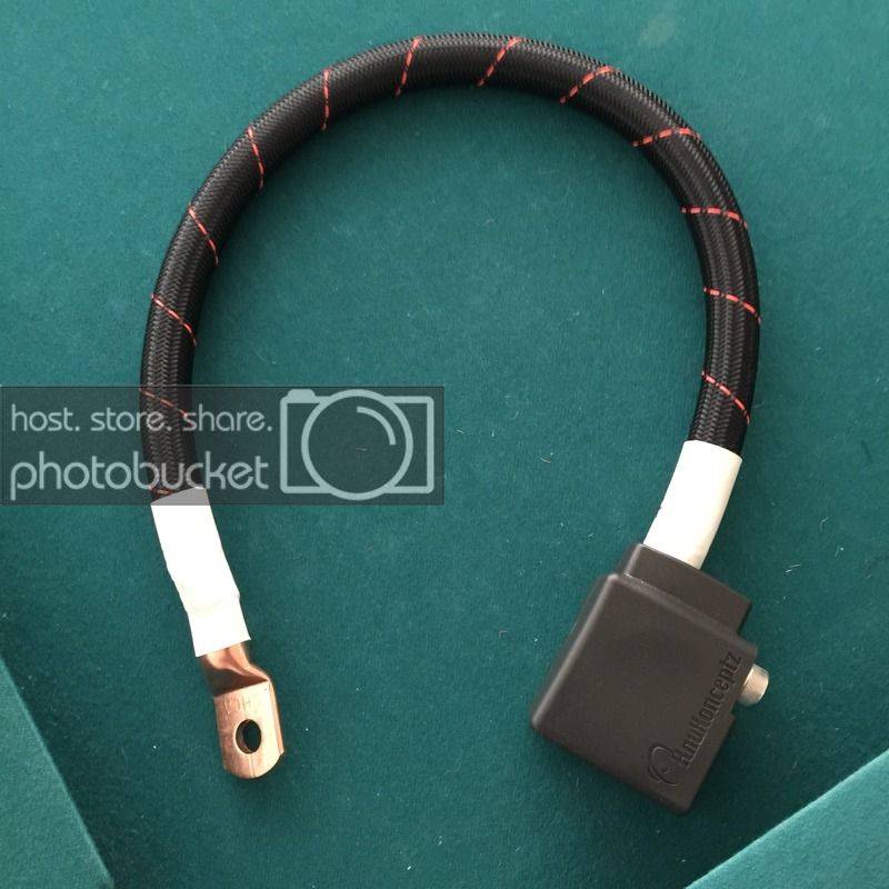

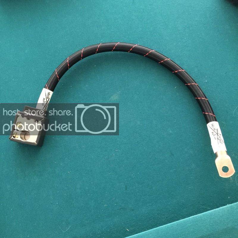

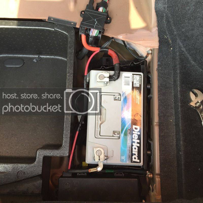

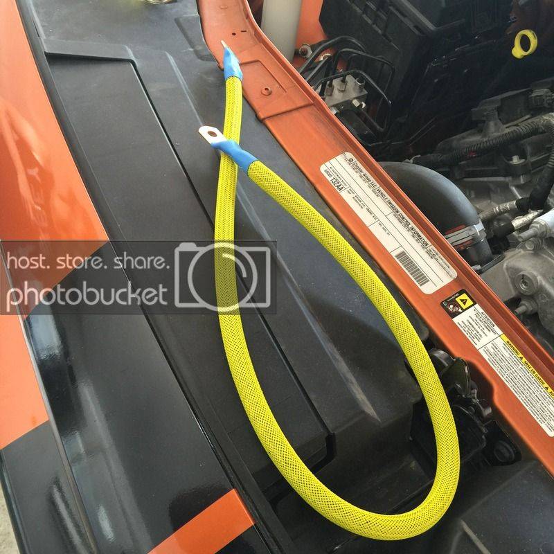

First up grade was the Battery, I bought some sweet knukonceptz battery terminals for them

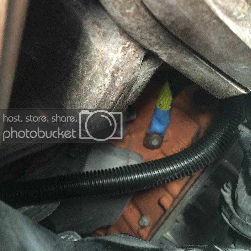

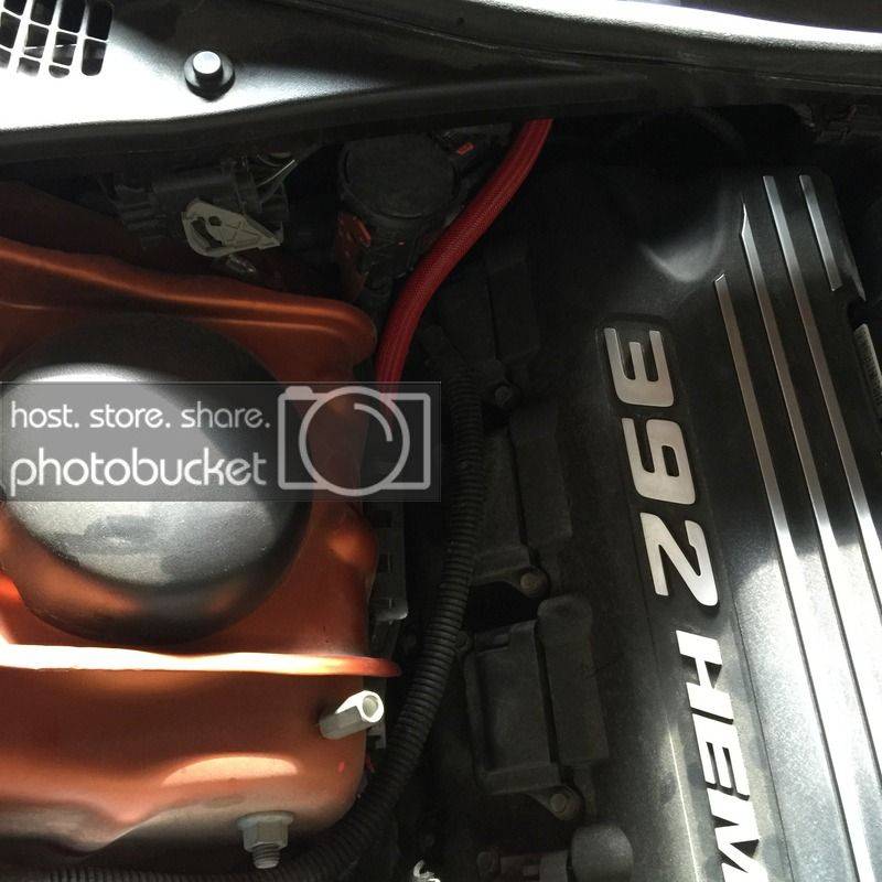

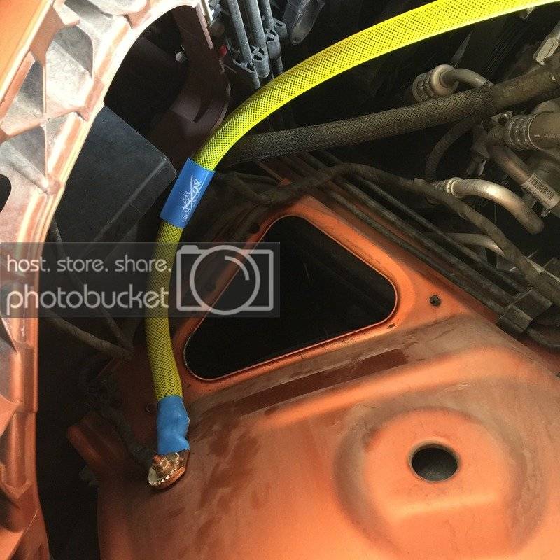

Next was the big 3

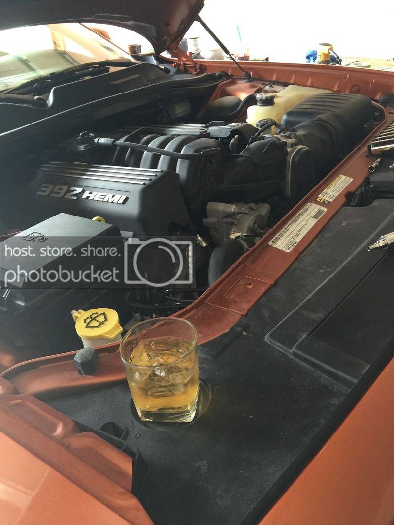

Engine bay came with cupholders lol
pos ran from alternator through firewall to the battery in the trunk

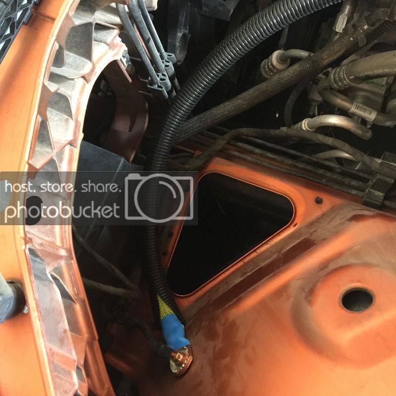

Engine chassis to engine block, took out the airbox and found a good spot on the chassis there and ran it to the bottom block on the driver side
bottom driver side block
(-) battery to ground

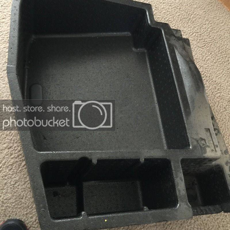

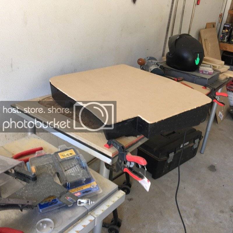

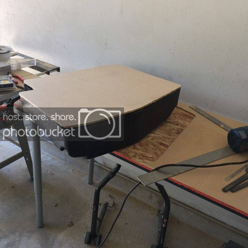

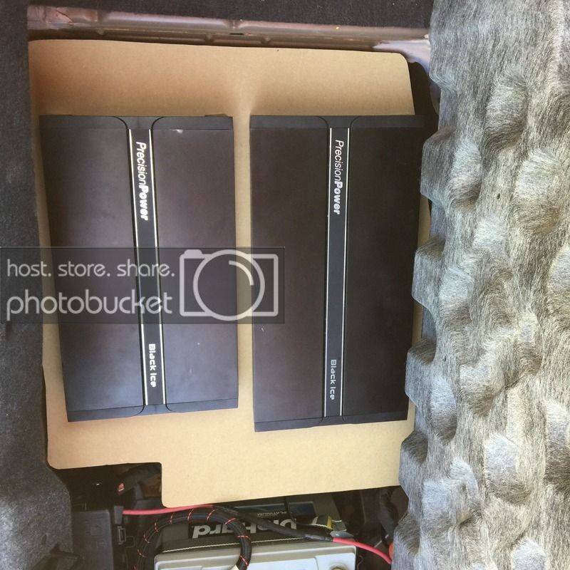

Now to the amp rack, I decided to use the oem styrofoam rack thats under the floorboard as my base. However I have to build this raco accordingly because I will be switching out the amps in the future. So heres a pic of what it came with

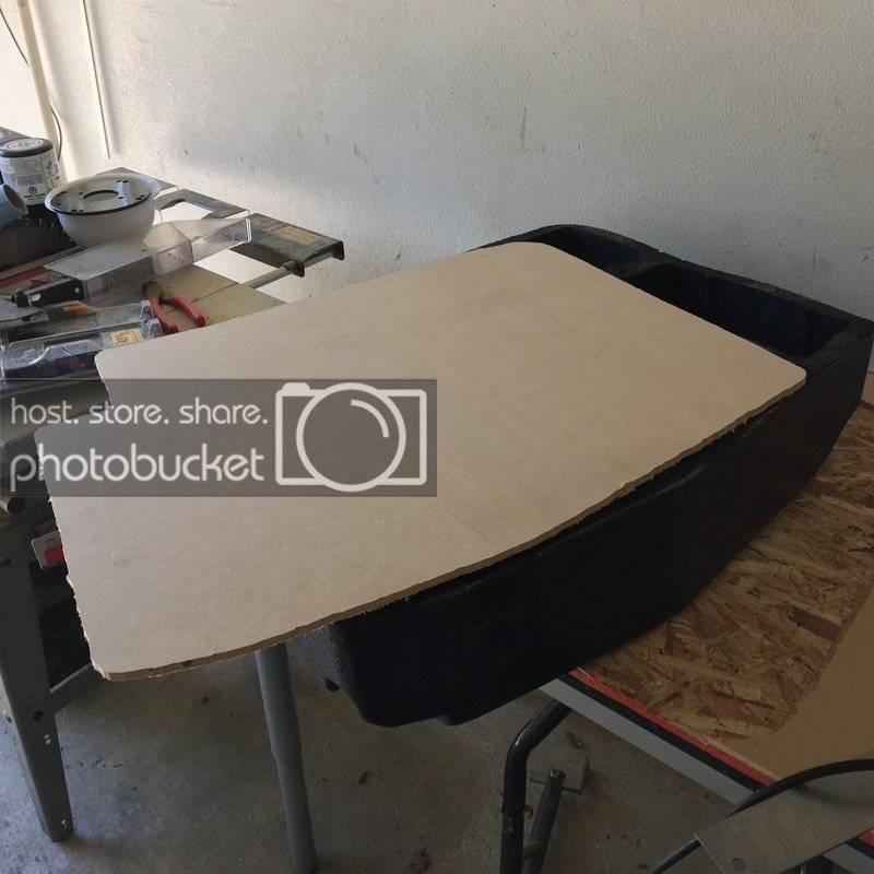

So what I did, Since the bottom of if fits snug and does not move inside, I chopped the height of it about 3 inches and used the outside as a template for an amp rack.
in case anyone is wondering I did smooth out the edges with my palm sander lol

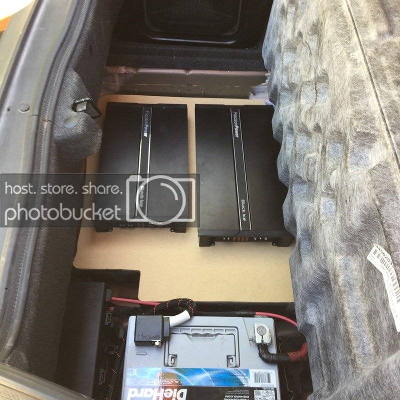

Then I placed the amps inside the trunk to figure out the layout
Thats pretty much it for now, Im waiting on two distro blocks and a fuse holder. Carpet came in the mail today. I will be drilling holes in the board using grommets for all the wire, so once the distro blocks come in I can finish the amp rack
