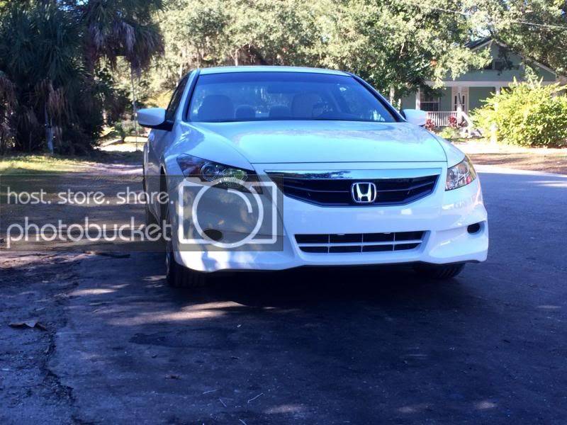

First thing was first, debadge.

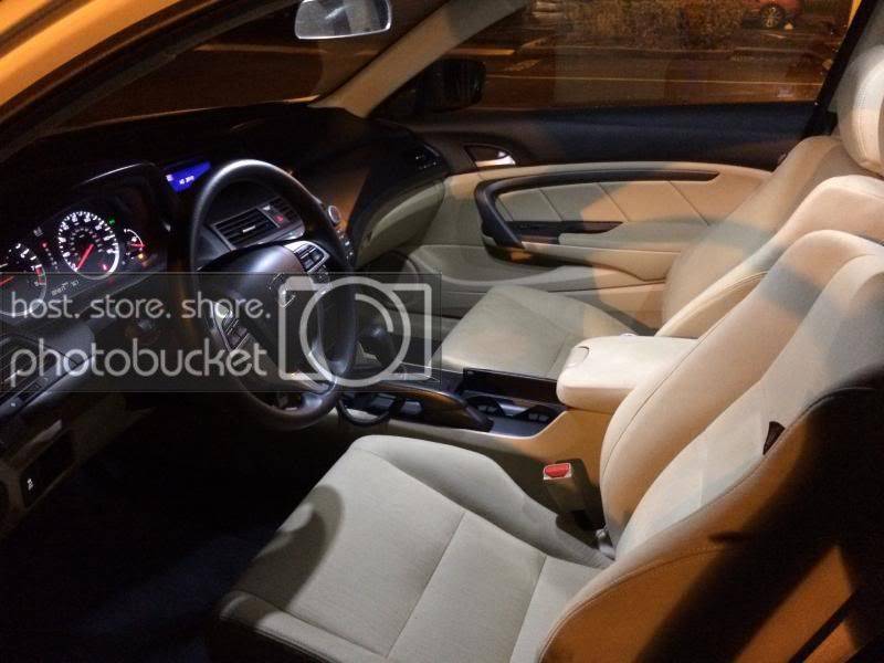

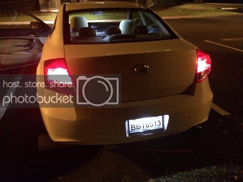

Then was the yellow DRL (daytime running lights) to give it something other than ugly halogen, and LEDs inside the car and for license plate to give it a bit better look.

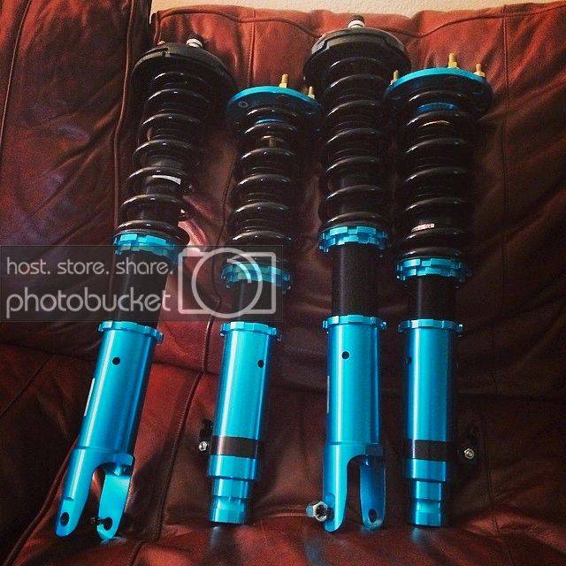

Next up was coilovers, Megan EZ Street..

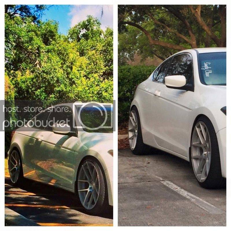

Then installed them on the stock wheels.. Before/After
Then came the rims. Avant Garde M510 20x10 +35 on 245/30

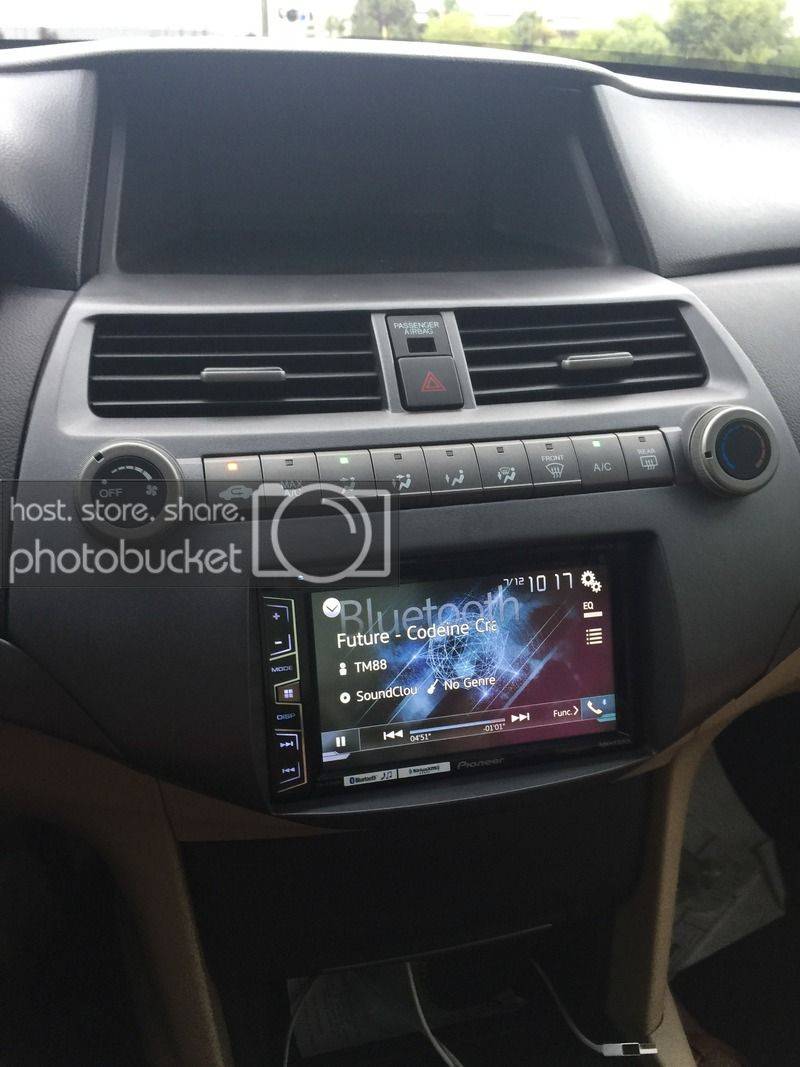

The Hifonics was overheating playing with the stock head unit bridged to the Crescendo CZ's. I cranked it up one day and it blew my crossover tweeter side, mids still played fine. My stock headunit was also cutting off frequencies below 40hz and was having HORRIBLE bass reproduction problems tapped into rear speakers. I gave in and bought a double din and ran it off 2 channels not bridged in mean time. Pioneer AVH-x2700bs, fixed most of bass reproduction and much cleaner sound with LC2i LOC, no more accubass was needed.
