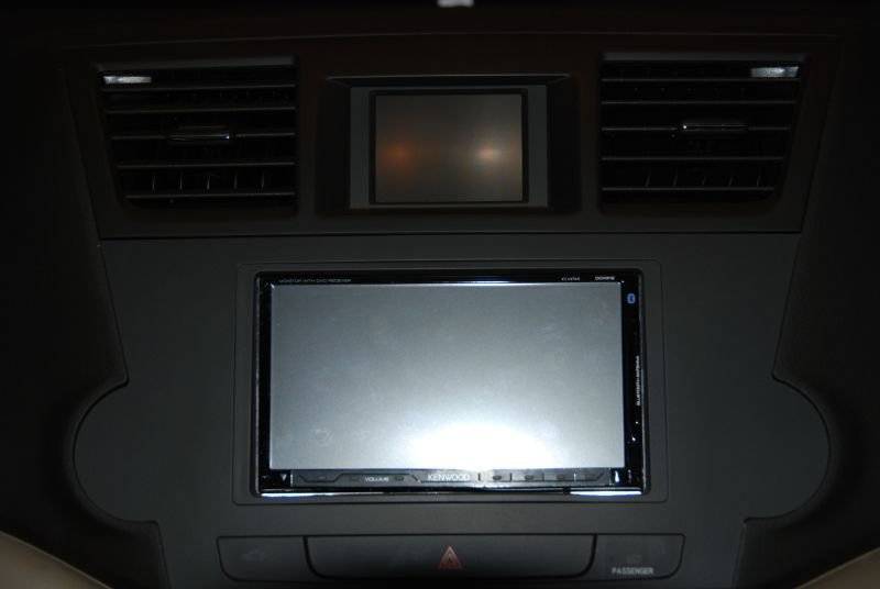

This shows the radio and a good chunk of the dashboard:

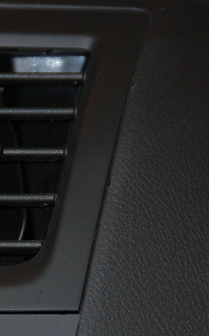

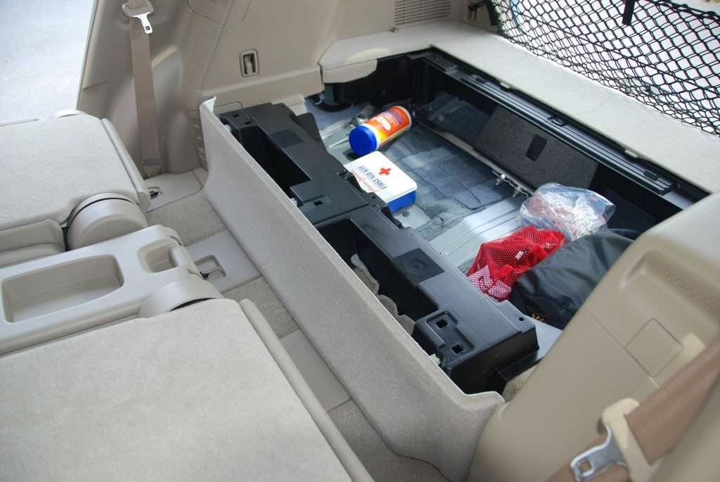

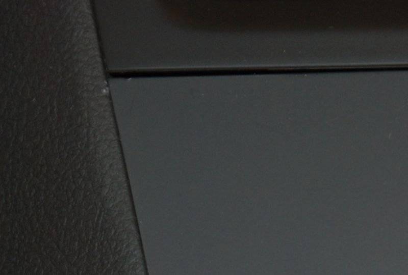

Here's a closeup of a few tool marks on the left side of the radio trim kit:

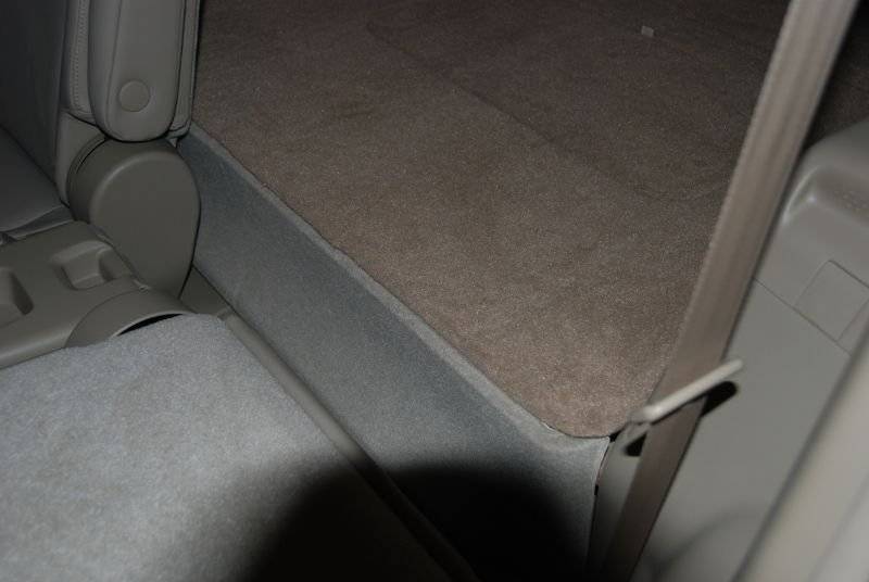

And a closeup of some more tool marks on the right side of the radio trim kit and vents:

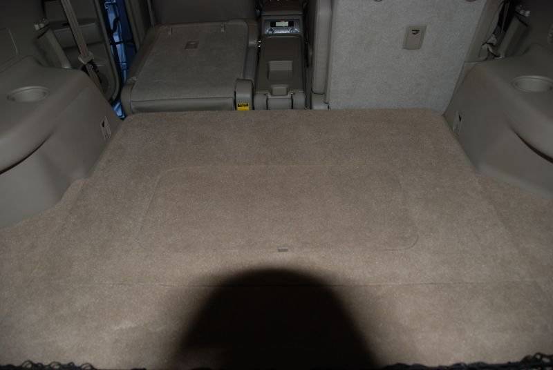

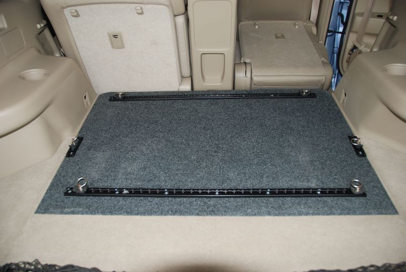

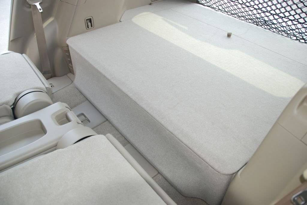

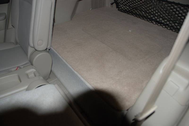

Here are some showing the cargo area fully covered. Note that the cover just behind the rear seats sitting below the floor is just stuck there - there's no longer anything really holding it in place where it previously clipped onto other panels:

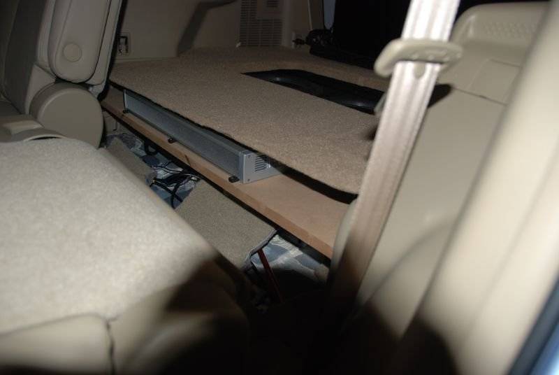

Here are some pictures with that front cosmetic cover removed:

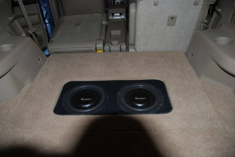

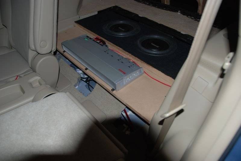

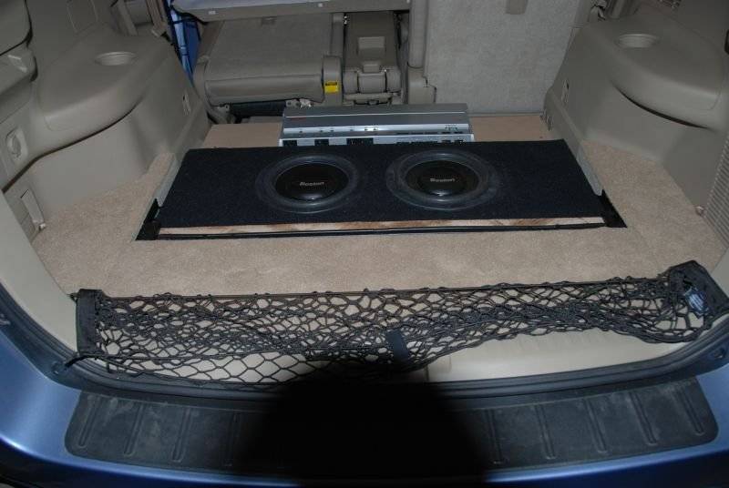

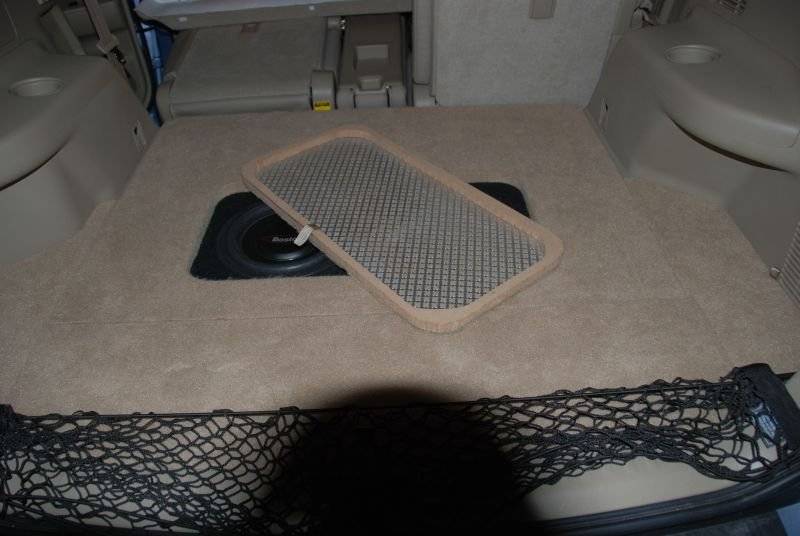

Here a few pictures of the subwoofers exposed:

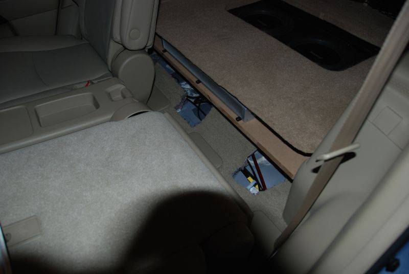

Here are a few pictures with all the flooring covers removed. The small red wire is going to my rear cigarrette lighter as I asked them to convert that to always be on. They tapped the power for it off of the amp.

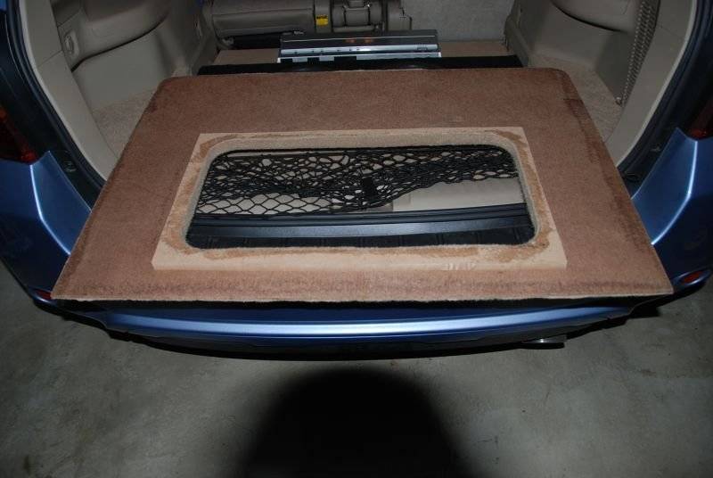

Here's an upsidedown shot of the rear floor cover they made. Notice how there's nothing to support it in the front:
And finally a shot of the cover that hides the subwoofers. Again, note that there's no support in the middle of it, so anything that has any weight will just go right through and damage both the cover and the subwoofers:

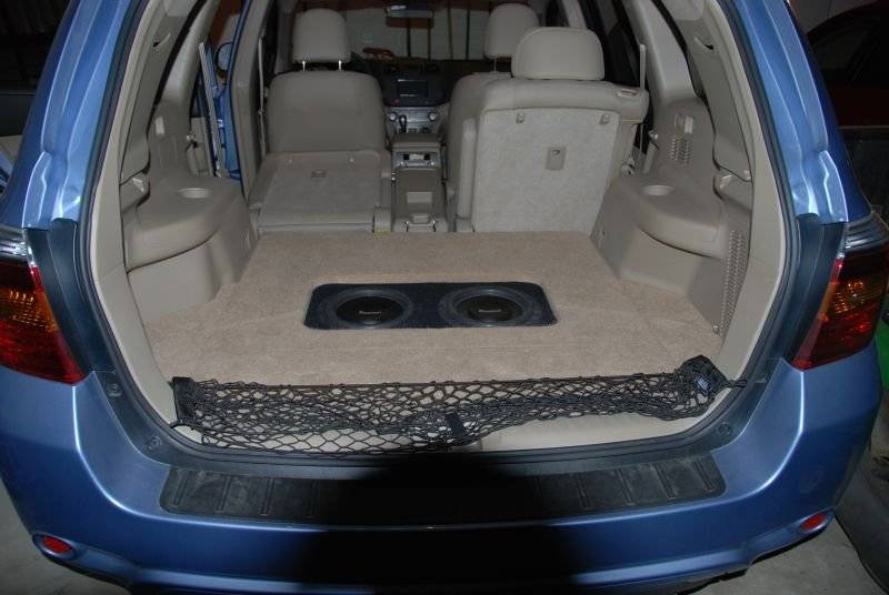

Here are a few pictures I took previously of the rear cargo area:
As long as you originally told them...
"i need to be able to to haul decent loads back there"
There is almost no way they'll be able to make it as strong as the original floor was, so thats asking for a lot IMO.
The dash i would DEFINATELY raise hell about, they used a pick to pop that panel off, they should have used a dynomat tool or plastic pry so it doesn't do that to the wrapped dash.

What are you expecting them to do on the cover panel? What kind of support can you really do that will let the floor hold the same amount of weight as it did from factory? You could do studs...but those panels can still bend and break.
At a minimum, there should be blocks on each side of the amp to support the floor. They've left a huge open area on each side there with absolutely no support for the floor. They should also be able to put some support on either side of the front center amp mounting point. Similarly, the subwoofer cover should at least have a support in the middle between the 2 subwoofers. As things are, I can't even put simple stuff like groceries in the back. I use the rear of my vehicle to carry cargo and made that VERY clear when we discussed options. If they didn't feel it could be constructed well enough to support weight, they had every opportunity to say so and should have.
Perhaps there's another subwoofer option that can be used that could be mounted in another location. For example, the rear of the front center console has a huge storage cavity in it that is accessible from behind the front seats. Perhaps a smaller subwoofer could be mounted in there, the amp moved to the storage cavity under the rear floor, and the rear flooring could be swapped back to what I had previously. Also, the JBL factory systems put a subwoofer in the rear cargo door - perhaps doing something in there would be an option.
I'm definitely open to options, but I'm not willing to give up floor space in the cargo area and I'm not willing to give up (much) strength in the floor.

I understand totally about using the suv to haul things.
What we've done in a few cars is molded into one of side panels of suvs, and done a single 10 or 12 firing to the side just to add some low end, and you still end up with 85% of the cargo area useable.
I agree they did skimp on some things, but I look at things a little differently then most people //content.invisioncic.com/y282845/emoticons/smile.gif.1ebc41e1811405b213edfc4622c41e27.gif
They could go back through and add strips to add some support for sure, and what they SHOULD have done is recessed the subs in at least 3/4'' so theres no way they can be damaged unless you set something down straight on them.
I also didn't realize the factory floor of the highlander was suspended like that, was there any support in the factory piece?
The install looks "clean" for sure, but they should have known better then to try to do something like that...if you are doing a hidden install, all it takes is some common sense to understand the customer is going to be putting things back there.
but 100% RAISE PURE HELL about that dash, unless they make it where you can't see it, or where its hard to see. Because if you ever get rid of the truck thats going to hurt your trade in.
They have insurance, go get em.
Saying that they skimped on some things is being generous, IMO.
I've been thinking about ways to resolve the problem all week and your suggestion of recessing the subs (if there's height to work with) is part of the solution. The other thing that should have been done is to mount the amplifier lower and then build a bridge of 1/2" or 3/4" plywood or MDF over it. Drill some 2" holes in that bridge for ventilation if needed. Then sink the subwoofers lower, if possible, and construct essentially a window pane grid over them. Even if it sacrifices sound quality a bit, it would be worth it to be able to use the cargo area again. Basically, the entire subfloor should be at the right height for the masonite panel to just sit on it. The only openings in it should be ventilation for the amp, if needed, and some openings for the sound from the subwoofers to get out.
You see the only support for it in the 2nd to last photo of the 2nd picture post. The factory floor piece is strong enough to be supported only at the front and back and support a lot of weight in the middle. I'm a big guy and it can easily support all my weight if I need to crawl around in the back for whatever reason.
Will do.
I dropped the car off at the shop last evening and picked it up a little while ago. I'm a lot happier now and they still have a few minor things to finish.
1) They connected the power for the antenna. The reception is not as good as the factory radio had been, but I think I can live with it. I'll know better after a few commutes and longer trips. But at least it's getting more than 2 stations on the auto scan now //content.invisioncic.com/y282845/emoticons/smile.gif.1ebc41e1811405b213edfc4622c41e27.gif.
2) They cleaned up the damage to the dashboard. I think it looks fine now.
3) They beefed up support for the cargo floor. They also screwed it down. There are still one or 2 spots that really ought to have more support and they said they'll address that when I come back next week. Depending on just what they do, I may end up doing some more myself, but I'm pretty happy with it now.
4) They're rebuilding the cover that goes over the subwoofer. They've ordered a steel grate of some sort that they will route a slot for in the existing cover. The expectation is that this will be something that can hold reasonably substantial weight. They expect to have this ready for pickup mid next week and will address the final floor support issue then.
5) They attached the cosmetic panel on the front of the cargo floor so it won't shift position.

7) They moved the navigation unit to a more accessible location under the glove box. Apparently it had previously been buried in the center stack behind the heating controls. Not a huge deal as I don't expect to be updating the maps too often, but it will make it easier when the time comes.

Id push for a better match on the carpet.. Looks like you have a tan neutral interior and they used more of a golden tan covering. For the price paid, and the work done (nothing too extravagent) they could have used better materials IMO
The color match is actually pretty good. In the pictures, you may notice that the cargo floor consists of 5 pieces - Audio Werks is responsible only for the large piece that covers the amp and subwoofer area and the removable subwoofer panel. The other 3 pieces (left and right sides and the very rear piece) are all factory, so the factory cargo floor color is different from the rest of the interior. Audio Werks actually ended up ordering a second color to get a better match because they weren't happy with the initial choice they had made. Time will tell how the quality of the fabric they went with is and how it holds up compared to the factory fabric.

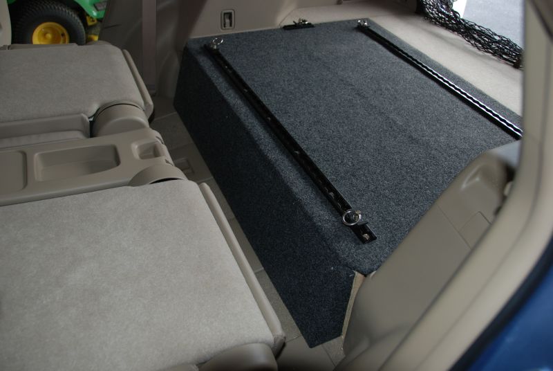

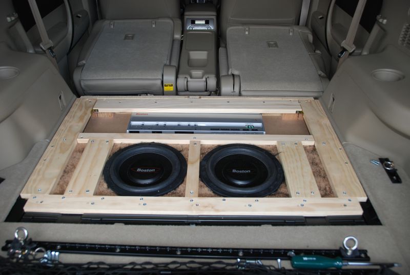

I finally got around to fixing the rear floor mess myself.
Ken448 had mentioned the bad color match on the carpet which I initially thought wasn't a big deal, but I later noticed that they had put the mismatched carpet OVER the original carpet on all of the rear floor panels. I wasn't at all happy about that because it would have meant a lot of work to remove it at some later date to sell the vehicle without the audio system or if I wanted to change things, etc. The carpet also didn't adhere well on top of the original carpet, so some of it started coming off before too long. I made them remove the extra layer of carpet and clean up the glue that was left behind - this took them a few days.
I gave up on them fixing the support for the rear floor properly as they just weren't getting it. Work kept me busy for a while, but I finally got time to fix this myself over the last few days (I'm in stay home vacation mode for 2 weeks - I hope to knock a bunch of things off of my to-do list). I removed what they used for the rear floor panel and replaced it with a sheet of 1/4" plywood and added LOTS of support underneath so I can now carry a non-trivial amount of weight in there without too much worry of damaging anything. I cut a pair of 8 inch holes in the plywood using a Rotozip circle cutter attachment and put steel grills over the holes so the sound from the subwoofers can get out. It really wasn't that difficult for me to do this myself and this isn't something I do on a regular basis. The shop that did the install shouldn't have had any trouble coming up with something similar. Rather than trying to find a really close match for the carpet, I decided to go with something that I felt contrasted well with the factory carpet.
For the trim panel they had left loose in the front, I built a replacement box and put the same carpet on it, then screwed it in place so it won't move around.
