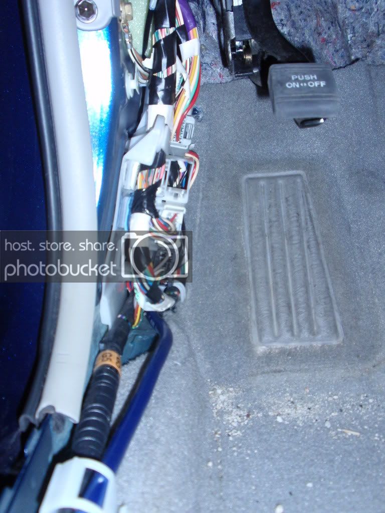

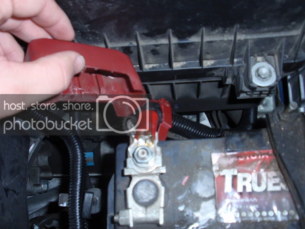

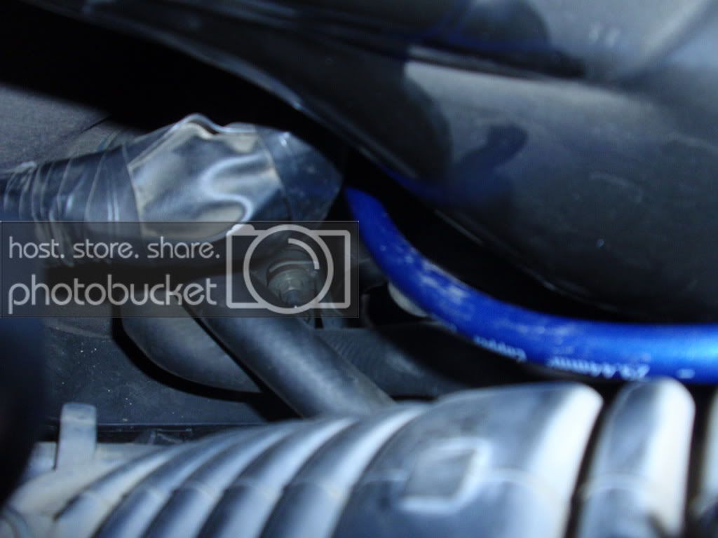

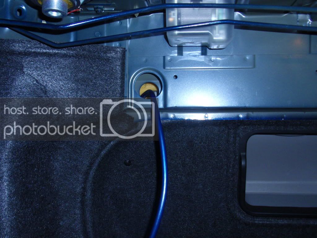

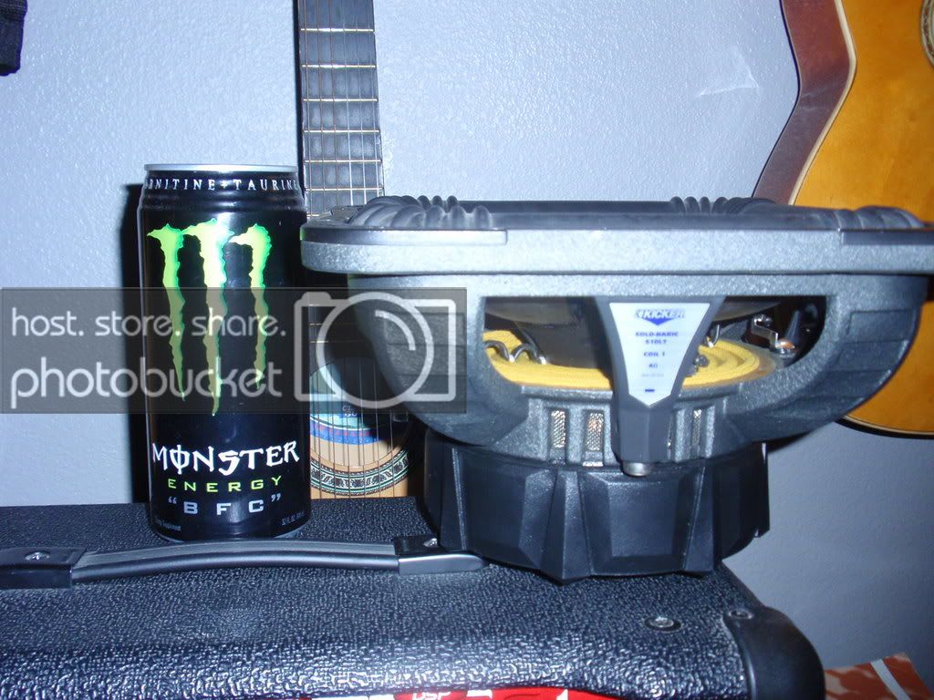

I just started making the build for my dad's 08 Camry. All i've done is the wiring, but here is what i'll be putting in:
06S10L7
2.0 Cu Ft. @ 34 hz
Directed 1100D @ 2 ohms
KnuKonceptz 4 Gauge wiring
LOC (i'll only be adding subwoofer to stock system)
Here's some pictures of the wiring and one of the sub =)
Not bad , but please , please grommet that wire you have running through the metal on both sides of the piece. Those area's back there are sharp as shit. //content.invisioncic.com/y282845/emoticons/smile.gif.1ebc41e1811405b213edfc4622c41e27.gif
K thanks. im not 100% sure if im going to leave it there, the amp will be on top of the box so its easier that way.
The 2.25cf enclosure is the SPL/Deep bass enclosure.
For some reason Kicker no longer lists a street bass medium sized enclosure recommendations.
A 2004 10L7 the manual has-
1.75cf + port
2.75x11.25"x, port 17.75" long
I'm sure you dad will love the stock HU with stock speakers being overwhelmed by a sub! //content.invisioncic.com/y282845/emoticons/crazy.gif.c13912c32de98515d3142759a824dae7.gif
And do the 1.75 or 1.5 box, 2 is way too big learn about Q values then rethink your box design.
ok, i guess since everyone says 2 is too big, then i will go for a 1.75 cu ft box tuned to 34 hz. i havent made the box yet. I plan on getting the wood cut this weekend or sometime during the next week.
