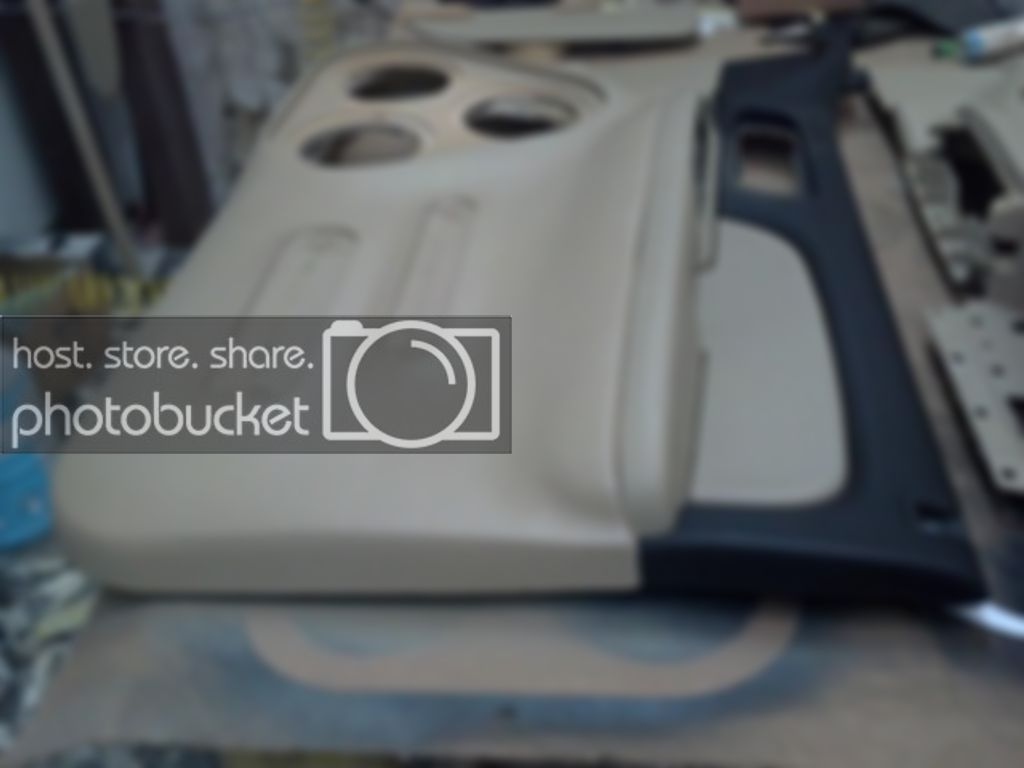

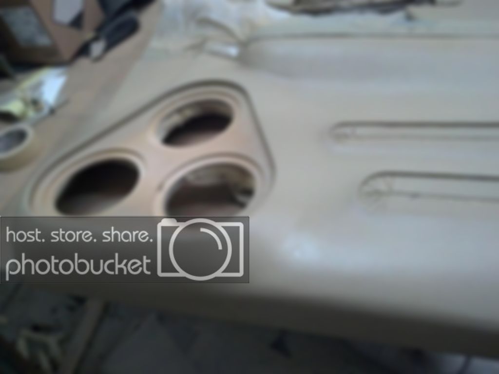

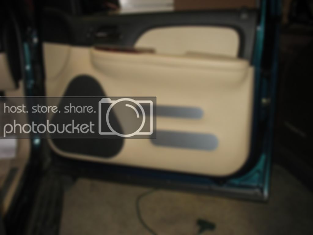

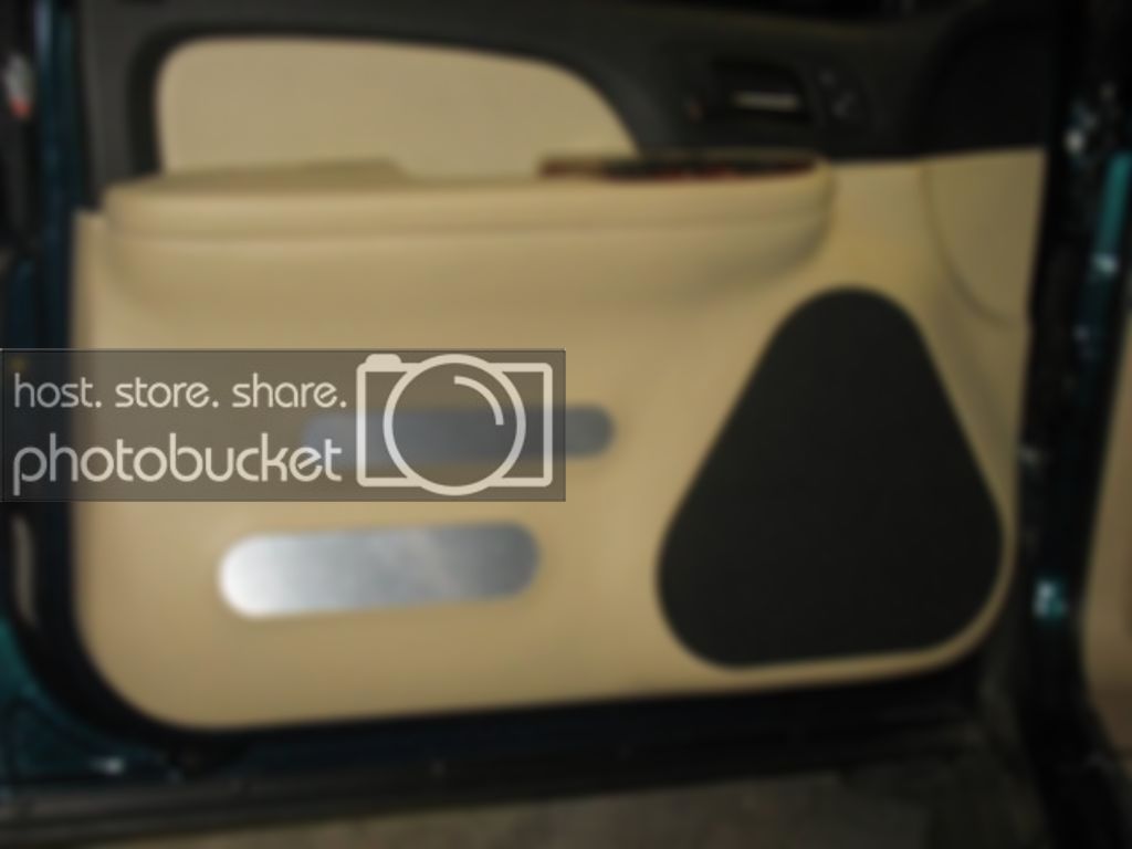

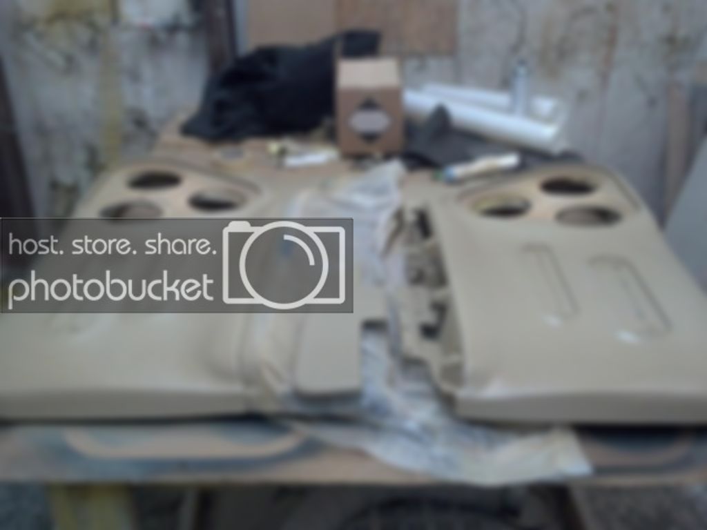

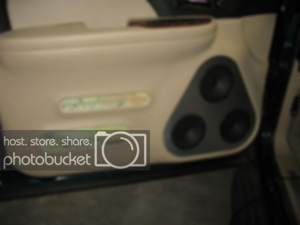

So I did not really like how the 1st set of door panels turned out so I got help with these. Almost done with them as Crusisers mobile Audio did this set which is well above my skills.

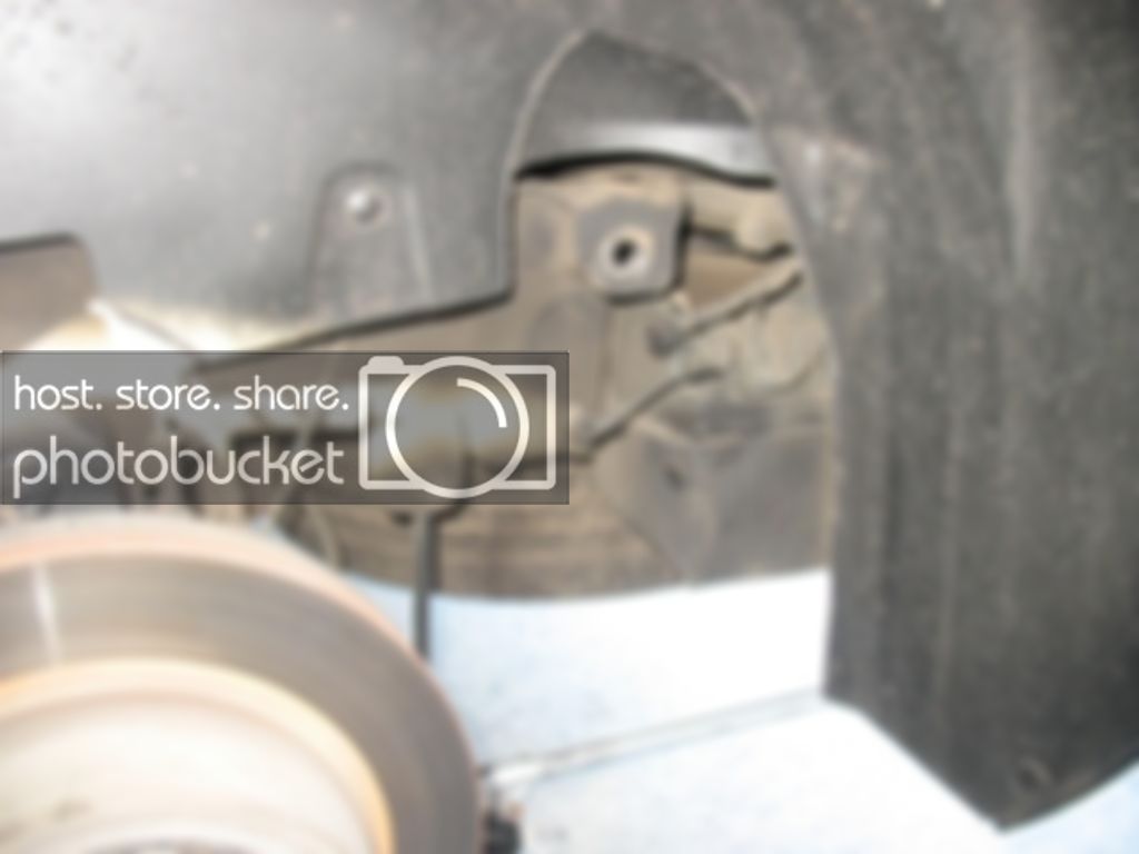

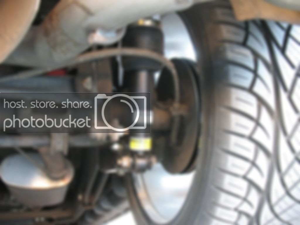

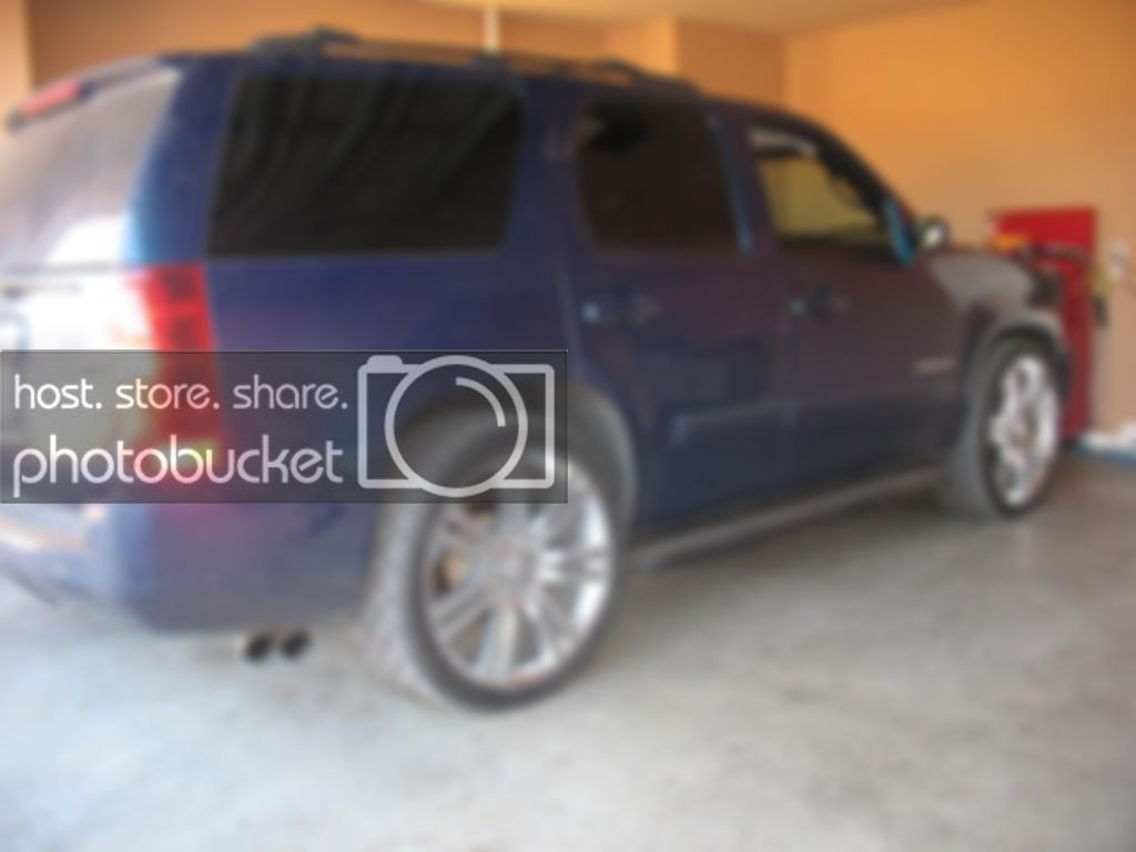

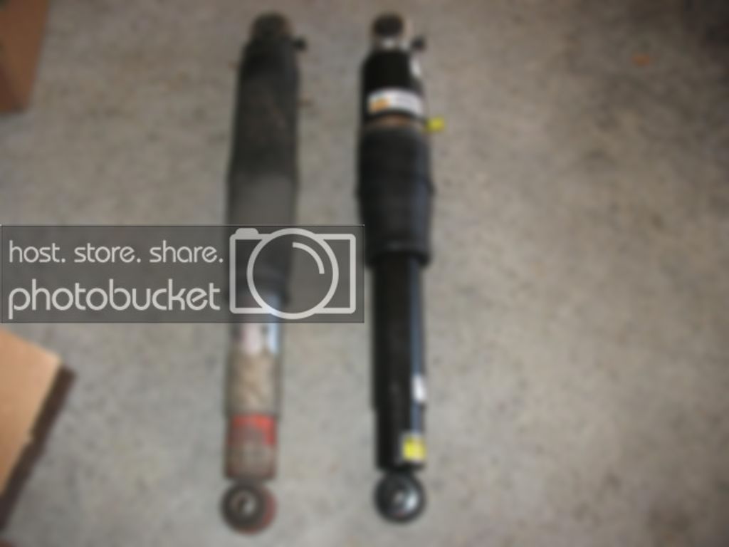

So got the new tailpipe and Magnaflow installed. Also just finished up replacing the stock Airshocks with some Arnott Air socks for those with air shocks
https://www.arnottindustries.com/
Very easy install and only took me about 2 hours with a floor jack.

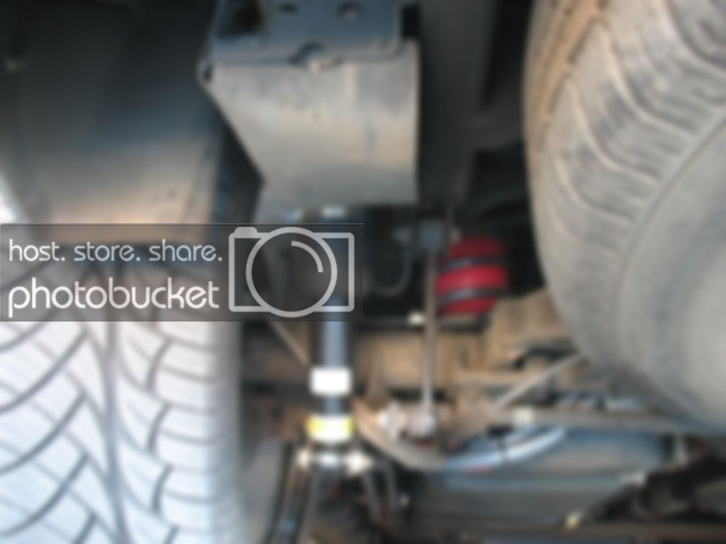

Added the Airlift bags for an extra helping hand with the weight.
And now that the airshocks are actually holding air the rear actually came up quite a bit.

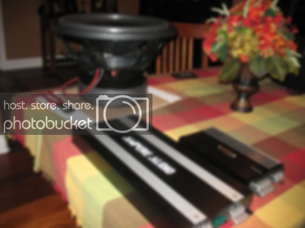

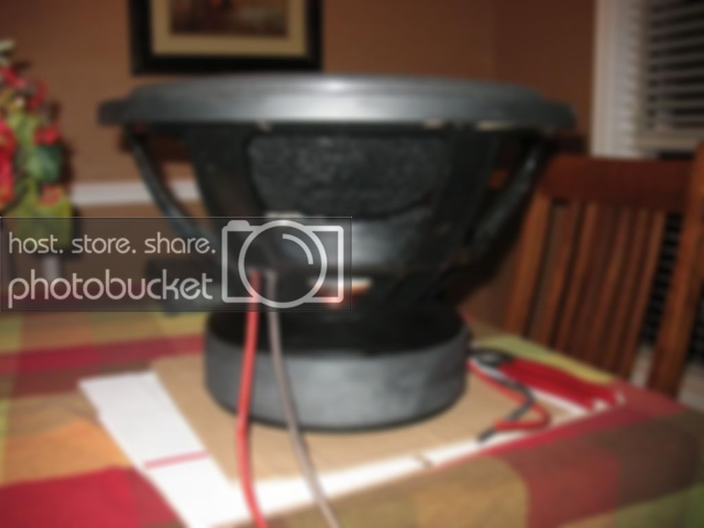

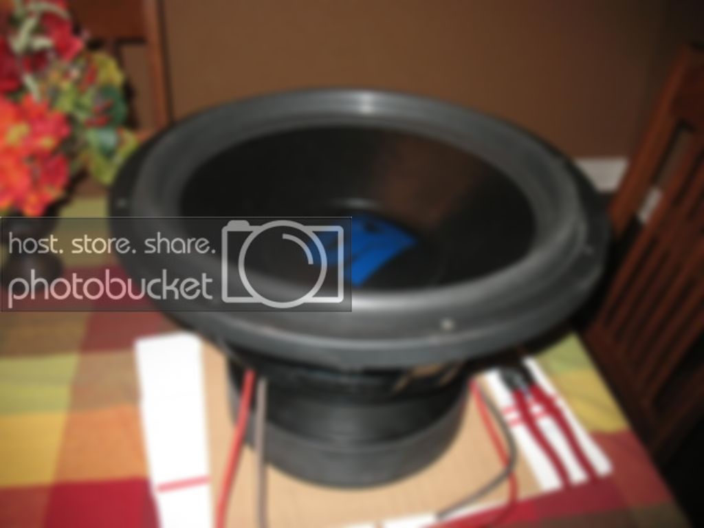

Are you going to use Ampere Audio amps now instead of the sundowns?
Yes, I plan on switching.

About to start youtubing how to cut, fit, and fiberglass door panels and a pillars. Looking good. Did you have the stock bose in yours?
Yes, it did have the stock Bose.
