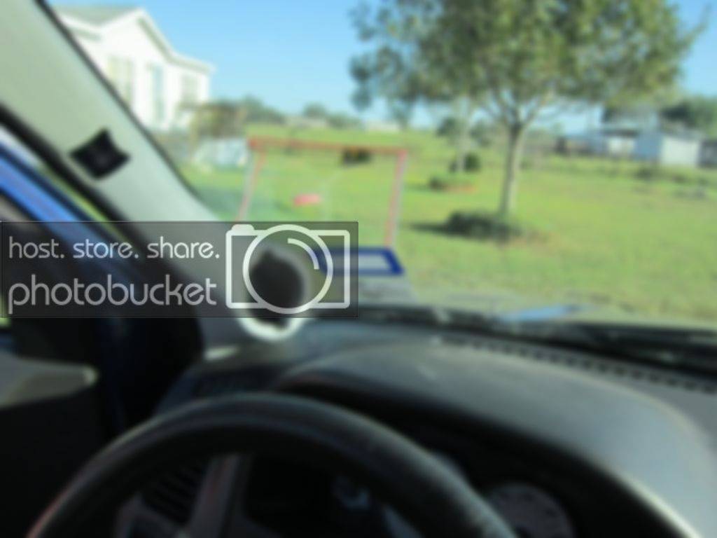

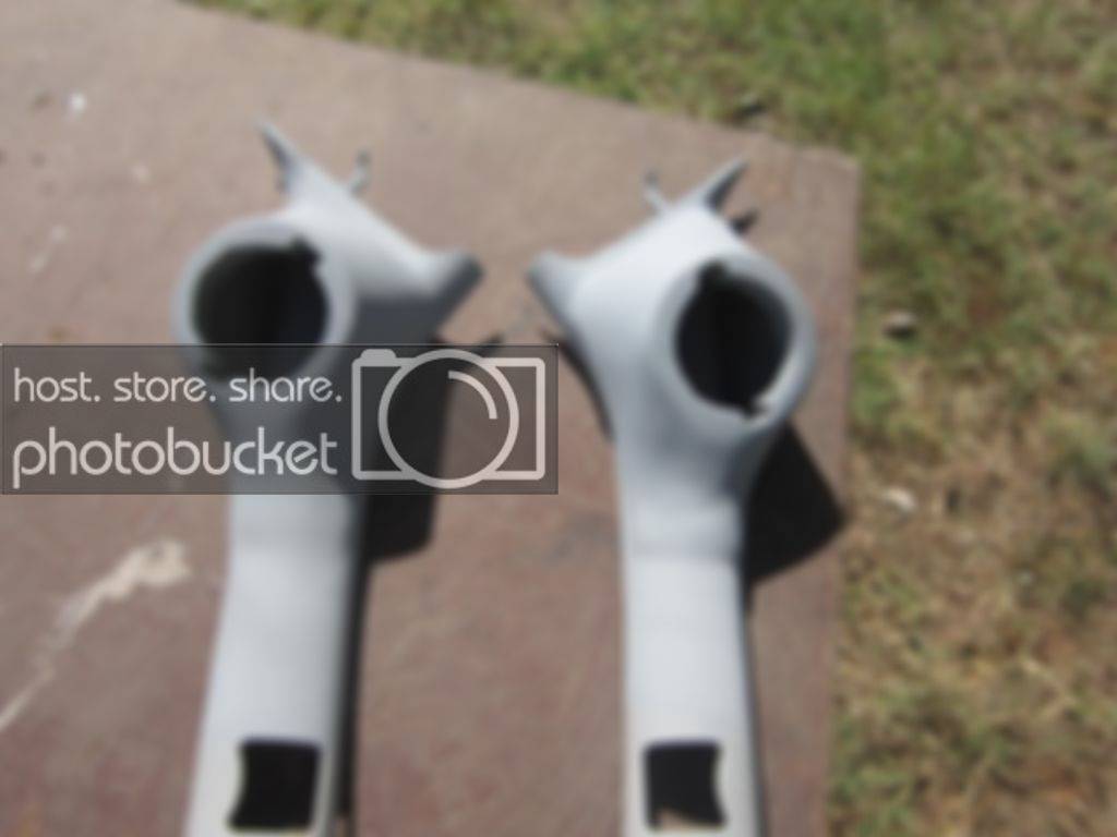

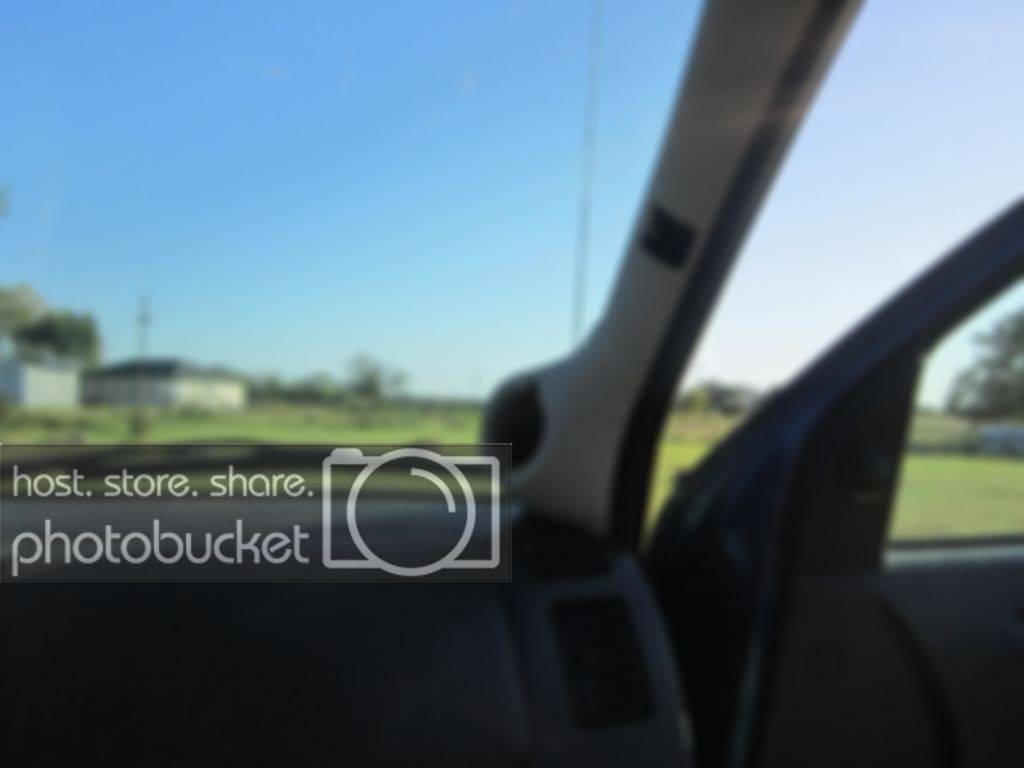

Showing i got the A-pillars fixed and test fitted...

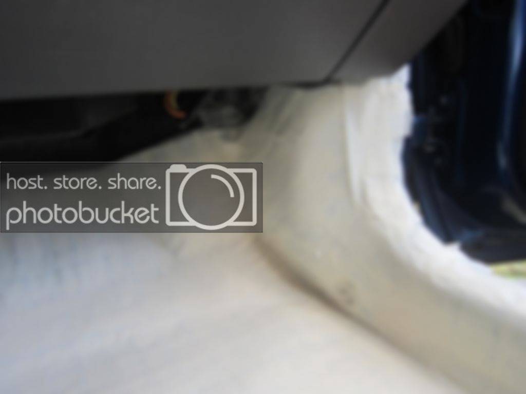

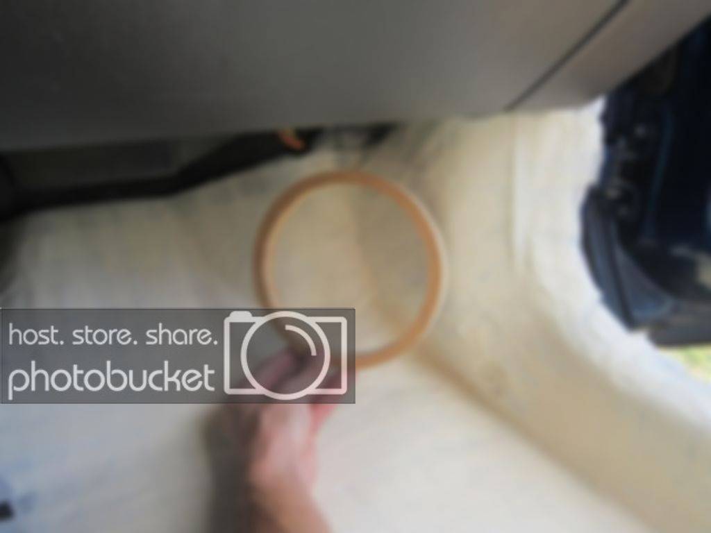

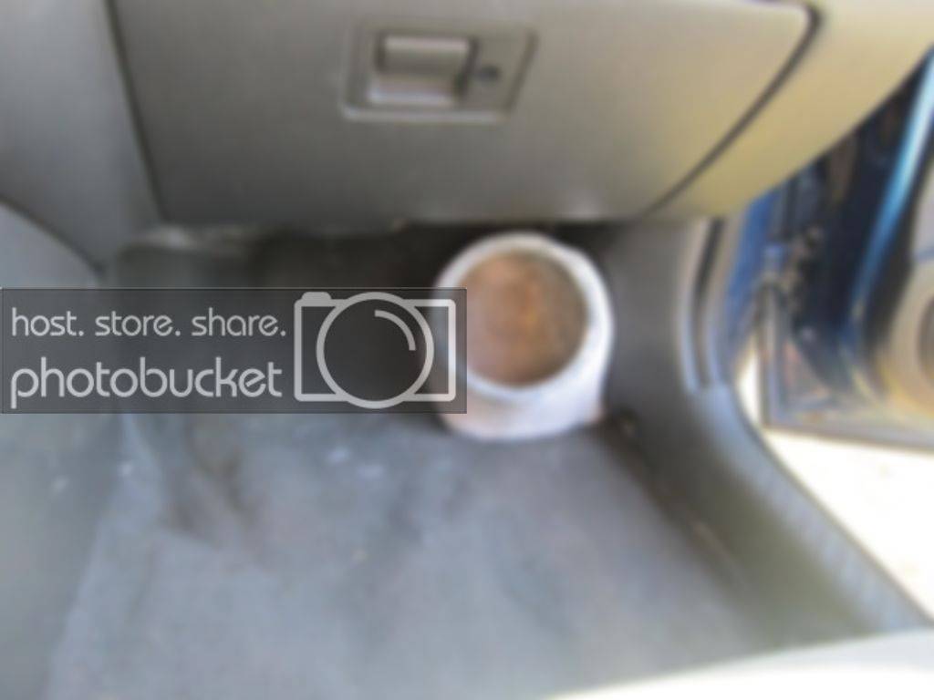

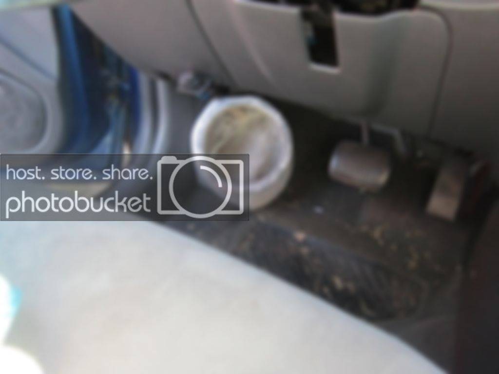

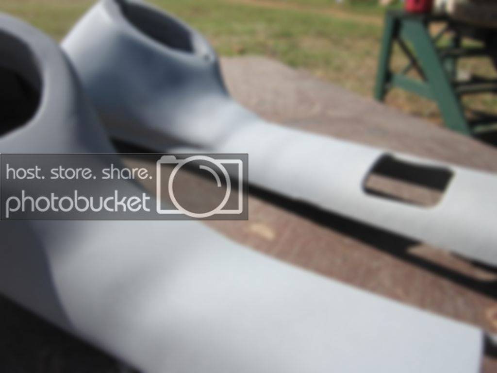

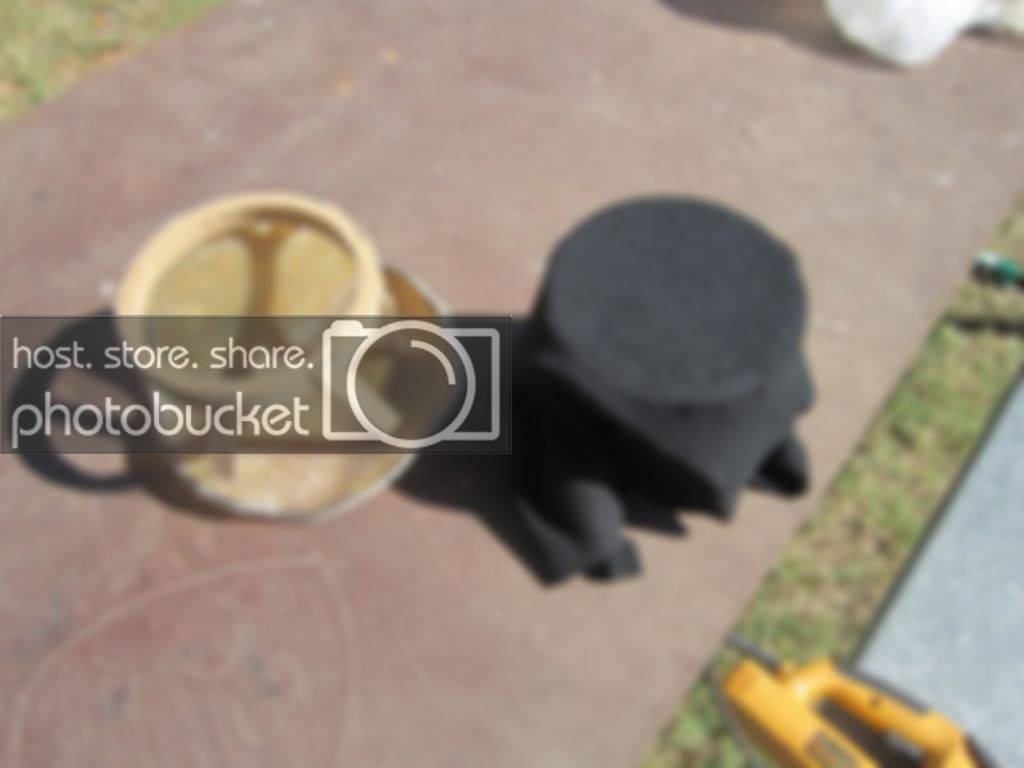

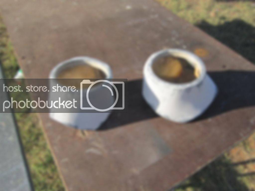

Then i started working on the kick panels...
got it taped here ready for glass
decided to use foil tape to help with the ease of taking off the tape from the glass molding...
Got my prep work done..

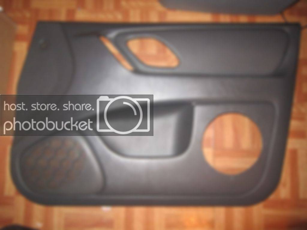

I also got started on the doors. A little bit at a time.

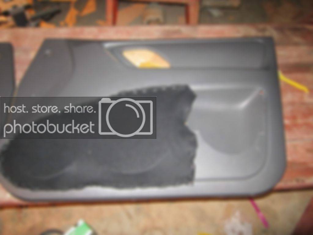

A before shot of the door
I have the ring cut out and it is wrapped with fleece just waiting to get glassed up
If you compare to the before pic you will see what i am going to be relocating the pocket area to the rear part of the door.

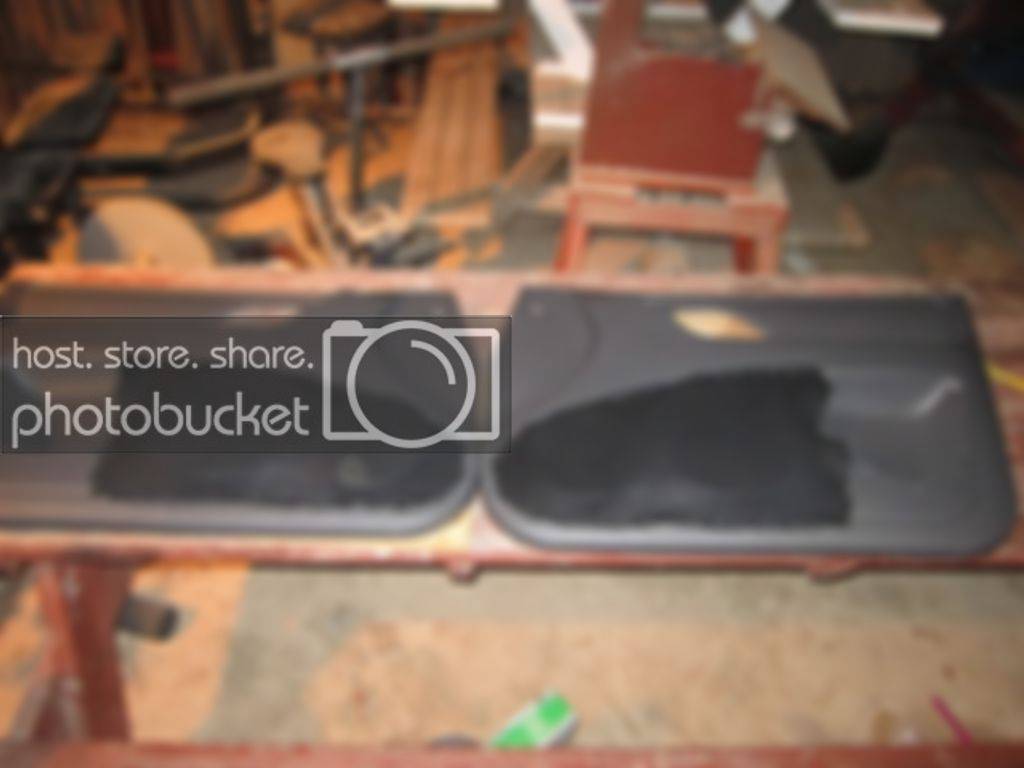

So i started to strip out everything all old wires remove the old speakers and start cleaning everything up so i could start putting deadener in.
My giant mess of wires that i have to take out. everything is zip tied and wrapped with electrical tape. Also all wires were soldered and shrink wrapped.
After i got the wires cleaned up and taken out i started to get test fitting the doors just to make sure they will fit still with the new speakers in. As you can see i needed to do some modified work here to make some clearance for the 6.5 and some more clearance for the pocket i relocated.
