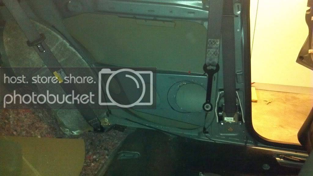

Not sure what im doing for substage yet, Will have 2 8"s in the cabin(Refer to pics) just not sure what I wanna go with yet. Will be sealed

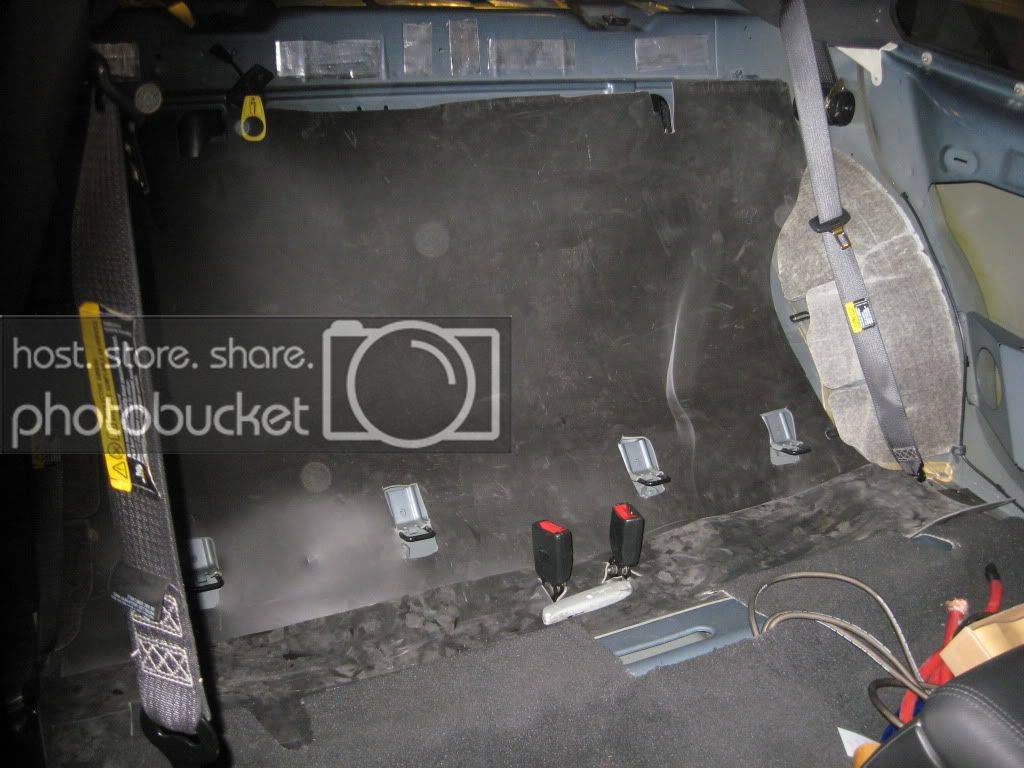

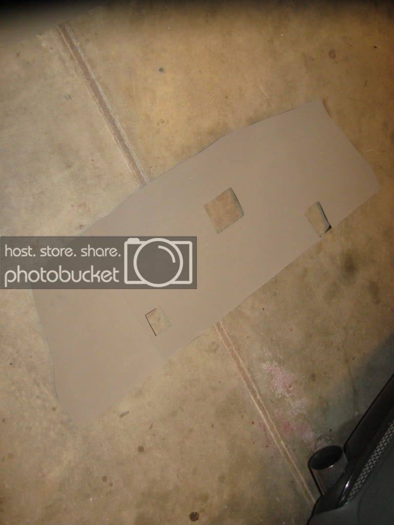

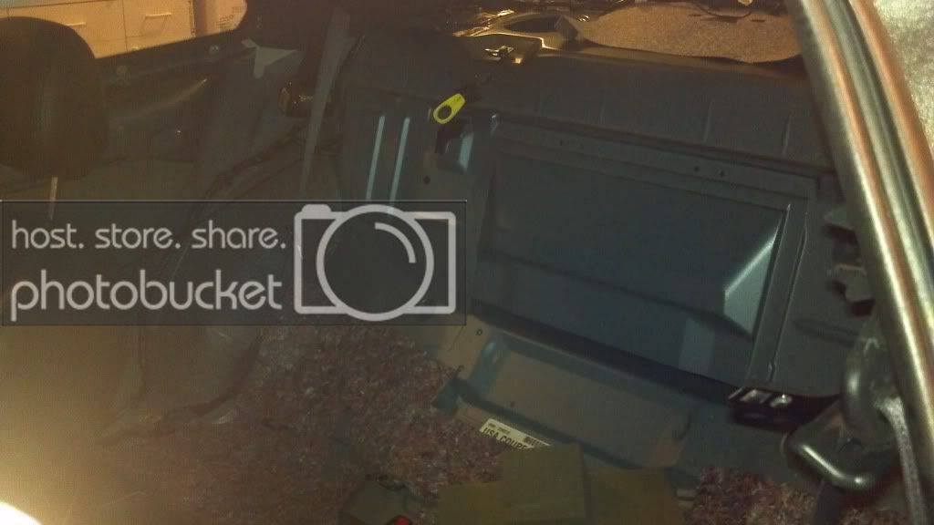

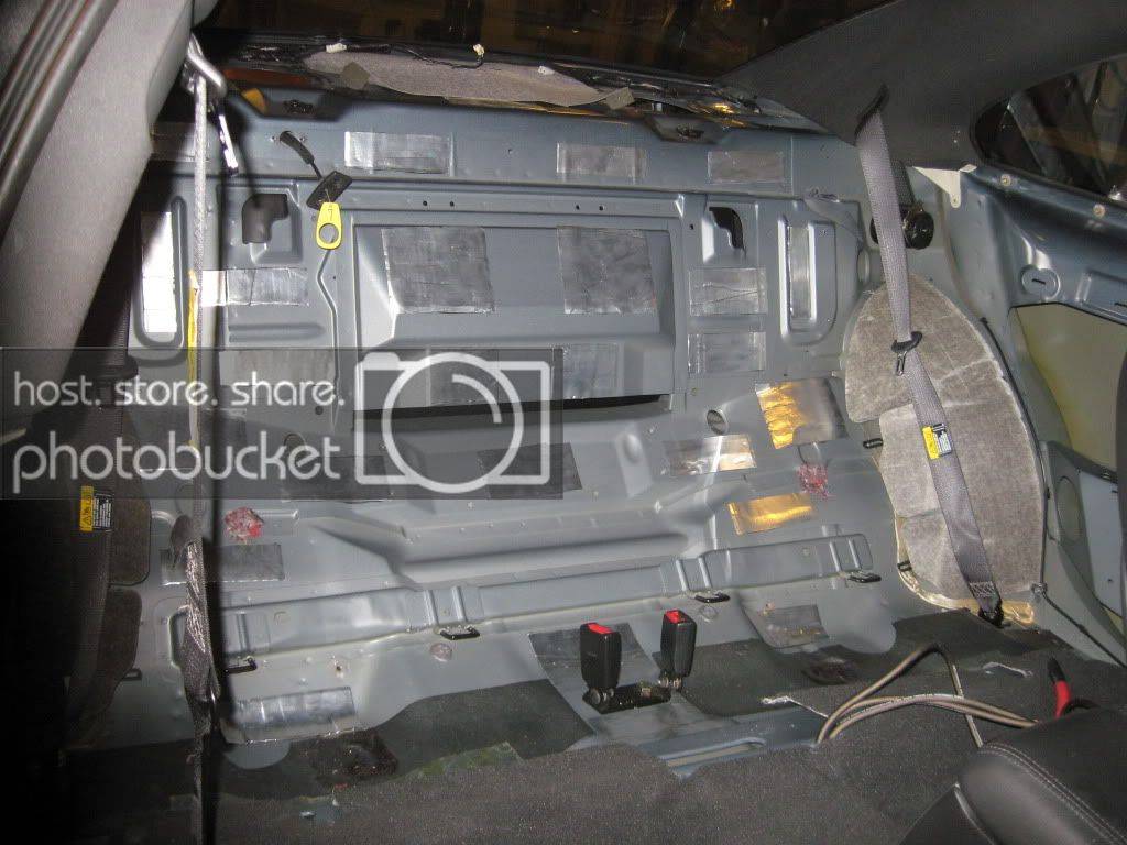

The 8's will be in this area, just gotta figure out how Im going to do it. Plenty of time since the car isnt being driven because of winter.

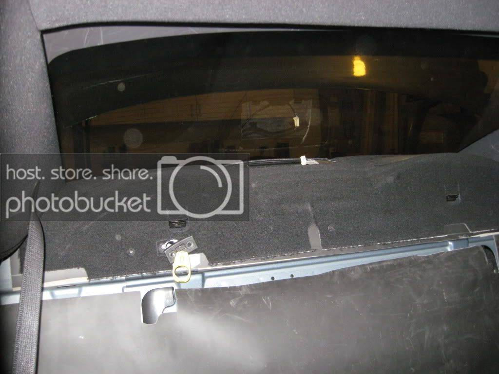

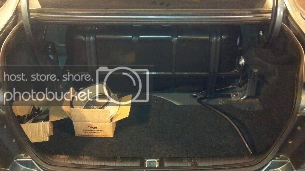

The trunk is TINY because of the gas tank so thats why theres no substage in the trunk and I am not willing to give up my spare since I live in the country. Still thinking about how im gonna do the baffles for the mids. Dont really wanna use the OEM's since itd require quite a bit of trimming and the window is only about an inch away from the inner door skin so a basic baffle wouldnt work.
the gas tank is just chilling right in the trunk?!,ive loved gtos looks and power, but thats a fail for engineering.
Theres a 1/4" walled, 1" steel tubed frame that bolts behind it for collision purposes. The aussies had the gas tank mounted inside the rear bumper but once the design came over here they moved it into the trunk. thats really the only place to put it in these cars lol

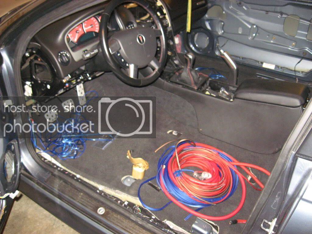

Car basically gutted.
***** because the carpet basically goes up underneat the dash and id have to unbolt majority of the dash to completely remove the carpet.

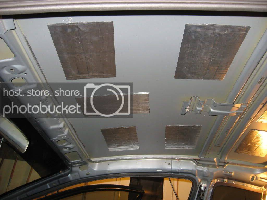

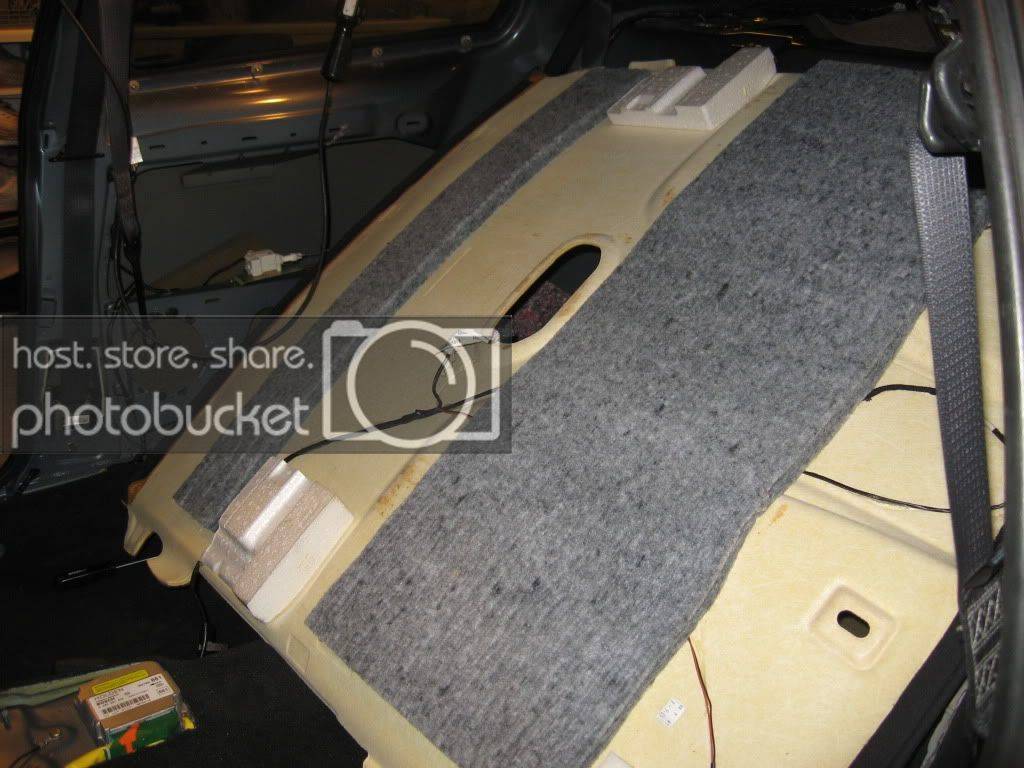

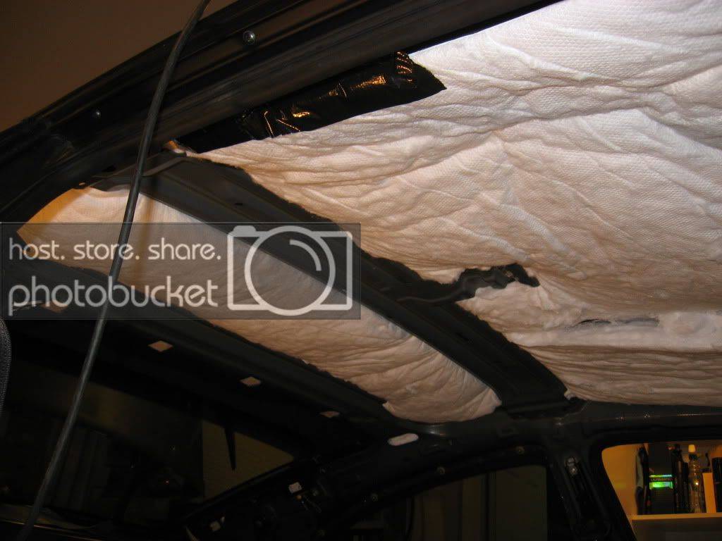

Dropping the headliner ****** in this car. It has some kind of foam underneath the fabic. and everytime i touched it just barely enough to lift it up, there would be little indentations from my fingers

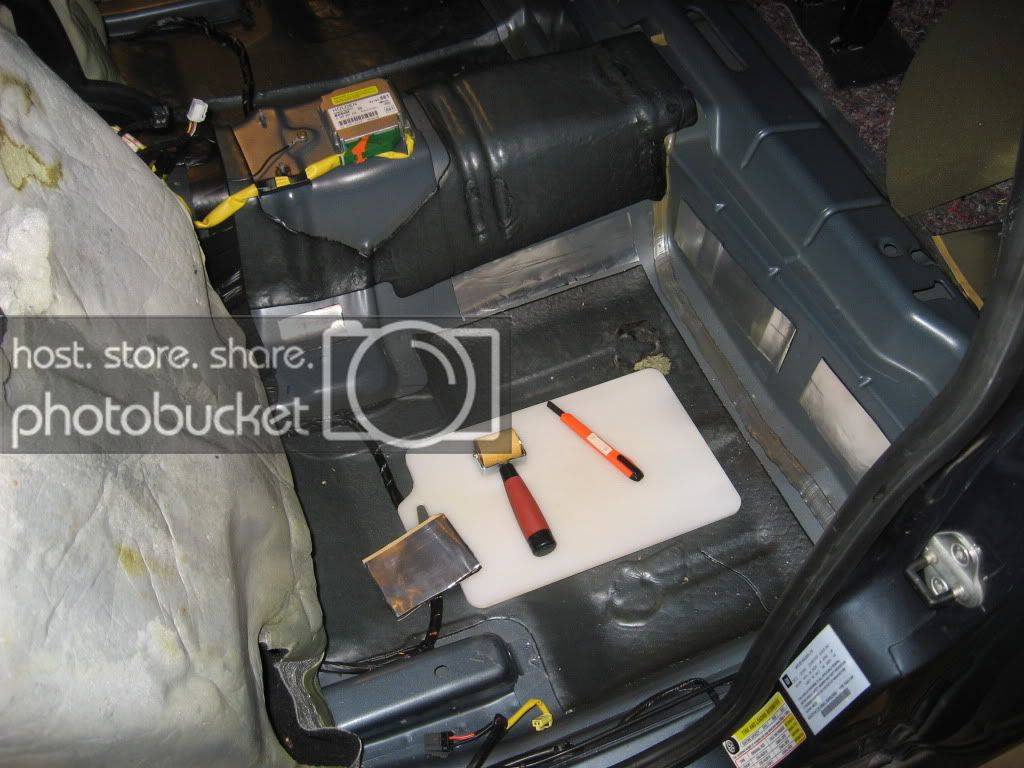

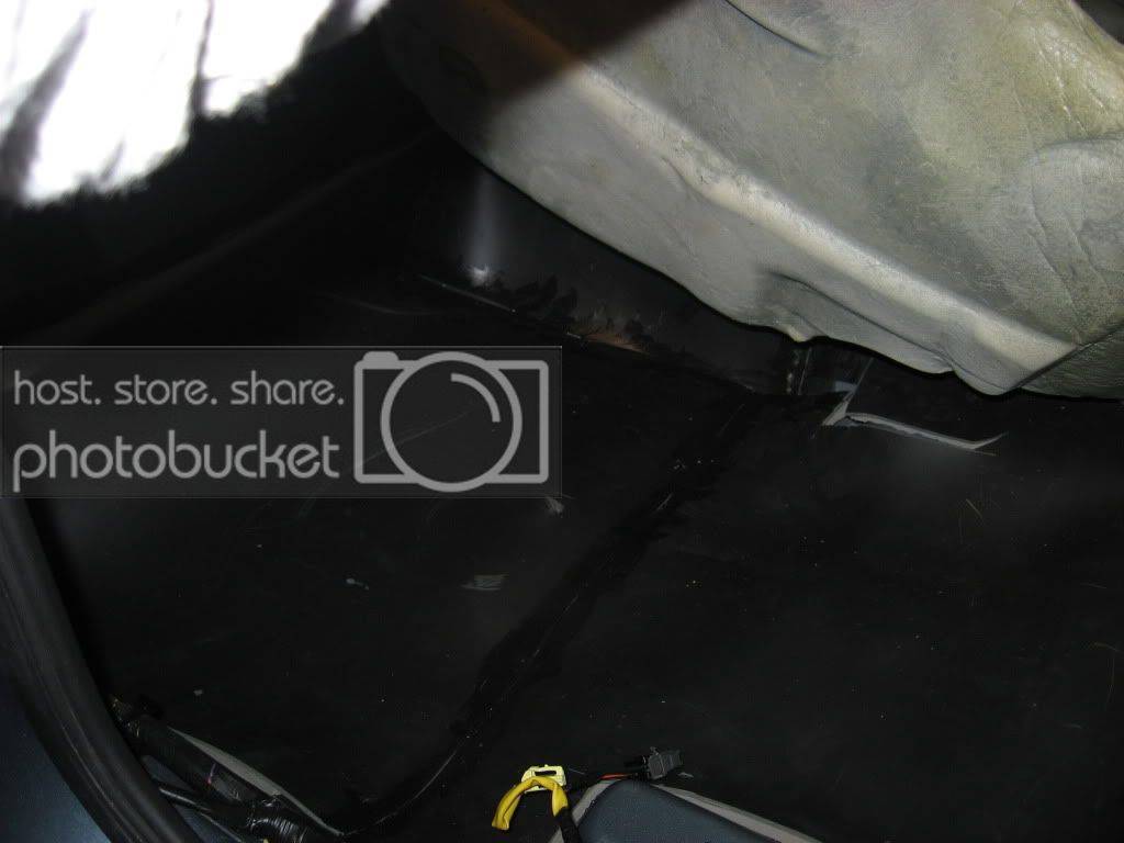

Never wanna work this this **** either. gets everywhere and pisses me off trying to cut it lol

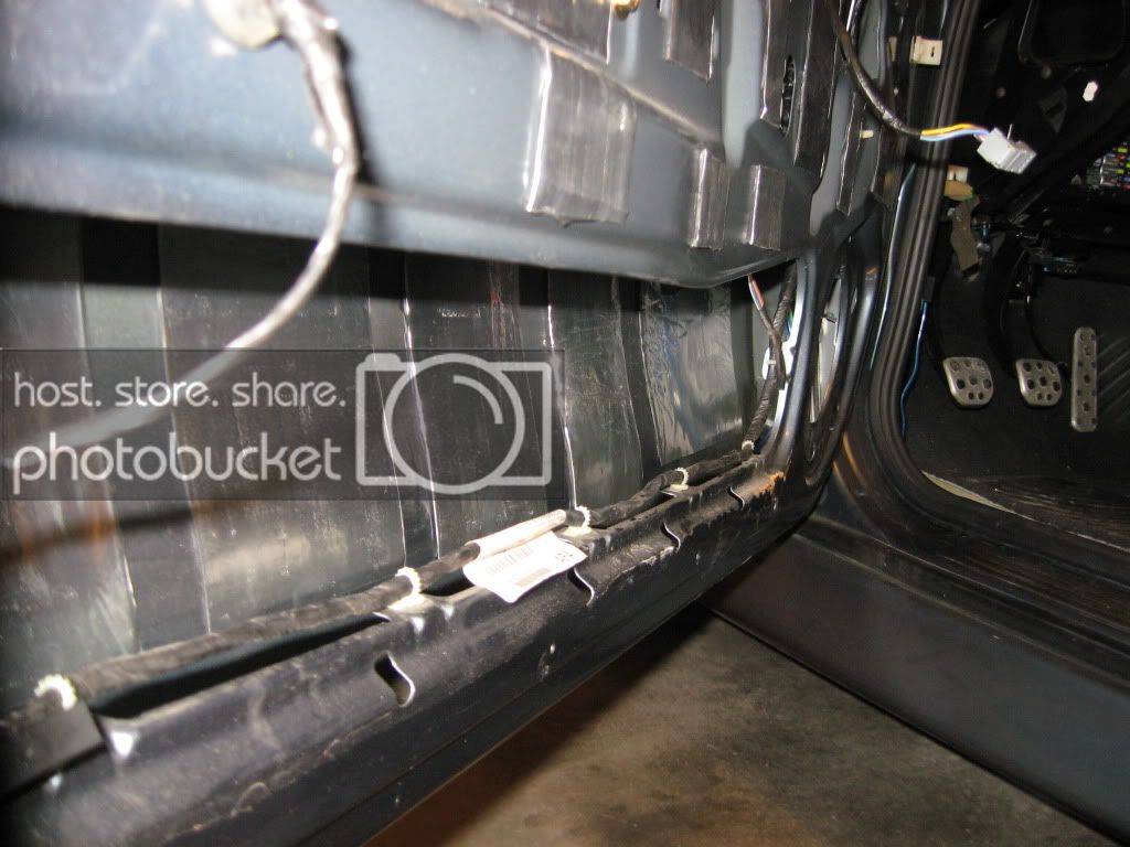

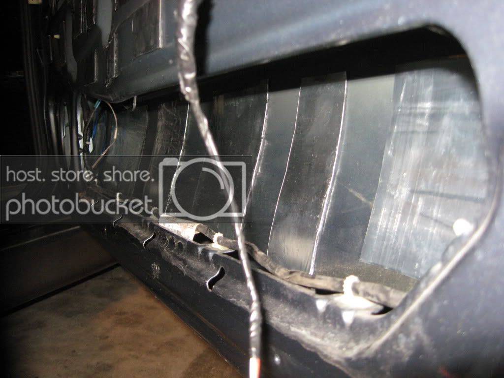

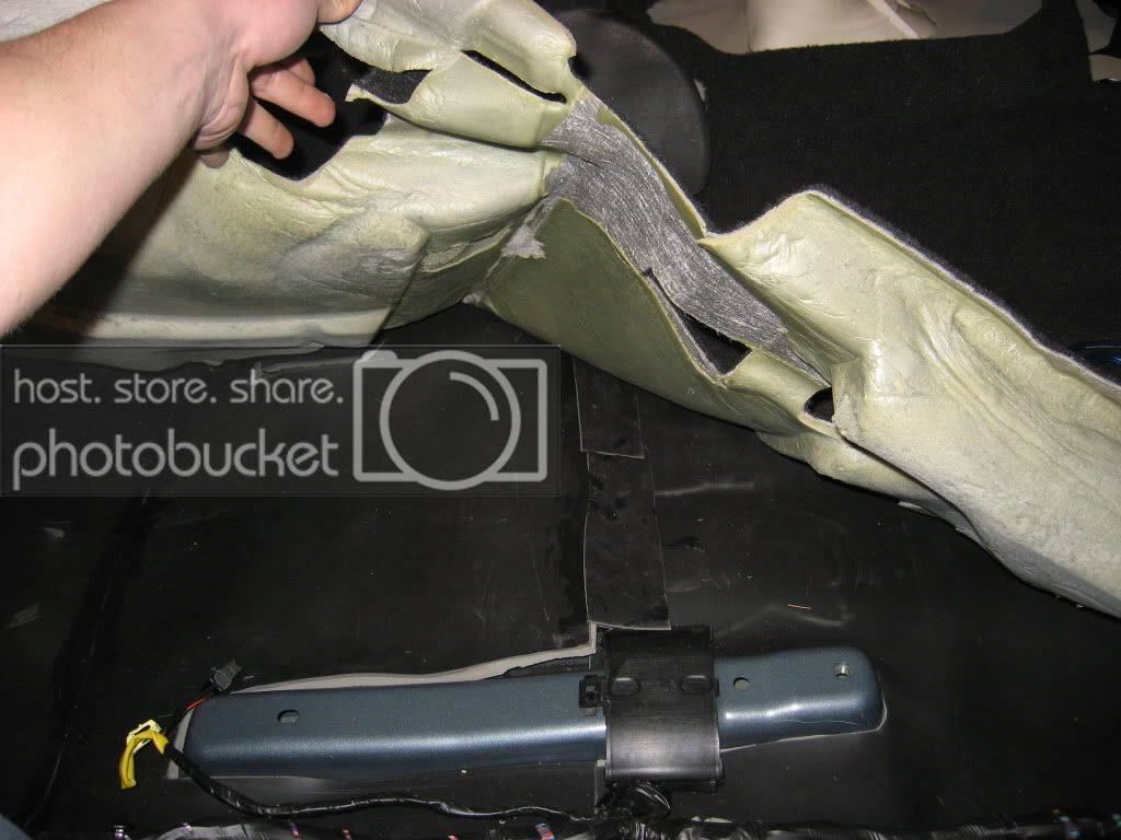

Most of the stock vibration damper was in great shape so there wasnt much to be gained.

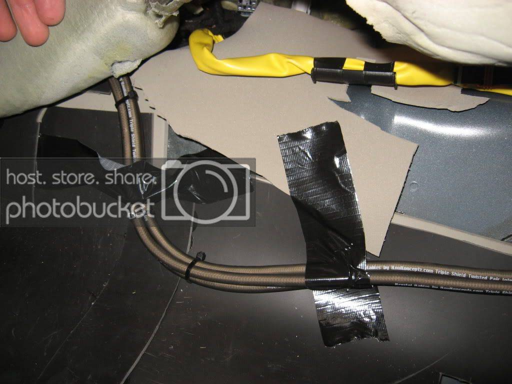

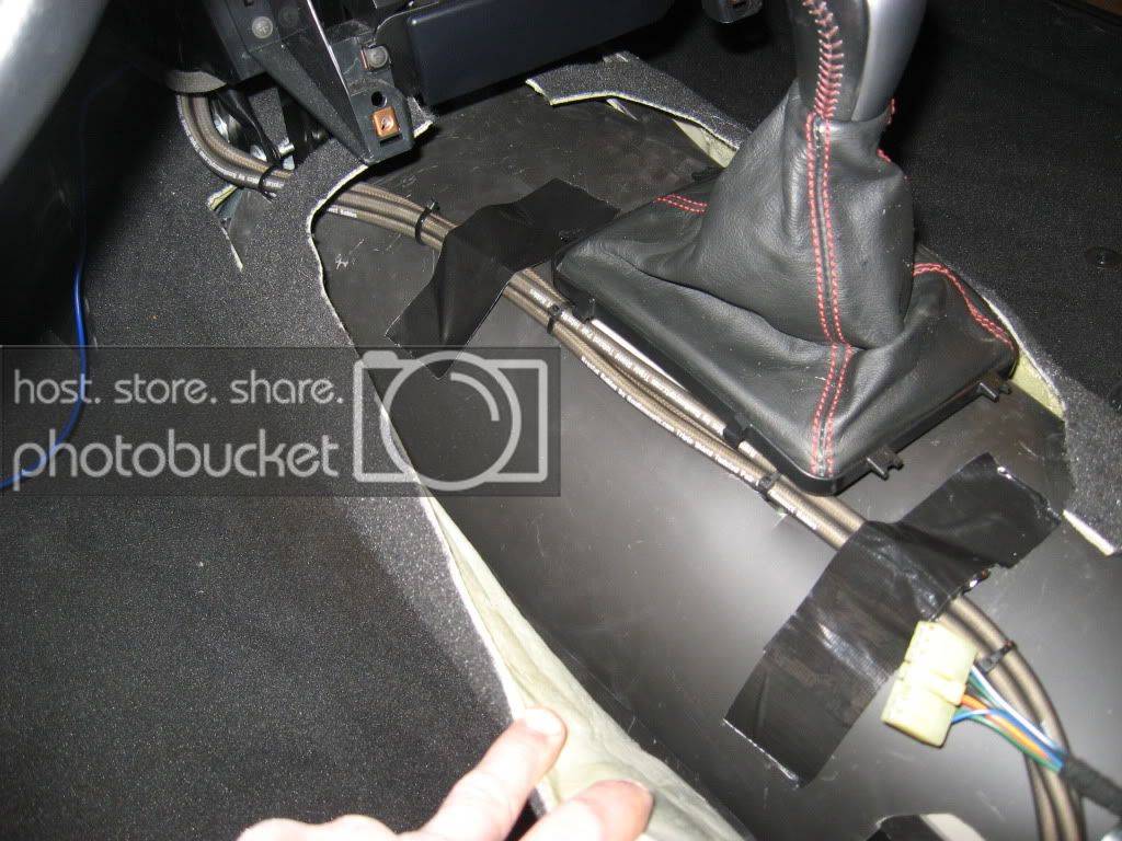

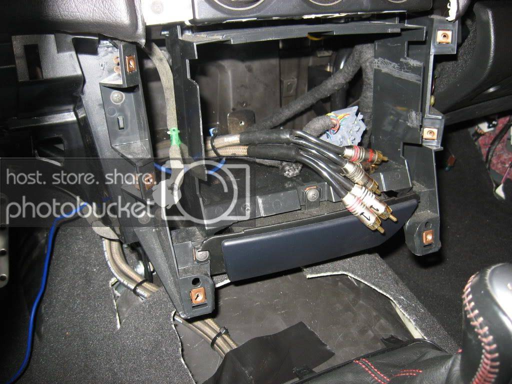

Also ran the RCA's since I wanted them down the middle.

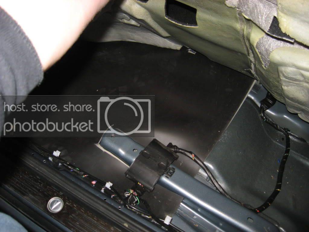

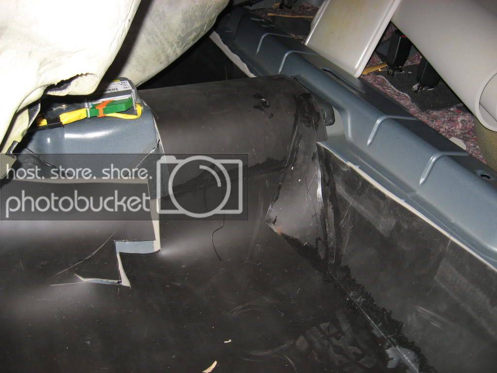

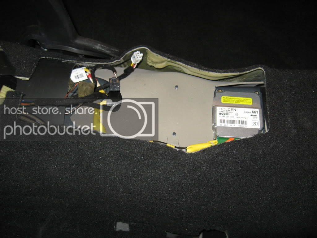

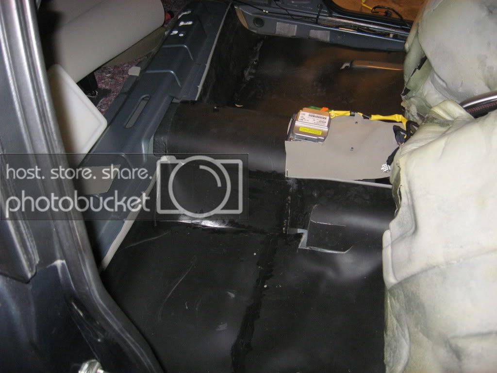

Wanted to dodge this as much as possible. Didnt know if it would malfunction by interference or what exactly its even for. Since it was in the middle of the car so far away from everything else I figured Id just steer clear to be safe. Its something for the airbags

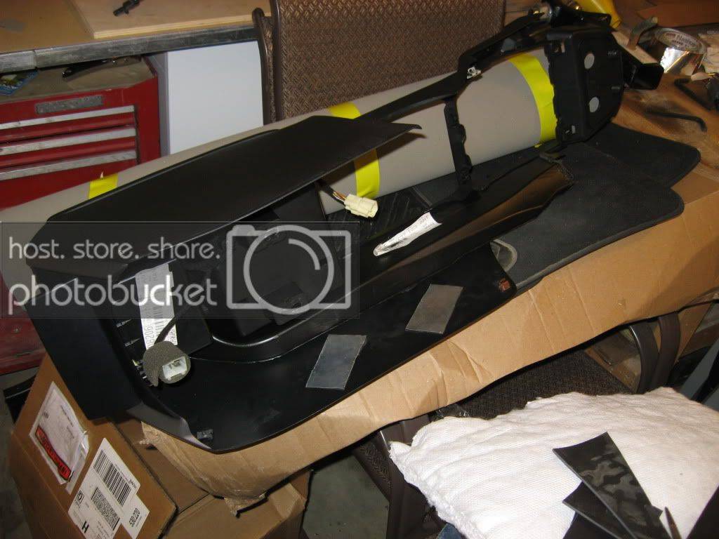

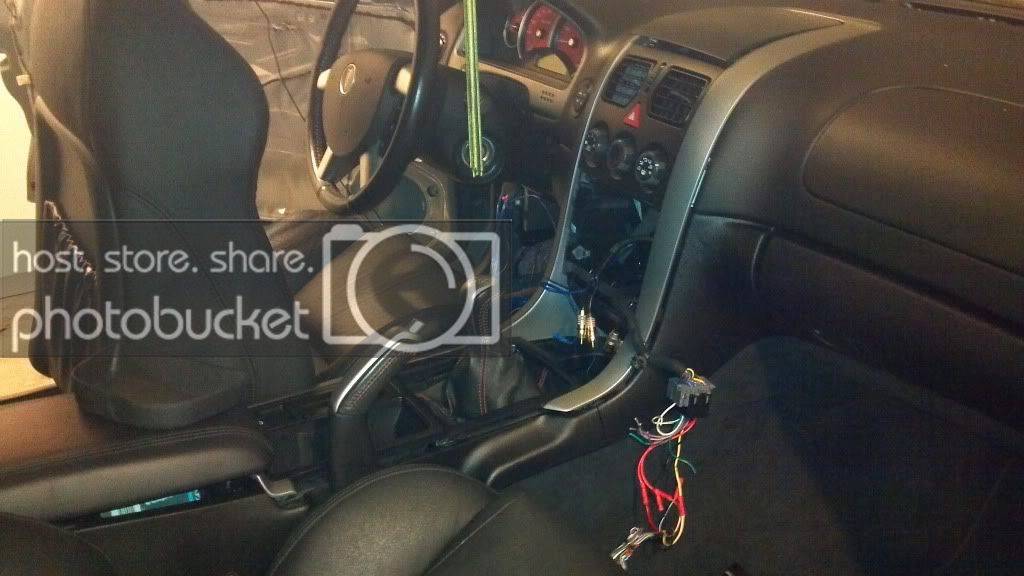

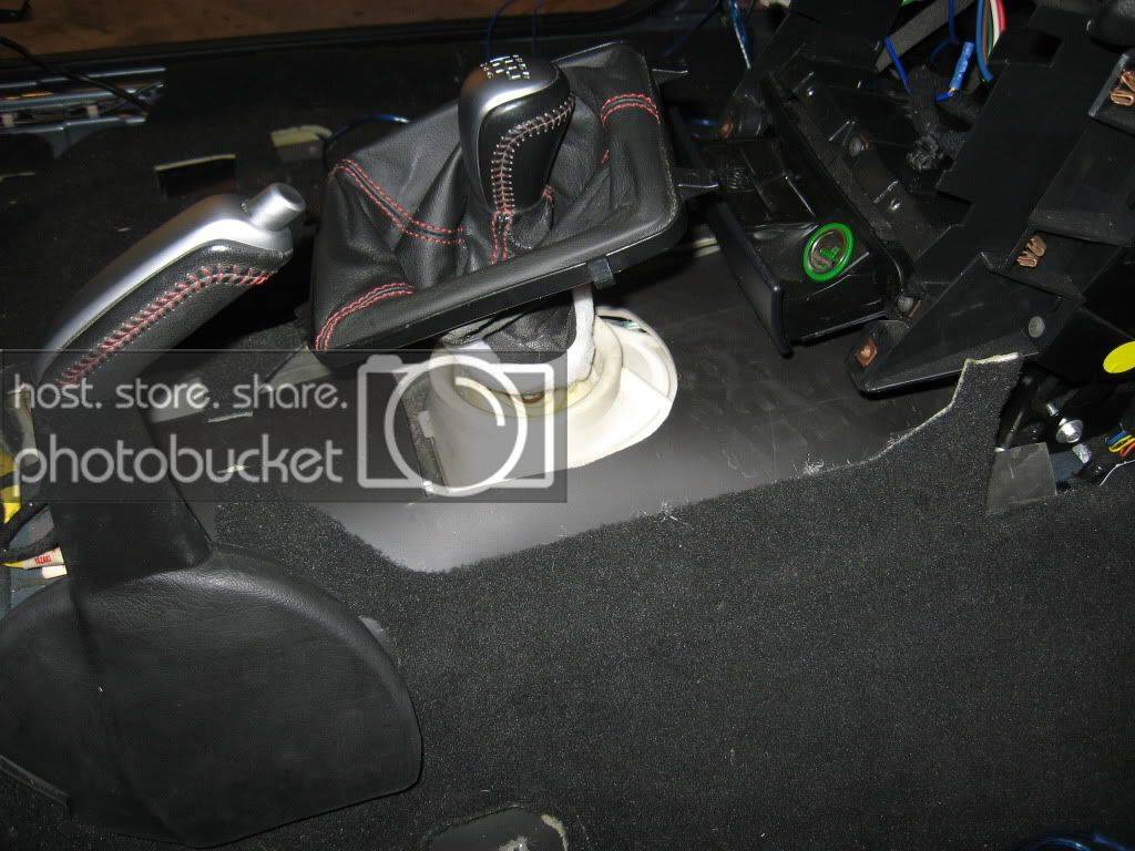

Also got the center console back in. Overall pretty friggin happy with how it went back together . Every piece that was put in was tapped on to see if it would rattle, if it did then id take it off and put some butyl on it. This is being done with just about everything.

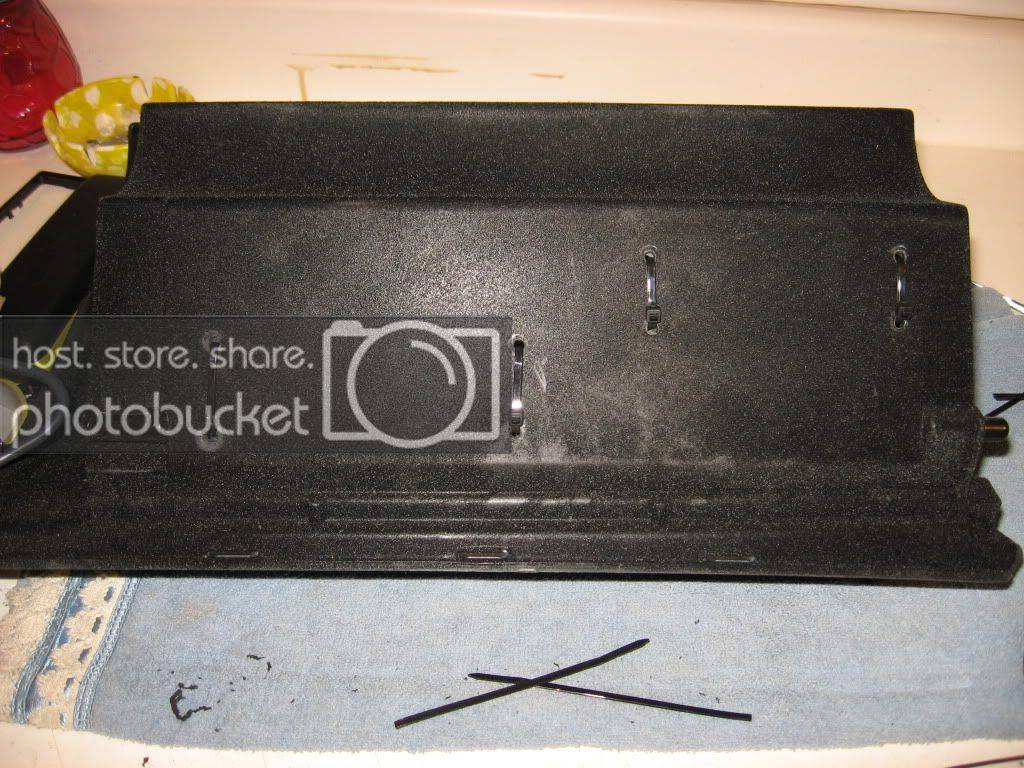

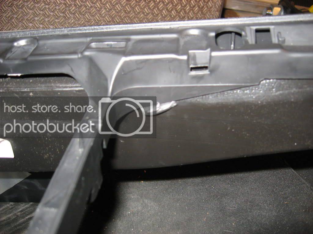

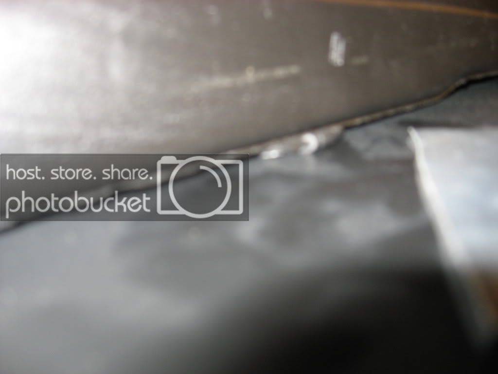

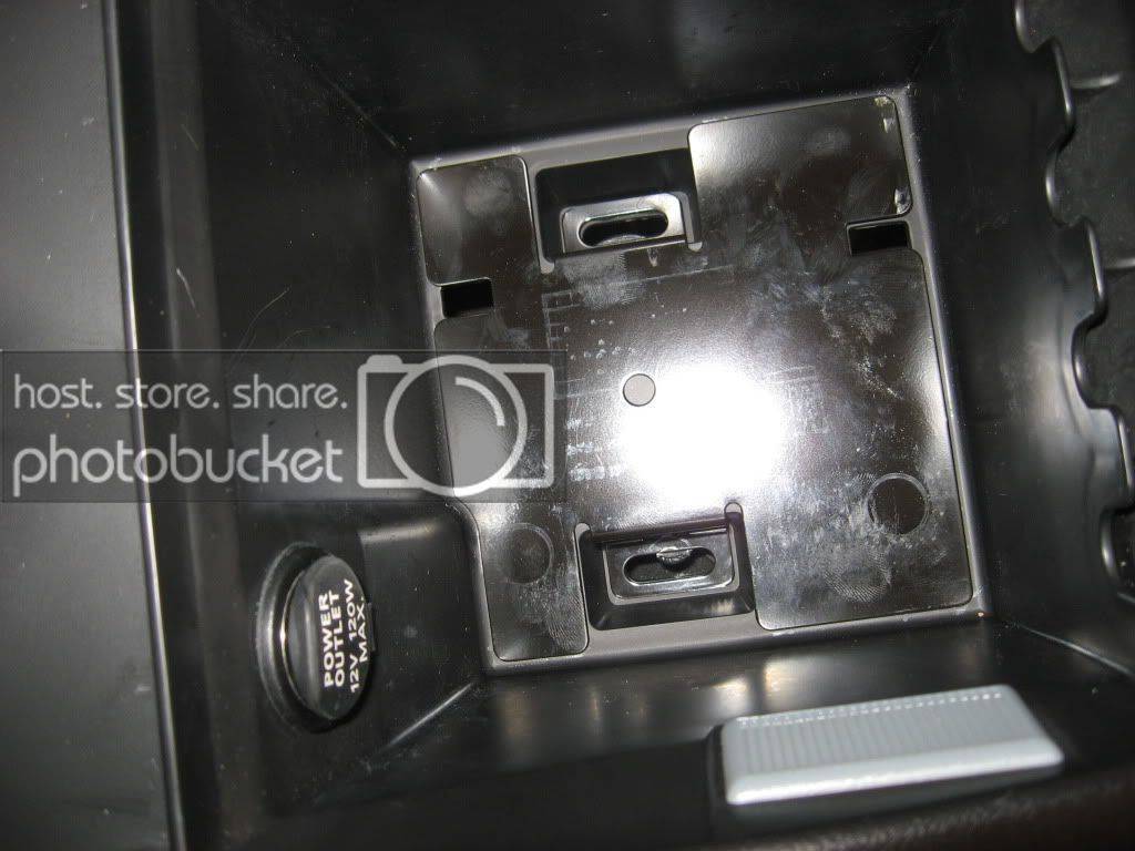

Where it bolts down, they had a steel "cage" to evenly disperse the pressure of the bolts so the plastic wouldnt break. great fuggin idea. Butyl went underneath that
And back in. This is how the car will probably sit for a while. Busy at work and I already have plans for the next few weekends.

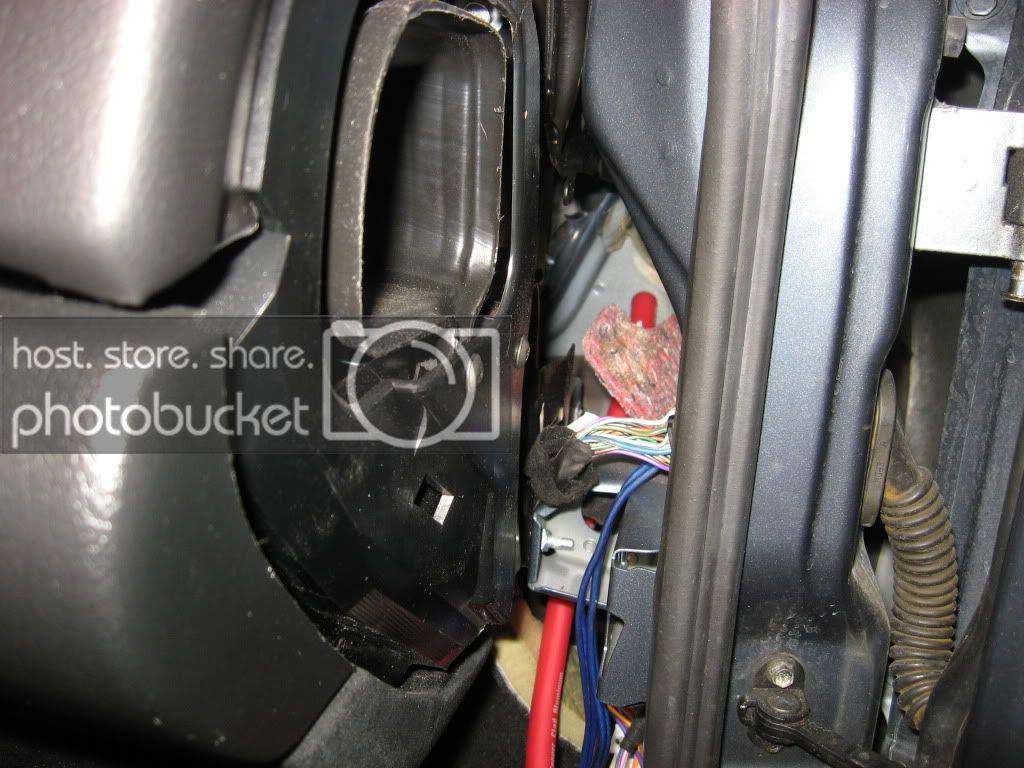

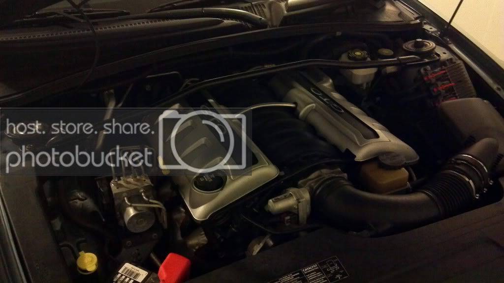

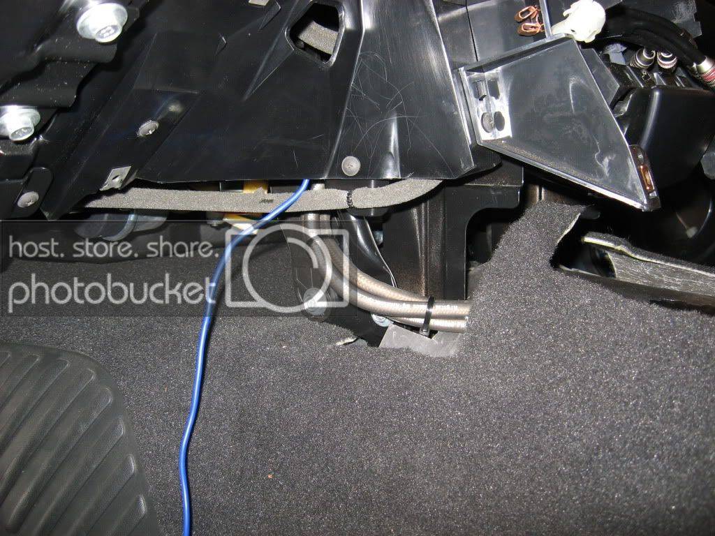

Was able to get the power wire ran through the firewall and my HU, sirius installed. Decided to get sirius since theres times when I get tired of the same old music on CDs and I HATE ipod quality. Plus those songs get old too.
On to the pics

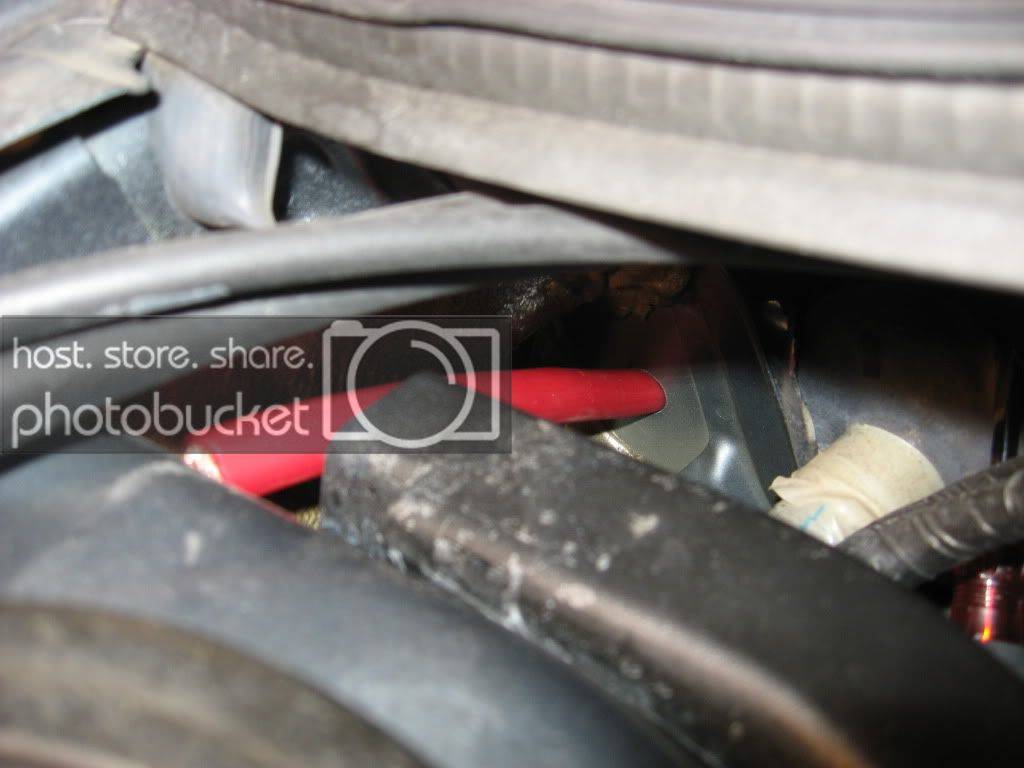

Convenient as hell having a hole here perfectly sized for 1/0
And comes out right near my battery

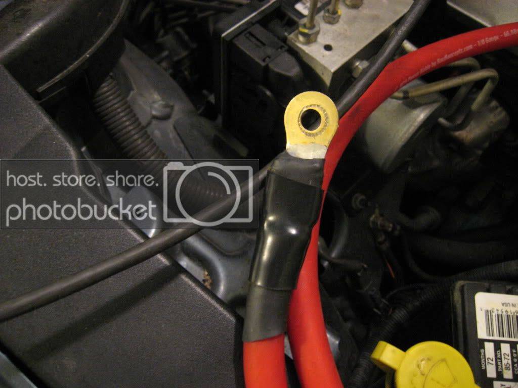

Exterior connection was crimped and soldered with an inductive solderer. Hella nice for large terminals. Followed by heat shrink and then more heatshrink with glue for added durability.

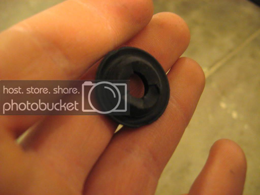

Hacked up the gromet that was filling the original hole
Thats as far as I got, I need to get some black zipties and techflex for under the hood.

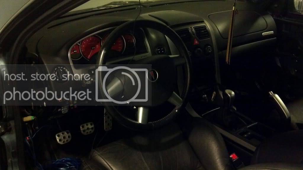

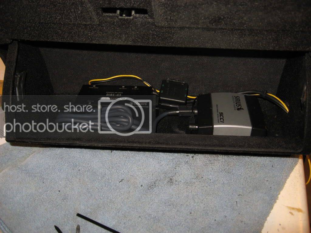

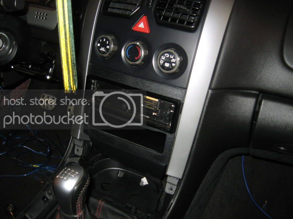

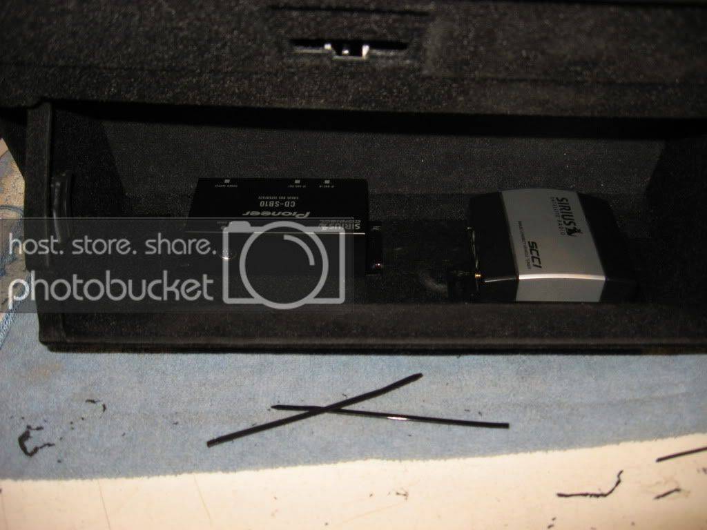

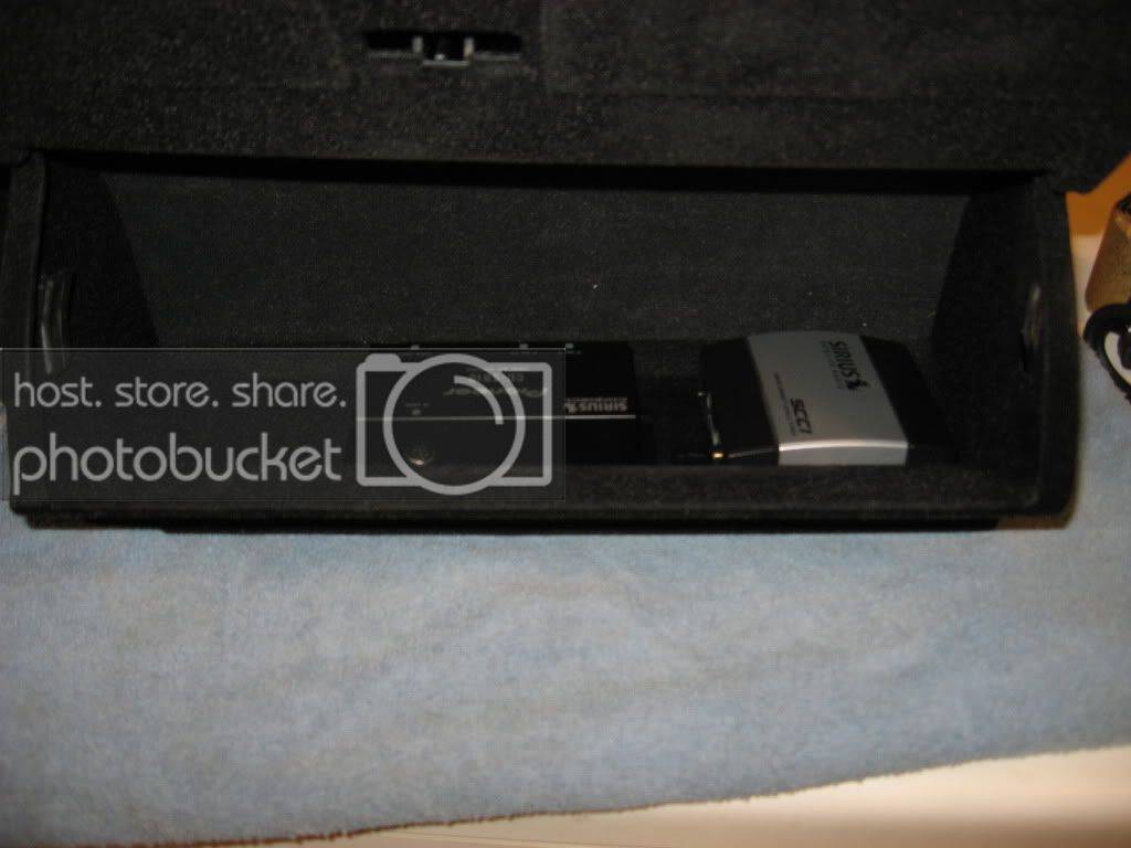

Everything staged. Couldnt find a better spot for the tuner. Dash is pretty compact.
Wires will be cleaned up when I get some techflex

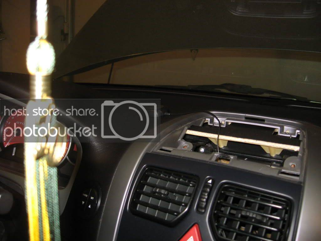

Metra dash kits ftw. Best quality kit Ive ever purchased.
The antenna for sirius will be far up on my dash, dont want to run it through the windshield gasket and risk a leak.

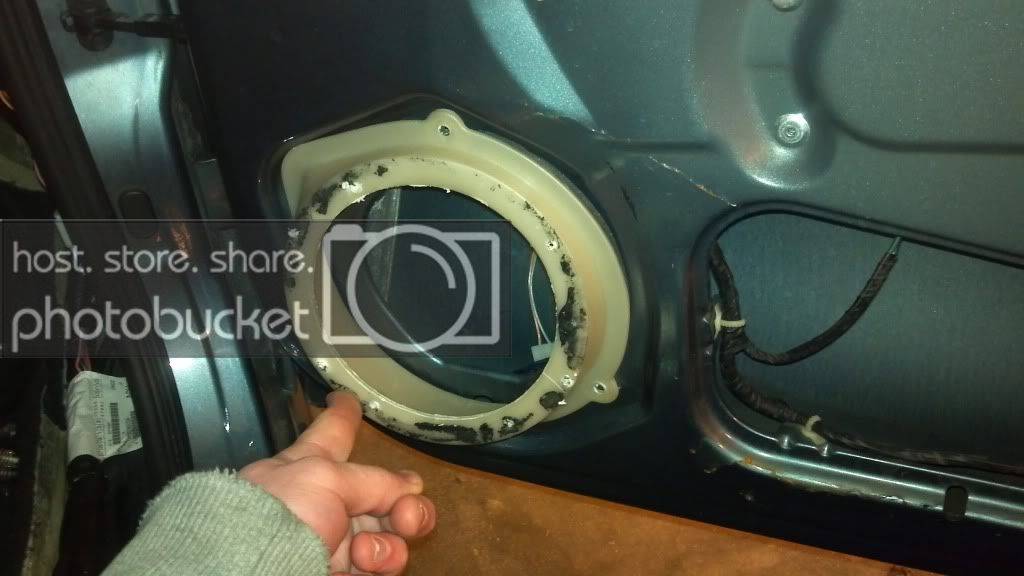

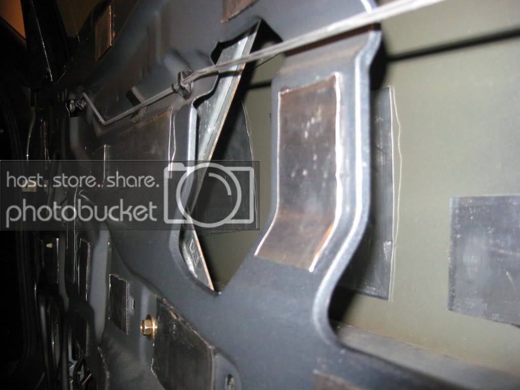

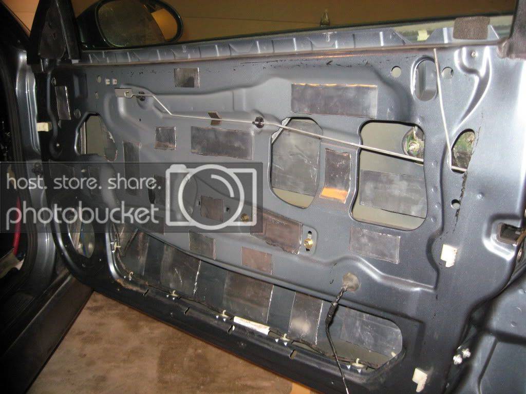

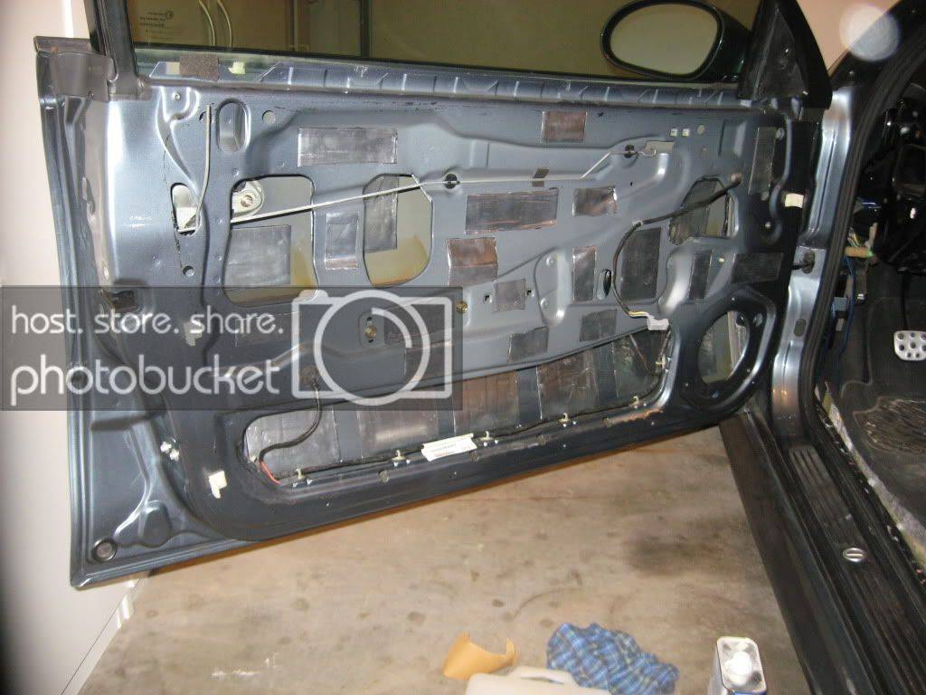

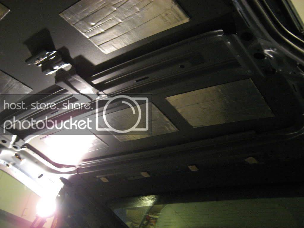

Thanks, I used ~6 sheets per door, give or take 1. I havent covered the access holes yet. I want to do a before and after but I will most likely use sheetmetal, butyl, and sheetmetal screws.
