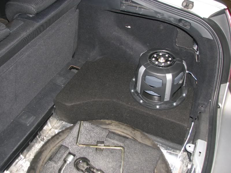

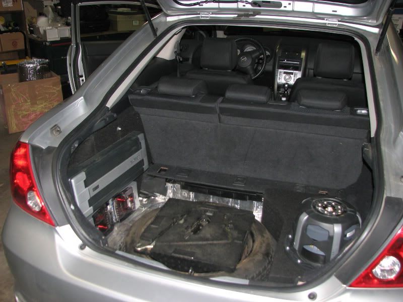

box is in. 3/4" MDF on the top and sides. 1/2" MDF on the bottom. about 4-5 layers of fiberglass on the inside and outside. it's fairly stout. we added CCF on the floor under the fully carpeted box. it is bolted to the floor.
a false floor and beauty panels are next

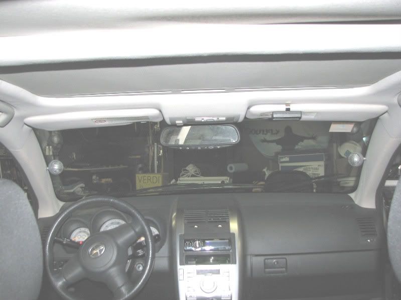

we also raised the tweeter spheres. once we finalize a location we'll finish them off. this additional height was nice, but they are too close to the glass and are brighter now. we'll split the difference and move them down a bit.
the sub is as close to the corner as possible - corner loading was the goal.
it sounds awesome. even though the sub still needs to be broken in.
bass is still perfectly placed in the sound stage. running 63Hz crossover points at 12dB/oct for sub and speakers. everything is very nice.
the end result will have a protective cover for the sub that uses a very open black fabric so not to restrict airflow, but to protect from debris. that magnet is so strong it kept taking the screwdriver out of my hands during install. rubber gaskets are used on both sides of the speaker basket for some decoupling.
box has about 70% fill - a cotton/poly blend was used.

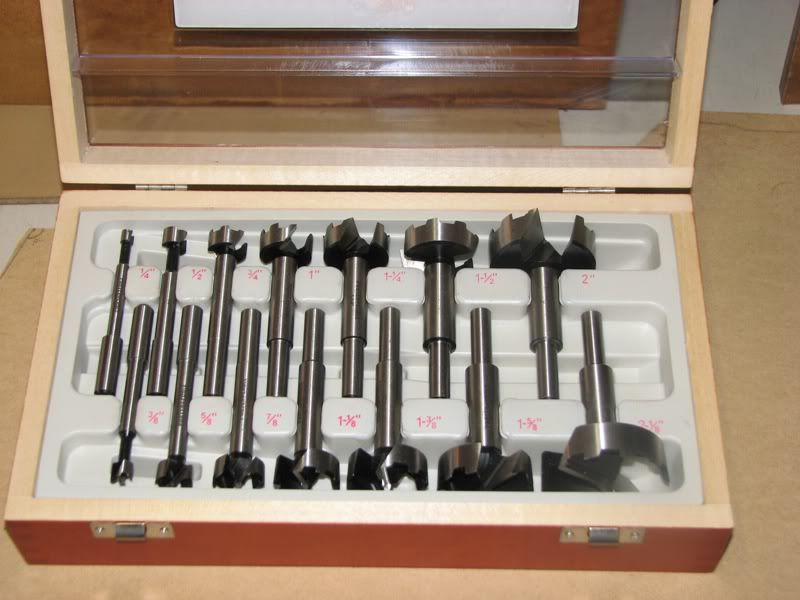

I'm done hollowing out my wooden spheres with hole saws and a router bit for the dremel, and it turned out nice. Which size of the threaded brass did you use? The longest, or the second longest? Also, how did you secure the threaded brass to the spheres? With nuts, or did you just screw them in? These seem to be fine just screwed in after using a 3/8" drill bit. Thanks for any help.
Yeah I screwed and wood glued it and it turned out fine. As far as the forstner bits, the ones around here at lowes and HD didn't have the ends that fit in a drill like the hole saws. It looked like they were designed to go in a drill press which I don't have. Anyways, sorry if I hijacked your thread, thanks for the help and inspiration to do this.
No hijack, a valid question. I got that kit a Lowes for $50. The largest bit in the set costs $25. Seemed like a deal. But the Irwin kit had a hex end that would be better. A round end is just silly.
