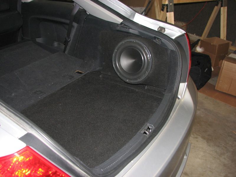

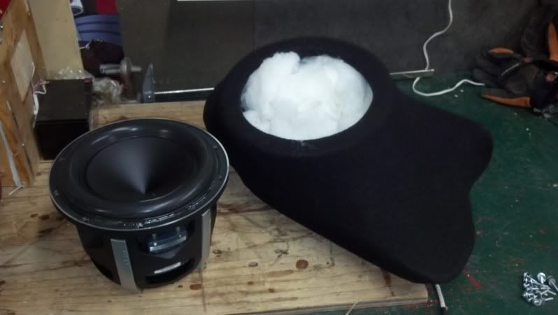

after a long time - we are going to do some finishing touches...

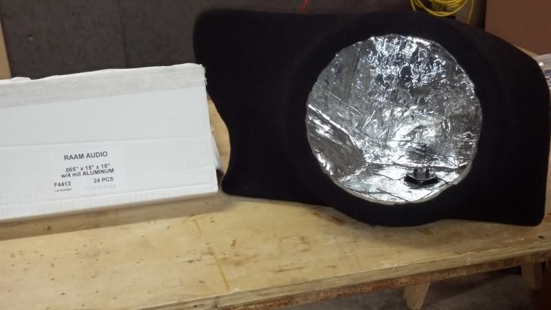

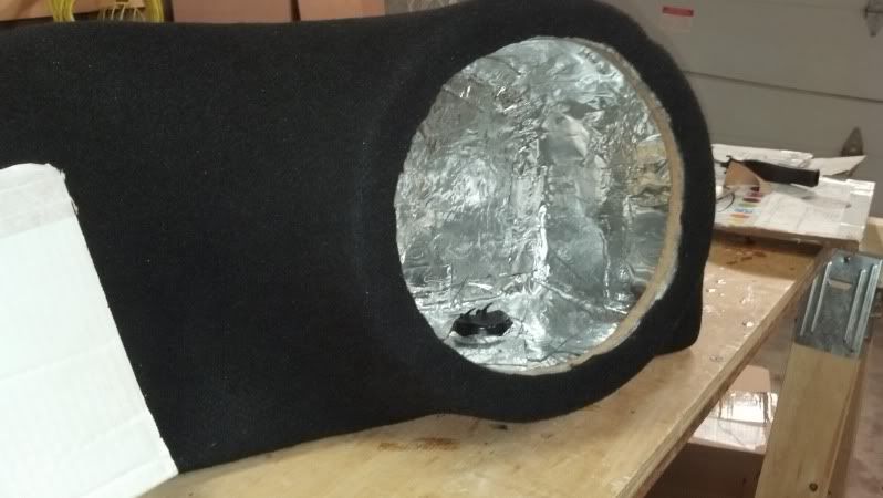

starting with a new enclosure.
fiberglass enclosure (about 1/8" thick) with 4.5 sheets of BXT II inside.
more to come this weekend

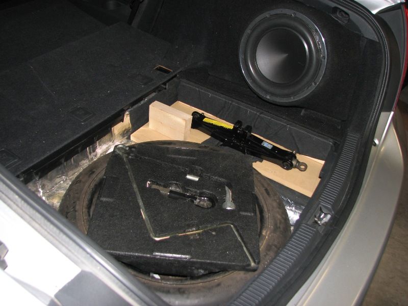

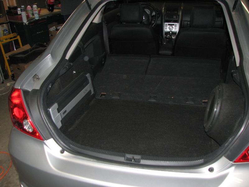

fabricated new supports for the new floor. i had a 3/4" MDF cutout for the box that we used as an original template. to that i added 2x4's and 4x4's for support of the floor seam and the box. box has multiple secure points (not shown on purpose). it won't move.
the new floor has layers of 1/8" CCF on the bottom and rests on the factory support points as well as some new points.

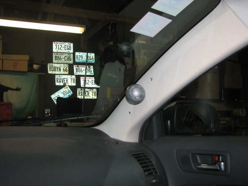

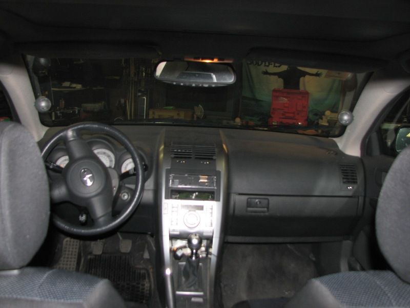

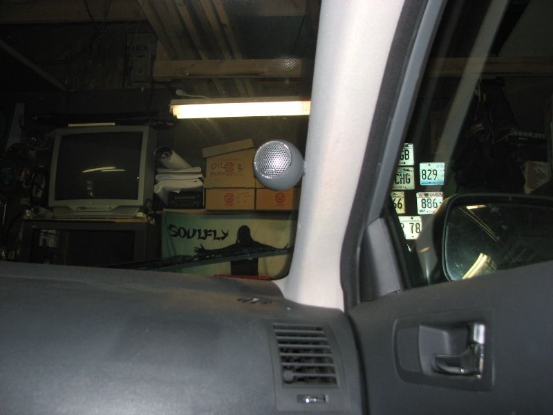

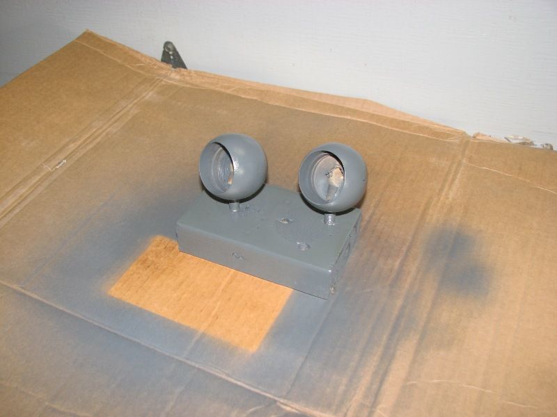

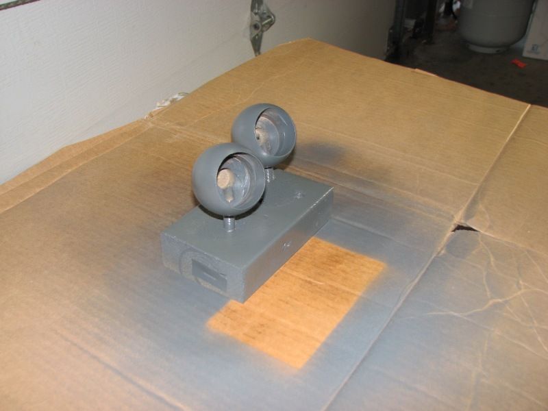

also new tweeter spheres

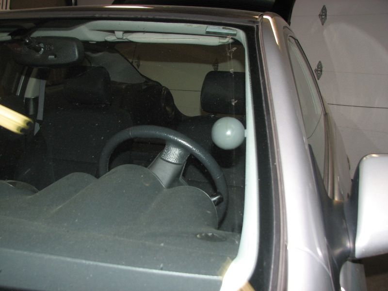

we move the tweeters closer to the apillar for a better look. change the angles, image is perfect.
a sub grill is on order (matching Mille grill is cast metal).
sorry for the blurry tweeter pics. we will recover the apillars to hide the other holes. as you can see, we are experimenting with height and we are done changing. we have new fabric to recover, but ran out of time this weekend.
