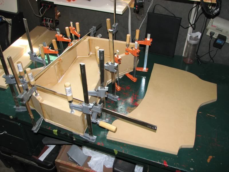

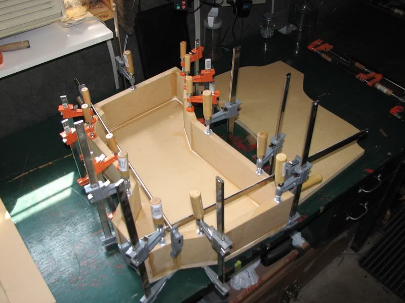

more progress on enclosure.

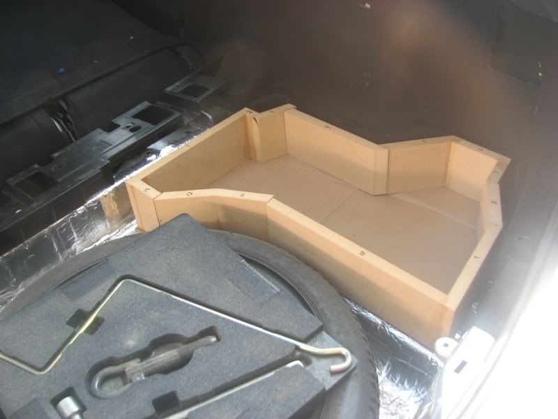

how it fits:
top glued to sides. the bottom will be FG to save height. we have a few boxes from US Composites. the new floor will be right between the amp and crossovers. this is why we saved height with FG.

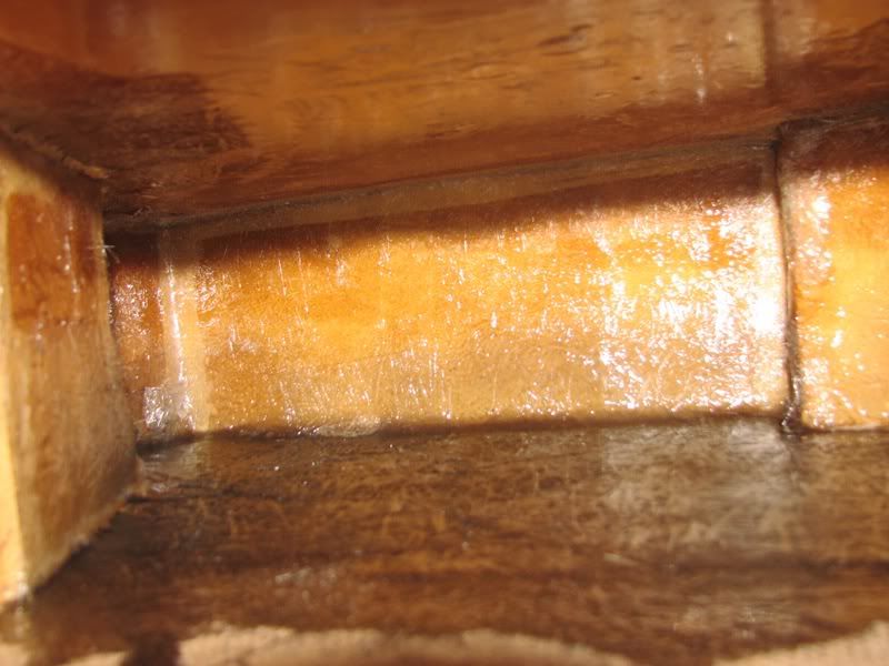

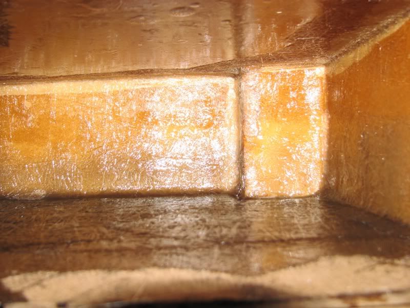

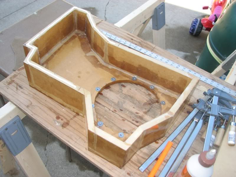

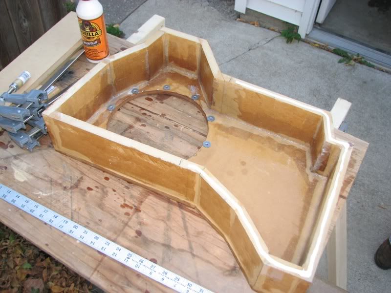

making progress on the enclosure. we are using 1/8" board on the bottom to save height. doing fiberglass layers for strength. today i put 6-7 layers on the bottom and 5-6 layers along the seams. did half the bottom so i could reach in for this first step.
next we will put in interior braces and glass them in place. then we'll put 6-7 layers on the outside. then we'll do a layer of BXT II, then a layer of foam, then bolt down to the floor of the scion from the inside.
resin used is US Composites B440, 3/4oz matte.
the sub will be inverted so i rounded the entrance to clear the surround of the Hertz ML2500.
still wet:

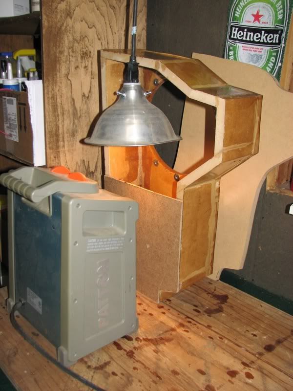

curing right now
i will say that having a roller for the fiberglass helped keep the bottom nice and flat.
and using respirators was great. couldn't even smell it despite hovering over it.
