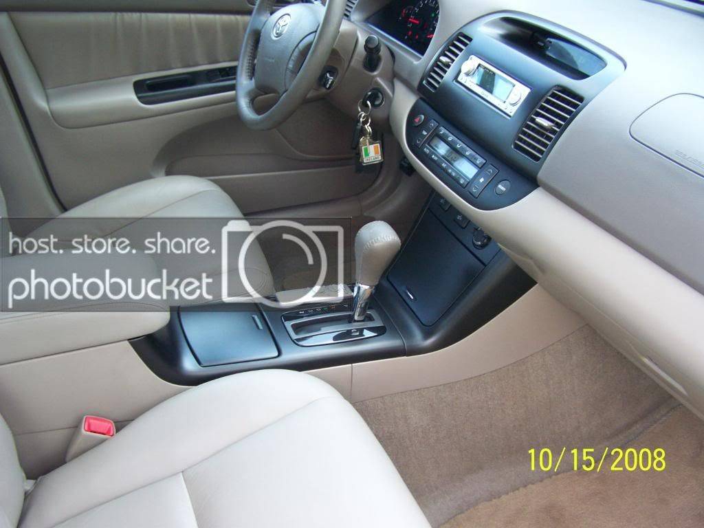

ramos, I'm pretty certain that pic you posted is an 03 and up camry, not corolla. Corolla's dash's are diff.
As far as installing the radio, you won't be able to until the kit comes in. Mounting using the trim sleeve is fine. Make sure you snap the top/bottom tabs on that kit into the dash panel.
ok. i have the HU all hooked up and its working good. i have it just laying in the open gap. the kit should be here sometime early next week.
06' camry. I have done a few corolla's as well. The camry kit is very similar to the corolla kit, just upside down. I just don't like cage mounting. I'm old and set in my ways lol //content.invisioncic.com/y282845/emoticons/smile.gif.1ebc41e1811405b213edfc4622c41e27.gif
