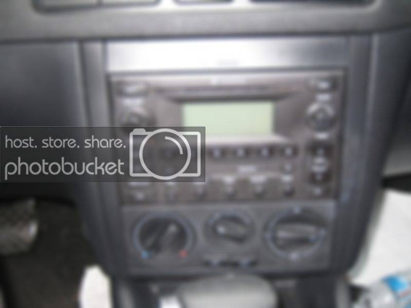

But it seems with this stock crap right here

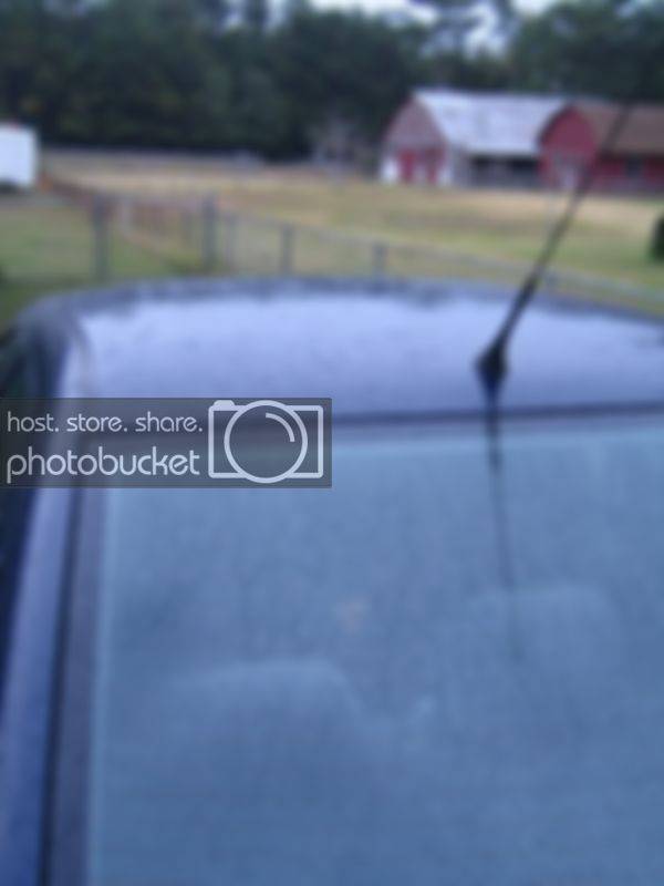

and this antenna gayness
Its gonna ****.
Read rumors about the monsoon amplifier splitting all types of voltages and stuff. And that you need like a $50 adapter for the antenna to work with an aftermarket head unit because of its signal amplification.

remove the stereo, tuck the harness somewhere (there is no sense wire) and run your own power and ground. there is a distrobution block above the break pedal with ring terminal type connections on it. use a multimeter, turn can on and test for 12v (and rev the engine to see if it changes just in case) turn it off, and test the ones that read 12~14 volts. find one that turns off, i want to say its the one on the far right hand side. connect +12v to your yellow headunit wire, and the switched (car off 0v car on 12v) to the red wire on your headunit, and ground the black wire.
all done.

does not matter. disregard ANY stock wiring and run all new stuff yourself.
dont even bother trying to figure out the stock electrical.
the people who have problems want to use the stock amp with the system, or at least the stock wires. totally bypass everything. run your own wires.

And your antenna adapter is like $12, you should not need the powered version

Yes, the antenna adapter is a little more expensive than most cars but if you search online you can find them cheaper. Best Buy probably won't charge you for the adapter because they won't use it, and then tell you that your antenna must be busted when your radio doesn't work.
