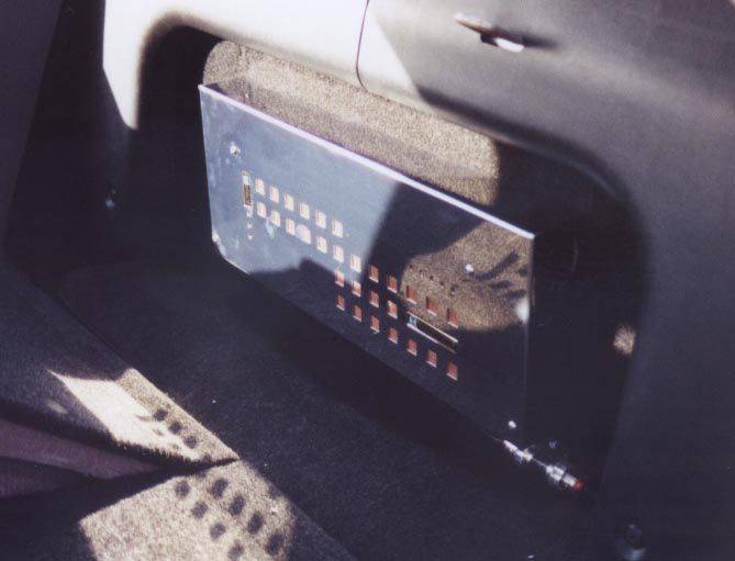

My wife has driven Camrys most of her adult life. 1994, 1998, and currently a 2002. Her dad bought one every 4 years and it was handed down to her each time. The 1998 got a system that consisted of an Alpine HU (deadhead), xtant 403a, Massive Audio CK6 (1999 version), and a Vega124 sub.
the 2002 has had an Alpine HU of some sort, it changes a lot because i use her car as a home for temporary head units that i'm not running.

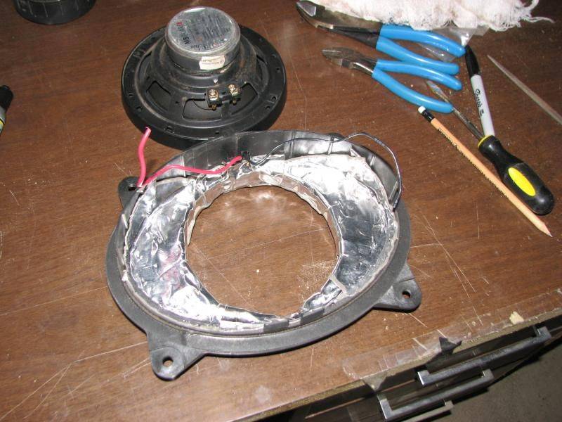

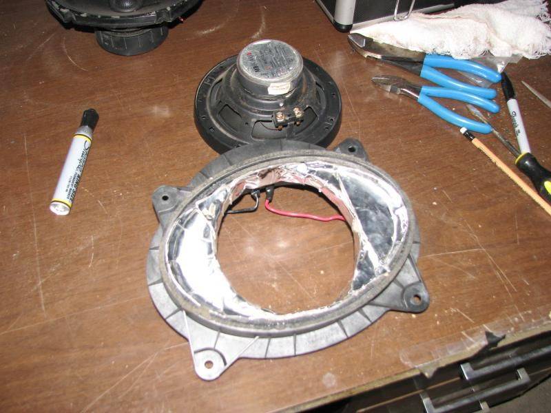

Stock 6x9's were replaced with Eclipse point source 5x7's that used a hacked-up factory mount (you'll see below). stock 2" stayed in the dash. amps were added but it never lived up to my standards. time to change that.

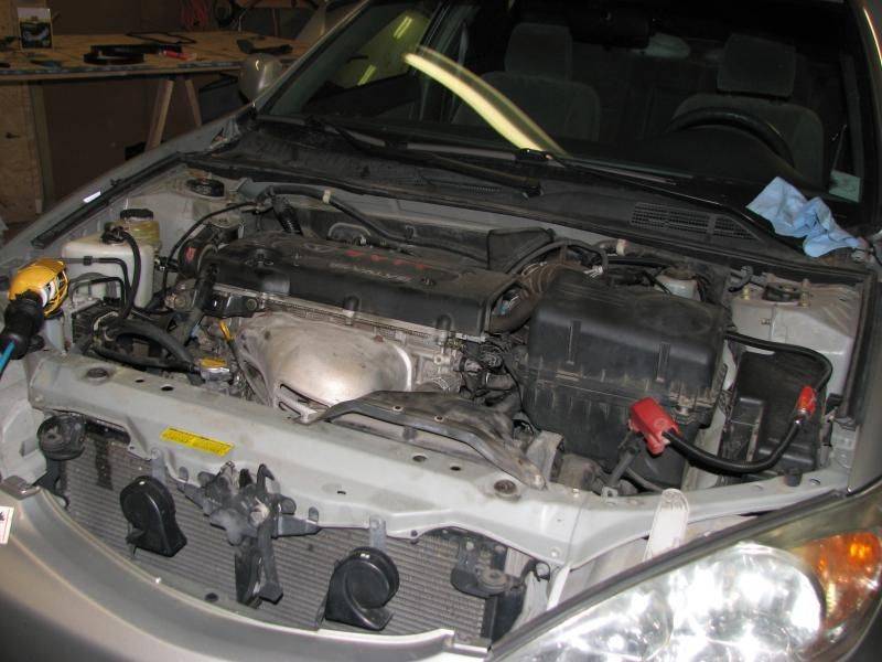

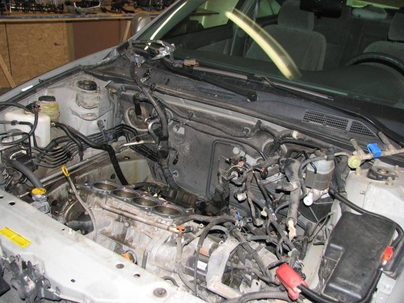

i delayed a more involved system because of the head bolt problem i knew would surface. i've recently fixed that:

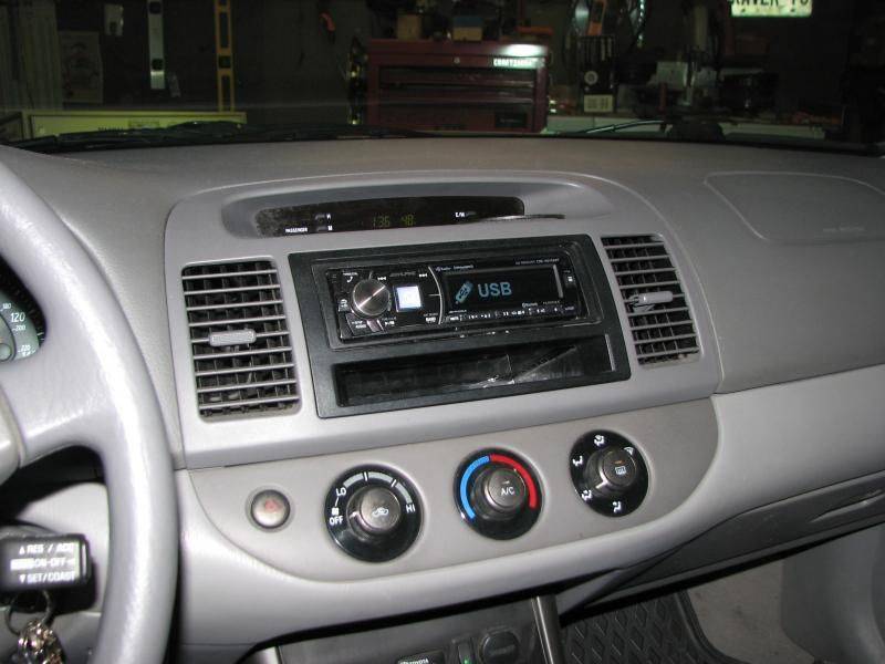

Now it has an Alpine CDE-HD149BT at the front that will stay.

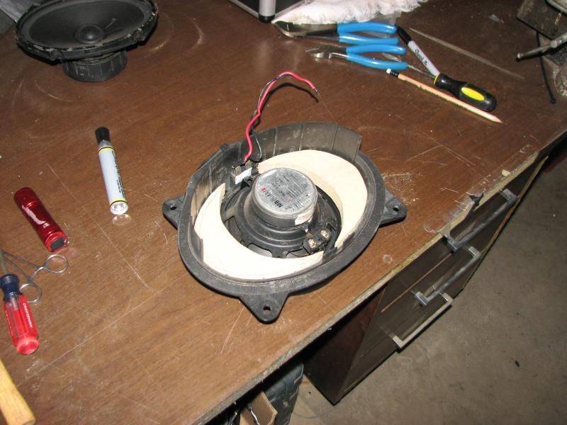

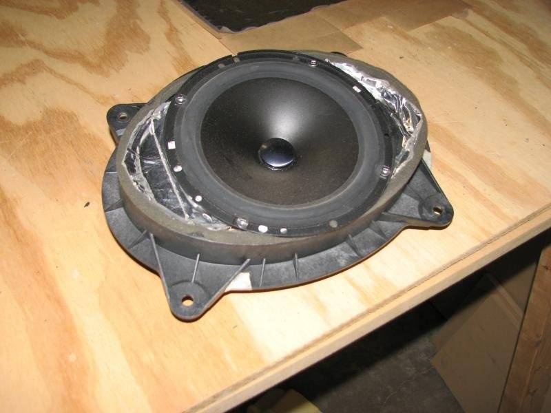

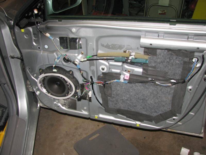

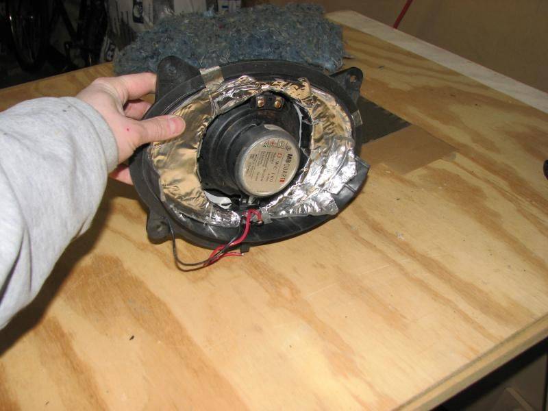

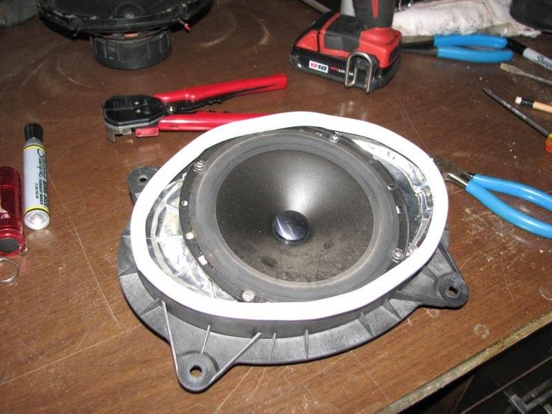

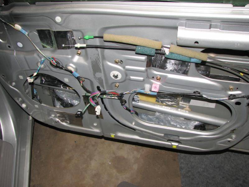

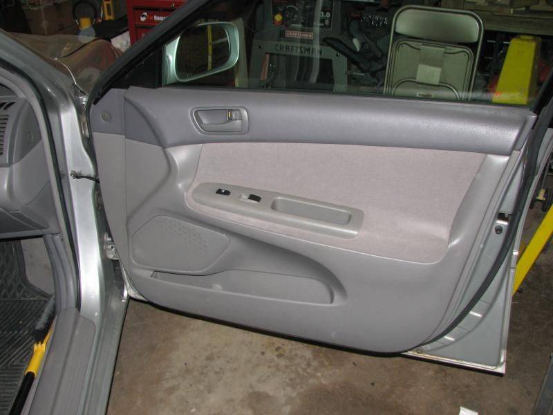

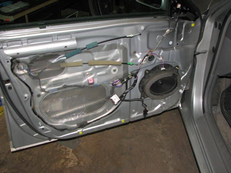

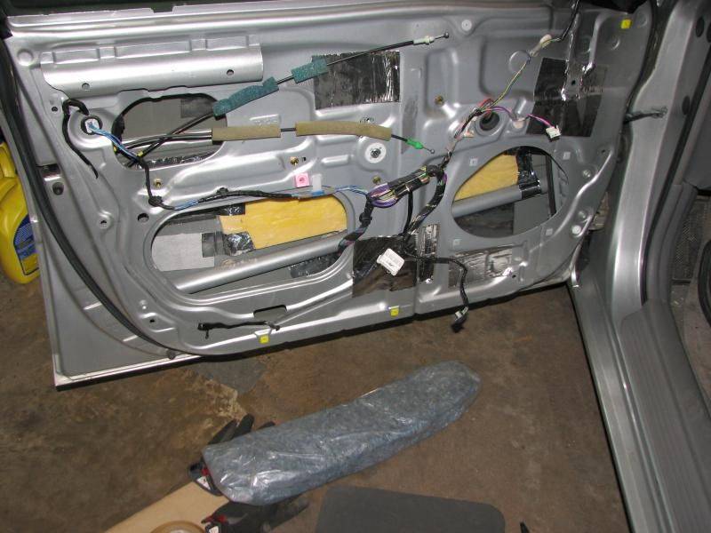

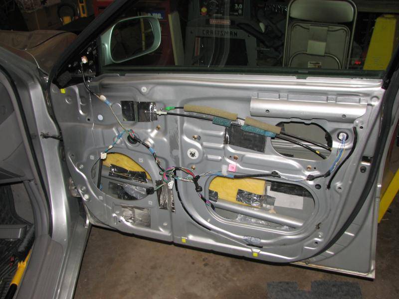

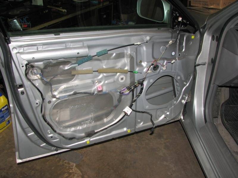

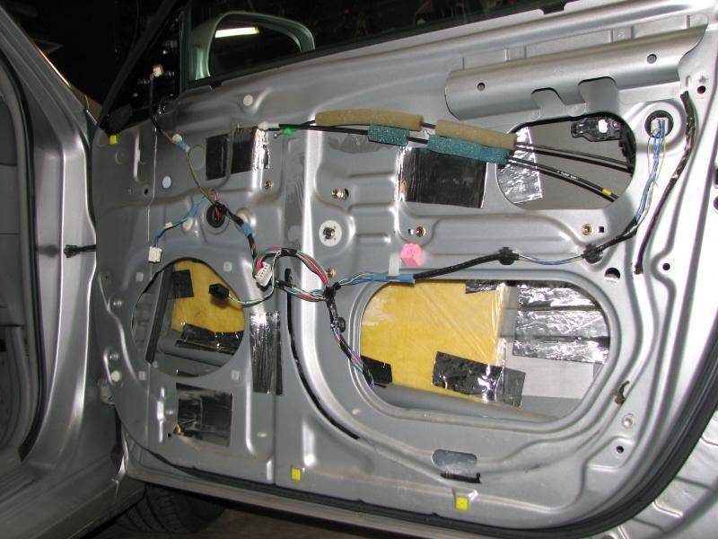

Last night i took to the front doors. we'll start there.

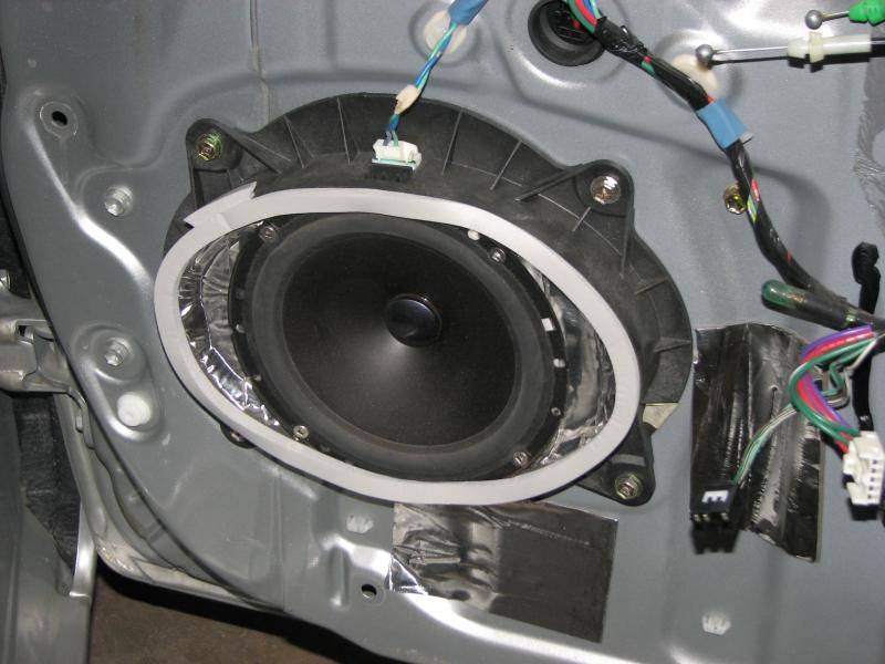

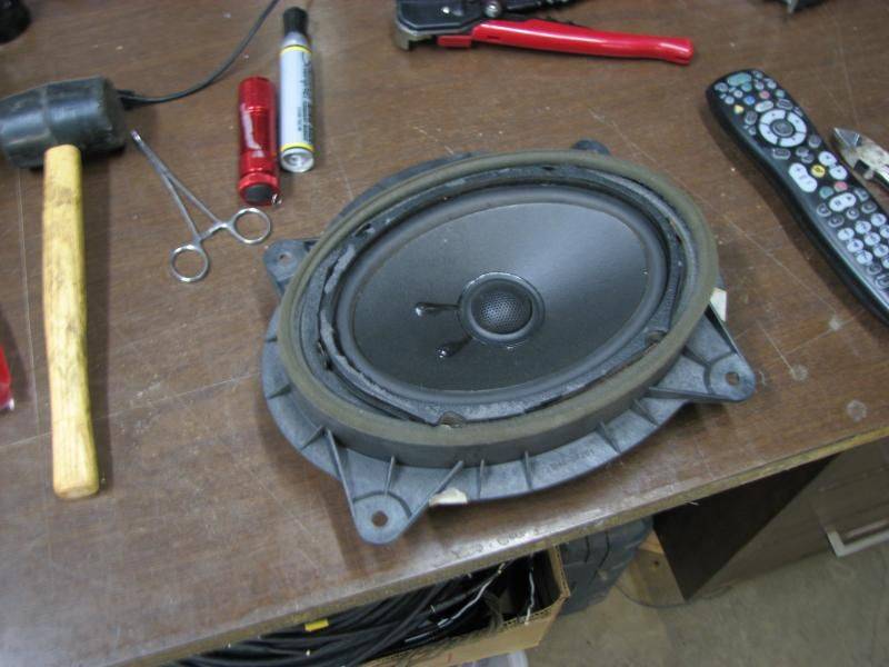

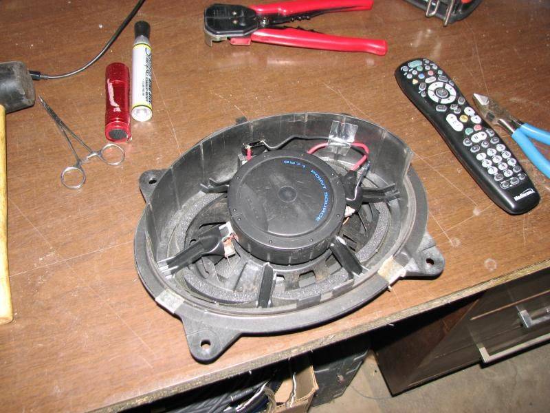

stock with the Eclipse

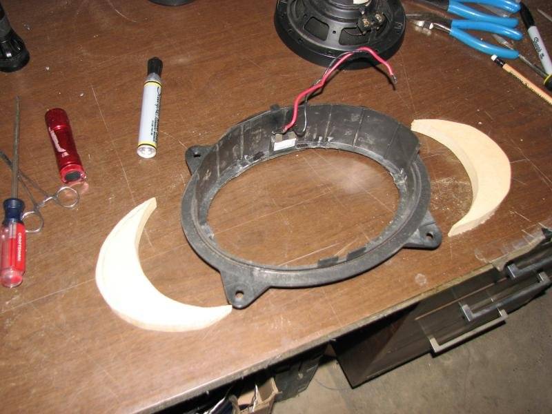

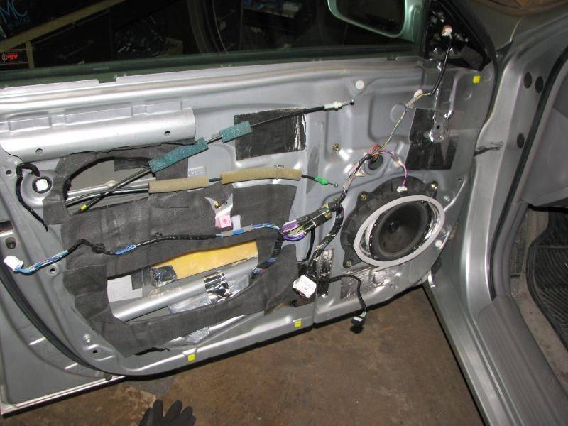

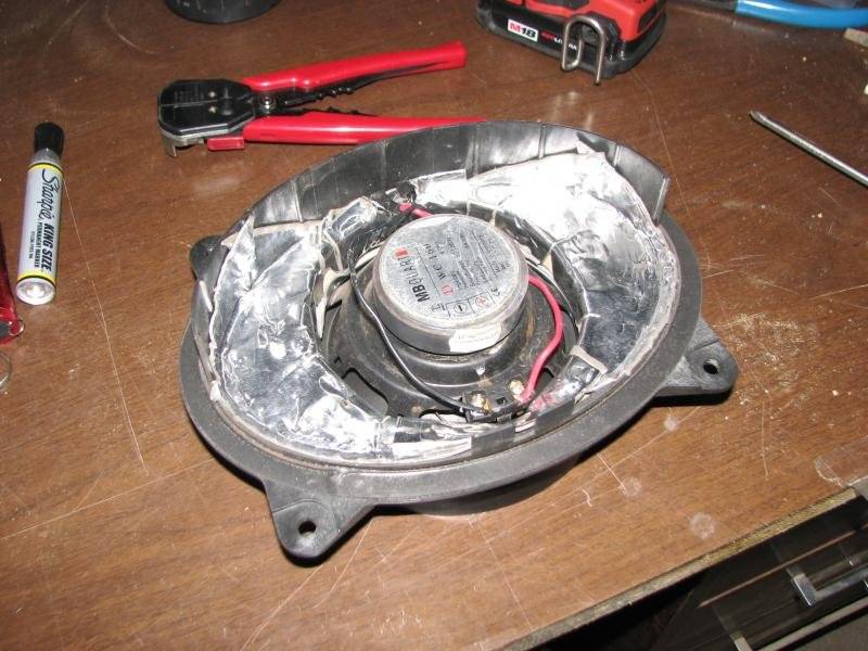

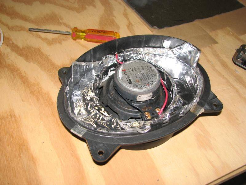

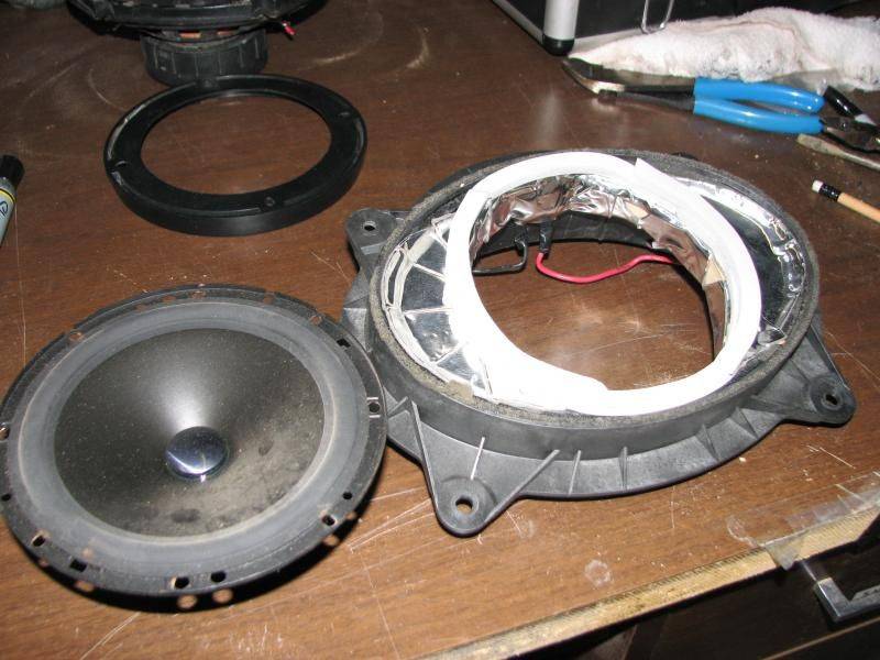

factory mount mates perfectly with the door and is odd enough i reused it. cut 3/4" MDF (quickly with a jig saw because it was just filler)
BXT II

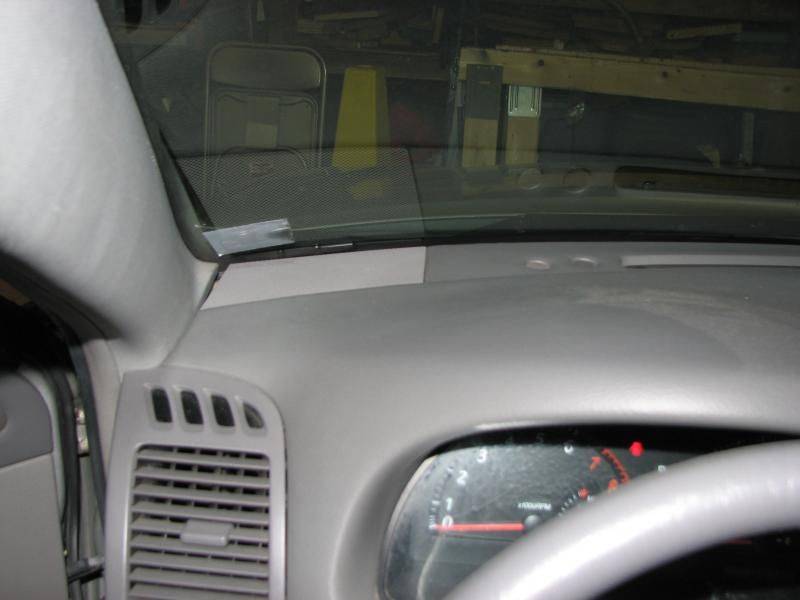

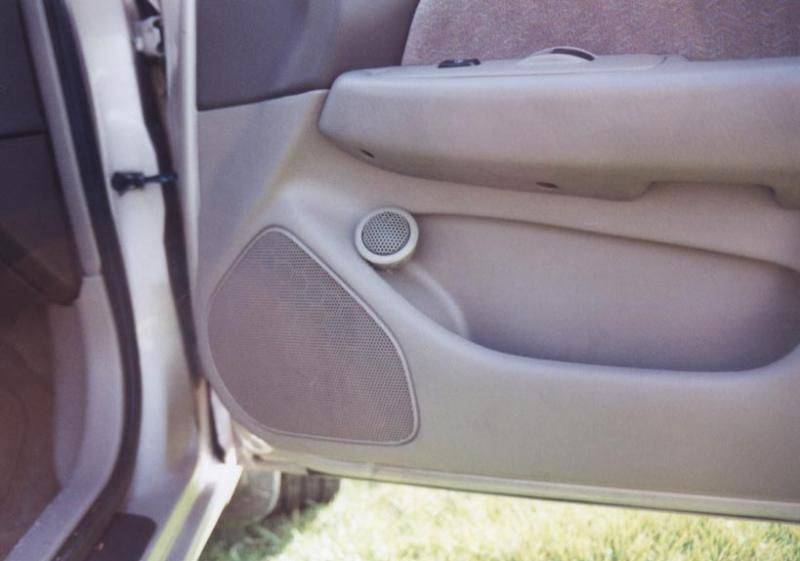

Hey how do you like the tweeters in the dash? I have that same camry and I move the tweeters higher on my a pillars and I enjoy them much more. Will you add subs to this build?
they work fine in the dash. they are behind the factory grills which pretty much direct sound up and not back - so i only hear reflections.
i've done plenty of a-pillar tweeter builds using both pods and spheres. some tweeters are better suited than others.

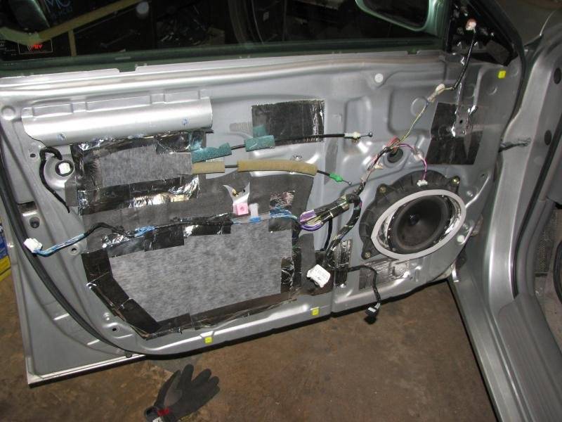

This install still surprises me with how much midbass the front doors have. It sounds very good without a sub and doesn't need a sub. The soundstage is pretty good for stock locations, the Alpine HU gives enough tuning flexibility to let me dial in a good stage.
I still need to replace the rears with the matching MB Quart 6.5" coax. The carpet is out currently and I may run the components active and add another 4 channel that can be used with an IB 12" sub for the lower octave.
