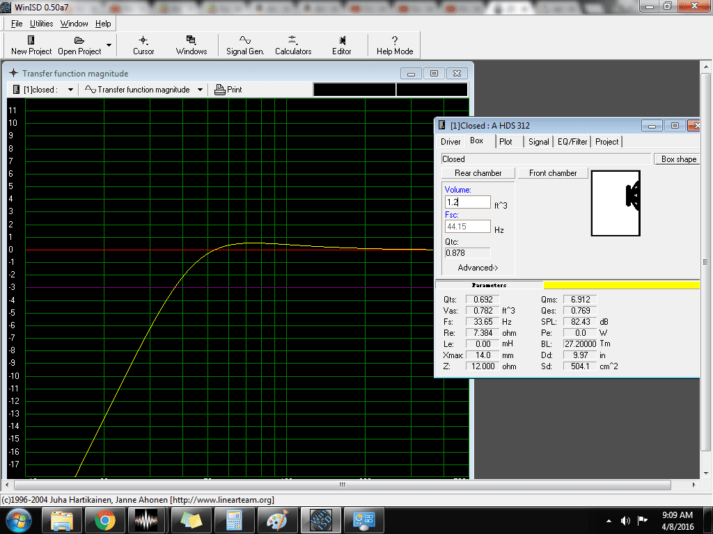

read the 4th order thread link from CACO i posted. exo has a 4th tutorial too. Winisd helps a lot as well, model the sub in a sealed box, get the FSC which should be around 45 to 50 adjust to taste and tune the port length as close to FS of the sealed box for most output efficiency while the sealed to port ratio will determine your bandwidth. look for subs with a low EBP
So here around 43-45 hz tuning is fine.
