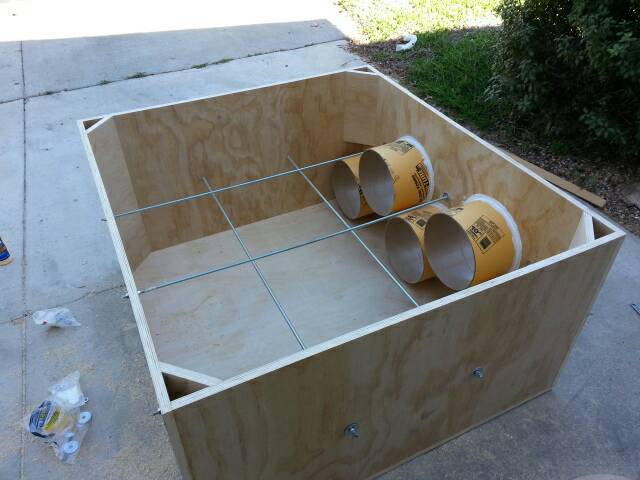

just remember to put a nut washer and lock washer on both sides of each plain. once you get the nut tight on the inside get the nut tight on the outside. tighten the outside and inside at the same time..

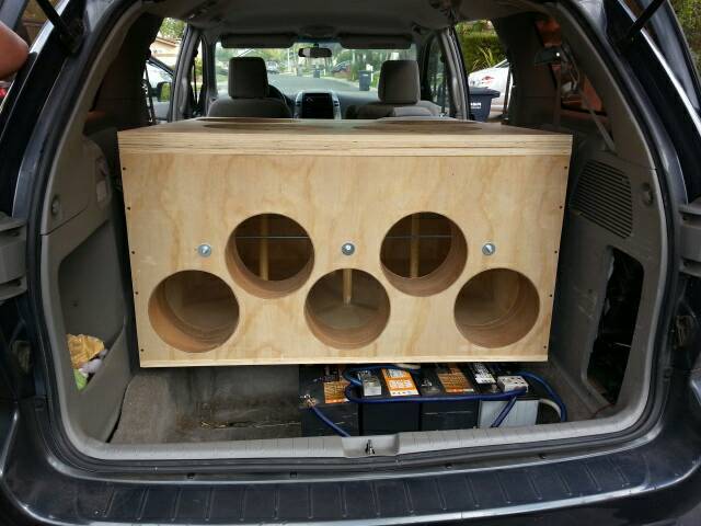

With a lot of help we just finished Jeffdachefs new box for his 4 hdc318's. The all thread takes nearly no displacement and this box is solid af. Has variable tuning for testing before a final decision on tuning.

That is a very **** box sir I hope everything goes well and I would want to hear the Bish lol I know it'll get loud for sure!
i like to coat my sonotubes with FB resin.. they are ALOT harder..
Yeah there's a lot more work to do to the box. We are just working on the best tuning atm. With 3 of the sonos at 36.5hz this box bangs at 19hz lol.
