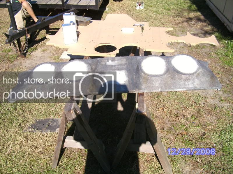

there will be alot of false decking to might start on that tommorrow...also we are just gunna do a regular ported box for the 2 15 btl's

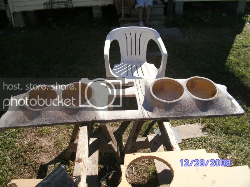

thanks man...i will post pictures in a little while ...on how some of the trim came out...i painted the panel black them put some of this texture stuff on there i love the way it came out...i am also gunna add some blue LED's later down the road
