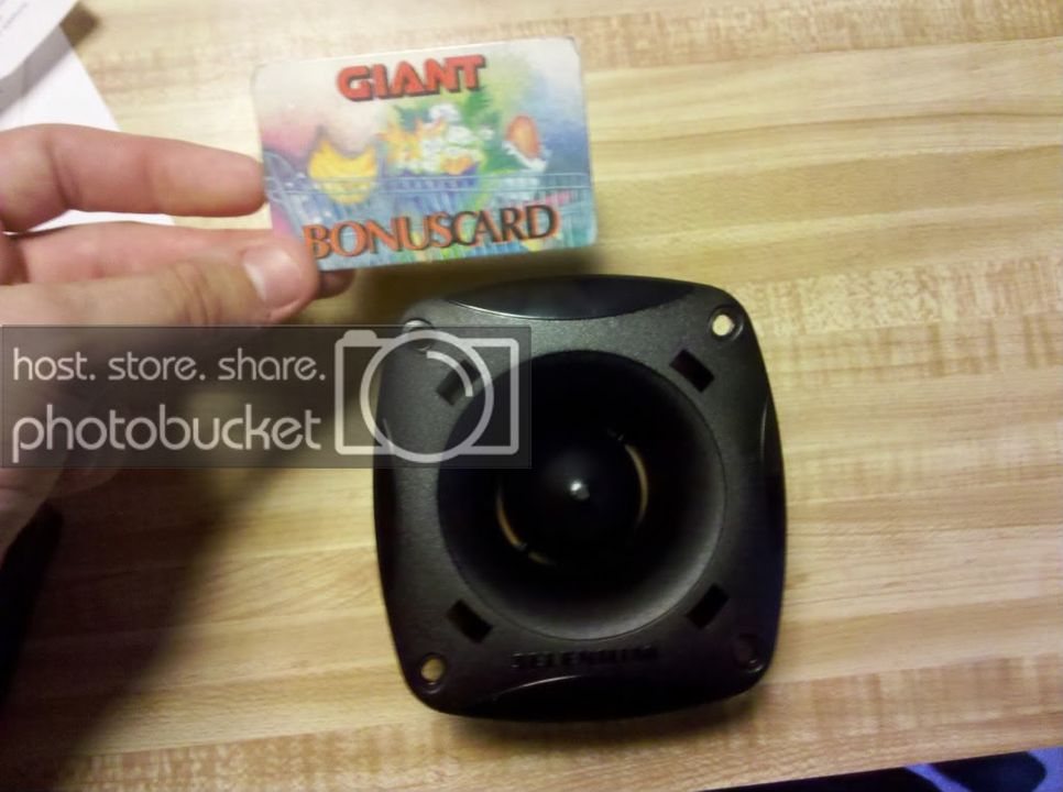

I saw the specs. I figured I could just trim the plastic baffle and deal with the rest. Little did I know the friggin magnet itself is like 4" wide. And the plastic baffle essentially goes all the way back to be flush with the magnet for some odd reason.

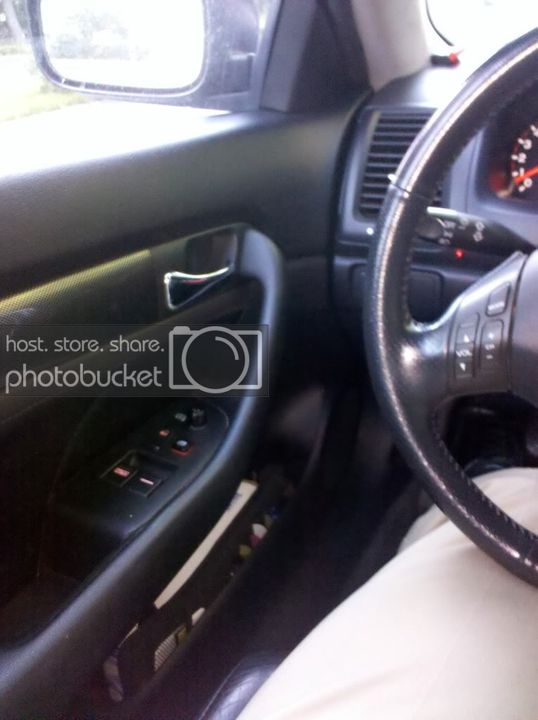

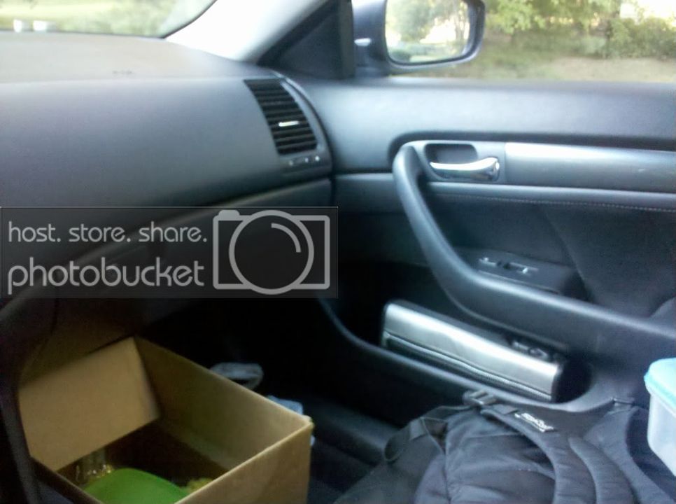

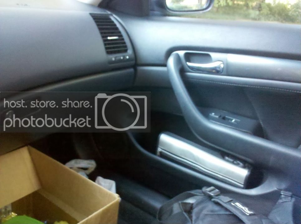

I know I could fit these...ive done a custom glass job on my old blazer for a set of comps, but i reeeally didnt want to go chopping up my door panels in my accord, its still in pretty decent shape, so looking relatively stock is kinda important. Kicks are out of the question given the size of these. The drivers side kick has a hood release in the middle of it. And even if I could squeeze them in, I'm almost positive they'd interfere with me shifting. Despite all this, I still considered custom door panels, but on the way home I realized that Id need to invest a good chunk of $$$ for MDF, glass/resin, sandpaper, paint/leather, etc. It basically defeats the purpose of me buying cheap drivers in the first place. I'm thinking I should find some smaller tweets now, either car audio tweets, or reasonably sized PA tweets. I can save these for a bookshelf set or a custom ghetto-rigged tailgate setup for VT football games lol.
Here's the ST200 and what I have to work with in my car in terms of placement...
ST200 with standard credit card sized Giant card for comparison

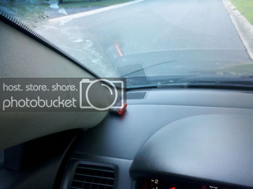

Stock tweet location in dash. Anyone know what that red thing is? Ive had my car for over 3 years and I still dont know. It lights up in alternating red LEDs when I press the clutch (picture nightrider). Im thinking some aftermarket ricer thing from the previous owner, but I'm not into that scene, so I'm ignorant to the hardware involved.

Passenger side

I think you could make a pod next to the mid in the pocket pretty easy that if done right would not have to buy any leather or such.
As for the thing on your dash it is a DEI LED device for an alarm.
I think you could make a pod next to the mid in the pocket pretty easy that if done right would not have to buy any leather or such.As for the thing on your dash it is a DEI LED device for an alarm.
ah, ok. The car DOES have an alarm, so that makes sense. but why on earth does it only light up when i press the clutch?
as for those pods, i think id still have to hack the panels to get those monsters in there. i dont think i could even throw them in there as is without ANY box lol. also, my big-*** leg is out of the way for the pick. in its natural position it totally blocks the path to the ear unless i were to mount it sortof above the mid.
