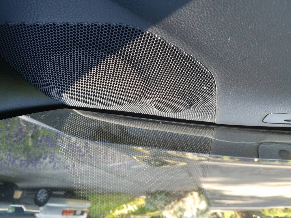

I've got a Scion FR-S and desperately need to change the audio. Did I mention I'm a complete newbie? Except I know not to go to Best Buy.
The Scion has 6.5's in the lower doors, a 4 and a 1.5, both on the dash. Then it's got 4's in the back behind the b-pillar and I've heard to ditch those too.
Anyway, I've gotten advice to get 3 components since I have stock room. Also I've gotten advice to drop the 4's and go 2 way, then giving me mumbo jumbo I didn't understand.
2-2.5k
What do you guys think?

Assuming your goal is Sound Quality... here are my personal recommendations:
Pioneer 80PRS Headunit
Helix DSP
Scanspeak Classic 6.5" Crossed at 80//1khz
If you can fit them the Tang Band W4 Bamboo 4" Midrange crossed at 1khz//3khz (they can be crossed lower if you want as well)
Almost any soft dome tweeter that fits in your location should blend well
Keep the rear stock and fade them so you bring the front stage forward.
I'm assuming the 2-2.5k is a budget possibly?
I don't think you need to spend nearly that much to get great sound.
Probably the most important piece to the equation is properly treating your doors ~ deadening, foam, sealing all gaps, etc.
What else will you upgrade? Don't go to fewer speakers if the factory radio and amplifier will stay. That factory 3-way configuration makes me envious as it has a number of advantages.

...mumbo jumbo. Haha. I was referring to sound acoustics. Things that have to be right to make your car sound good. You can have $2000 in equipment and it will still sound bad if you dont understand the acoustics behind tuning and the advantages of 2 vs 3 way or vice versa. You have stock 3 way. Thats great but you have to add another amp for a 3 way system as well as have a headunit capable of running that many speakers. Guess what. There is only one and its $1200. You can get a headunit thats $240 that will run a 2 way system very well or you can get a external DSP and run a 3 way.
3 way will be more expensive. Harder to install. Need an external dsp, another amp and is another beast to tune.
2 way is cheaper and easier in every way.
