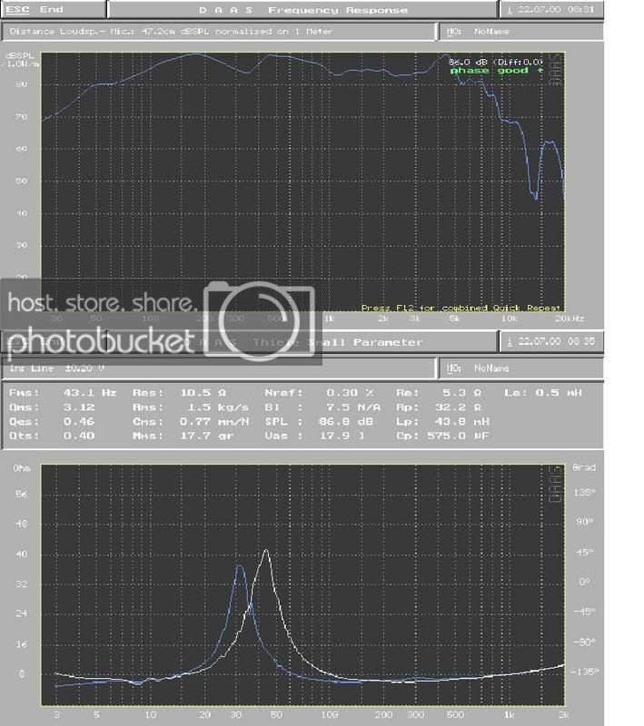

I'm looking at these t/s and drooling a bit:
Qes: .75
Qms: 3.12
Qts: .604
Fs: 49hz
mms: 13.7g
cms: .77mm/N
Re: 1.82 ohms
BL: ~3.2 Tm
Le: 0.1mH
Sd 128 cm^2
Xmax 7mm
RMS Pe: ~125W
The home audio version in the picture has 12 mm of xmax and RMS Pe of 200W.

The 2 ohm design I have is a little more sensitive.
The 4 ohm design I have is about 1dB/w less sensitive but has about 10hz more extension IB and a little more of a peak when in a small sealed kick.
There’s a 2nd higher sensitivity 4 ohm design that’s suited very well for home audio :-D but that’s of less use with the 8 ohm higher excursion version available.
I could get the identical t/s with edge wound coils but that costs more //content.invisioncic.com/y282845/emoticons/wink.gif.608e3ea05f1a9f98611af0861652f8fb.gif so there’s no reason for that...

Oops. I was a little unclear. By 10hz lower I meant a 10hz lower f3 IB, anechoic. The xmax is going to be 7mm for both the 2 ohm and 4 ohm units simply due to depth restrictions.
The 4 ohm is excursion limited under about 95hz
the 2 ohm is excursion limited under about 97hz
Both units on the other hand will operate within their linear bounds so long as there is a LR4 highpass at 63hz in place at full rated power and there is no serious abuse. There is a little extra room to keep it from bottoming too easily though.
Power handling drops to about 70 watts with a LR4 @50hz.
In .3 cuft sealed no highpass is required with 70 watts
in .15 cuft sealed no highpass is required at full rated power.
Qts: .729
Vas: 17.9l
Fs: 49.5hz
Re: 3.02 ohms
Le: ~.07-.1mH
Qms: 3.12
Qes: .95
Sd: 128
Subject to change, and it will a bit on account of the Re...
