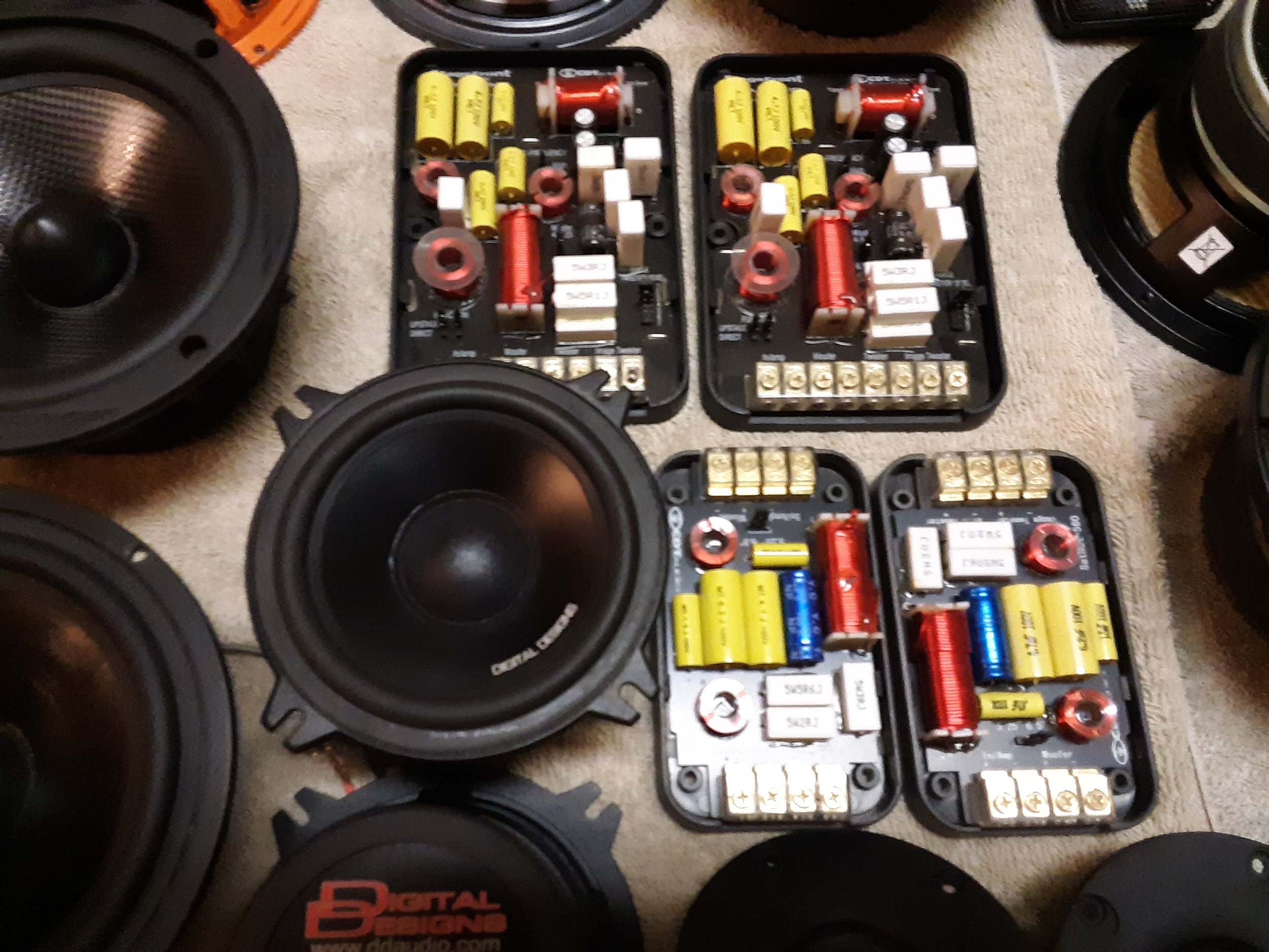

Have no experience with those, but do have with DD 5.25 Mids @4 Ohms. Great quality made speakers. For 6.5s, Id check to see what CDT has this month on Sale. I love all My CDT speakers. I do not care for the CL series, but the rest are very nice. HD series or Euro S. are my favorites
I know what you're trying to do, you want to add 2 6.5s and one tweeter per door. This just isn't the best way to do it. So what about the 4 ohm tweeters? Are you really going to send twice the power to the tweeters you don't have then what you're going to send to the mids?
You also need an amp that will do twice the power. The better way to do what you want is to either get a 6ch amp, or even better is to just get a second set of tweeters, and make two sets of components. You're really limiting yourself on options because you want to wire two 6.5s in series. Honestly, there's several better ways to do this, and I question whether you have planned this all through. Which I would suggest before you start buying equipment.
