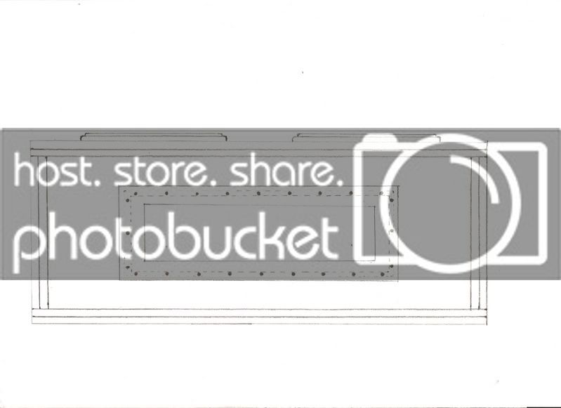

This is my first true build since my first build was stopped about 75% into it since i sold one of my avalanche 18s then a little while later sold the last one. Loyd told me to do 12 cubes net with 150" port 18" long (~35hz) so here is the plan i came up with ... 48" wide, 19" high (window line), 37.5" deep ... double layered all over. Also, i decided to be creative and do a changeable port similar to meades. Here's the sketch i designed of what it would come out to look like

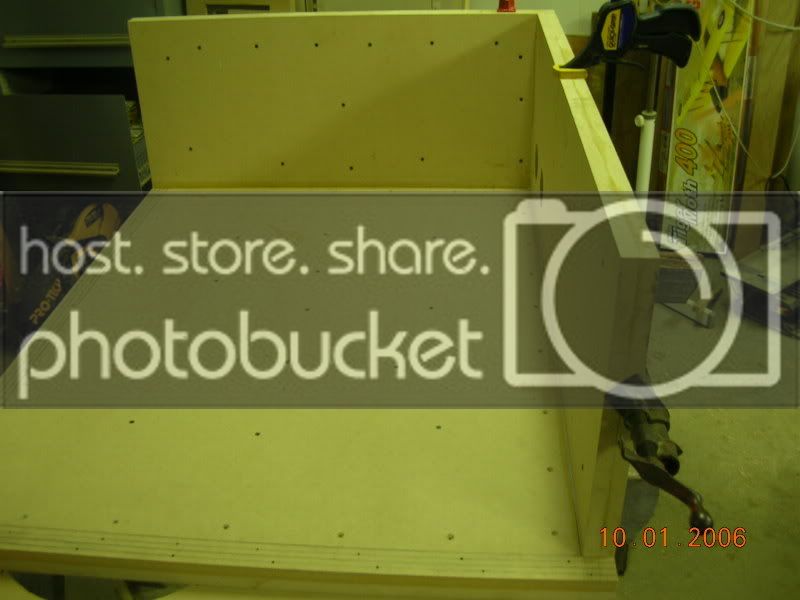

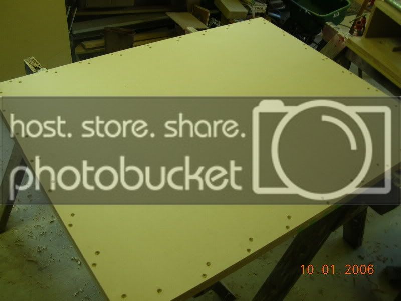

Since i don't have any pictures of the layering the peices i'll start with the first step i took to start assembling the peices ... went ahead and drilled the holes for the bottom of the box and countersunk them a nice depth

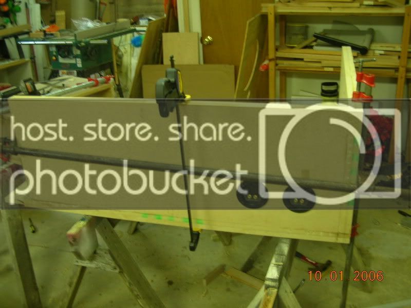

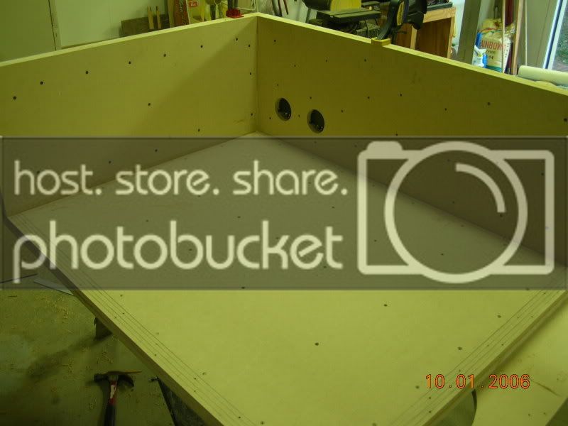

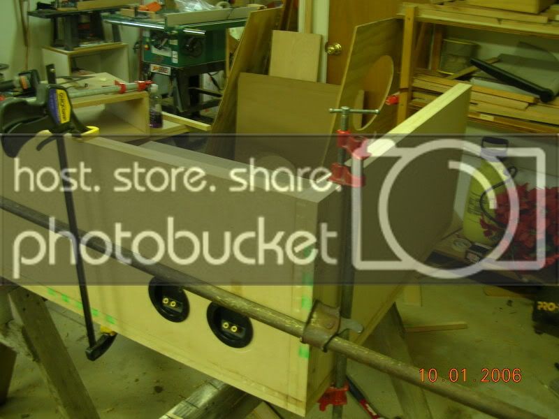

I forgot to take a picture of the first side on but heres a few pics of the left side and back peices assembled

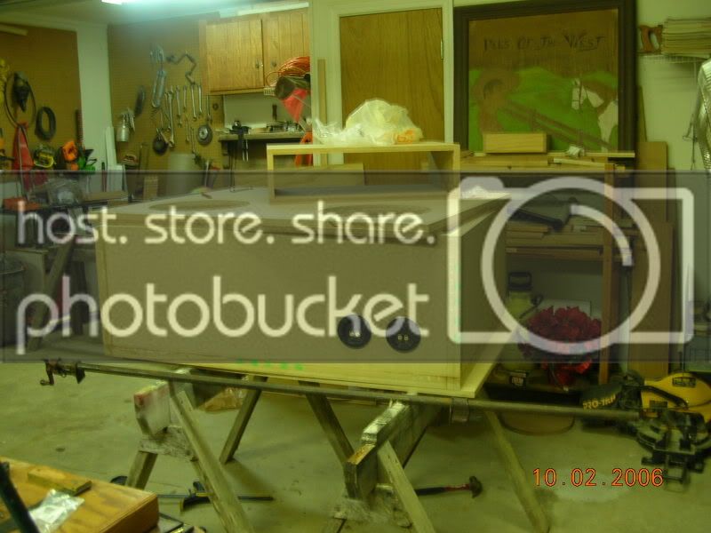

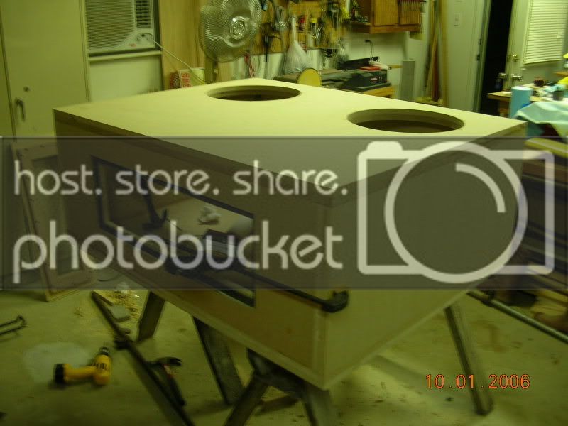

Next, i added the front peice and right side

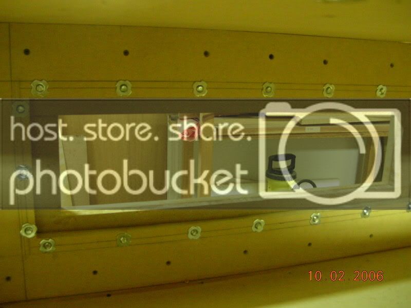

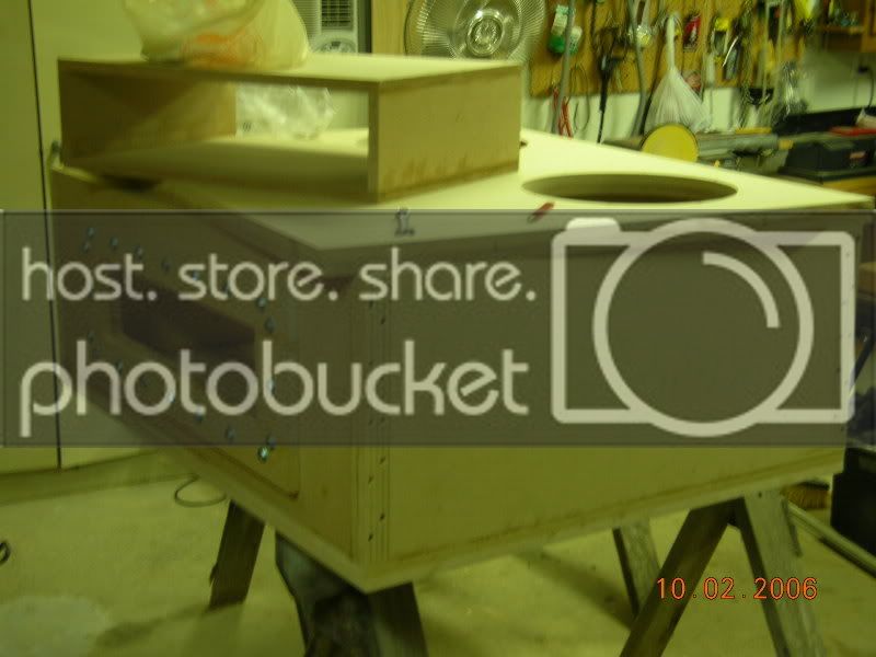

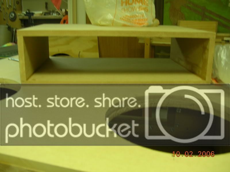

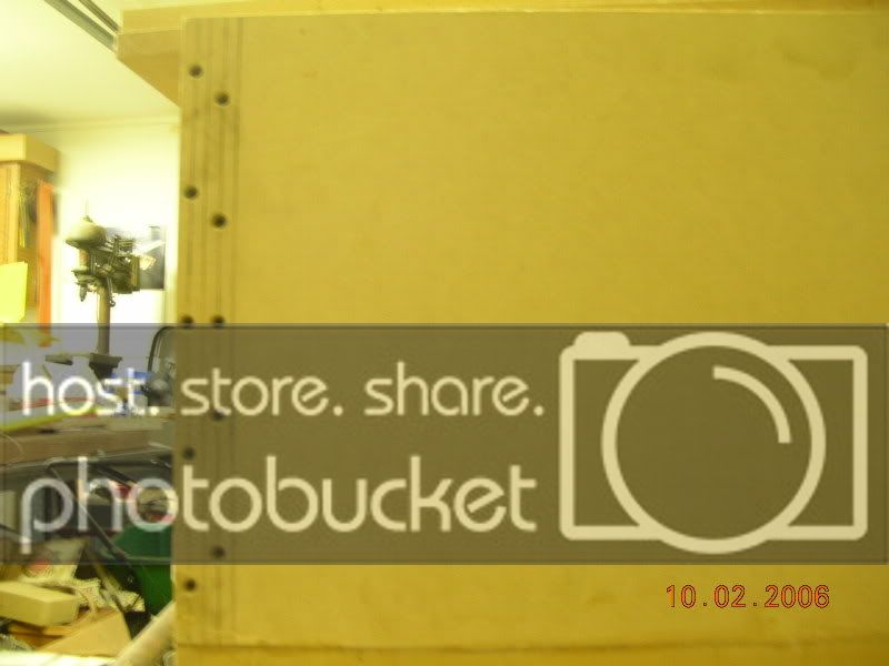

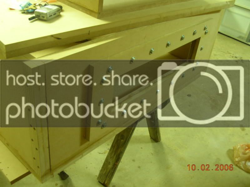

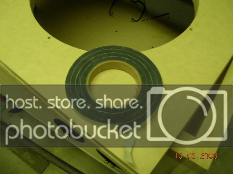

The port is a bolt in (3/8" 2.5" bolt with washer and 3/8" Tnut on the backside) I haven't glued and screwd the port onto the front peice but you guys should get the idea. I used some 3/4" weatherstripping thats 5/16" tall.

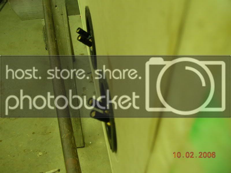

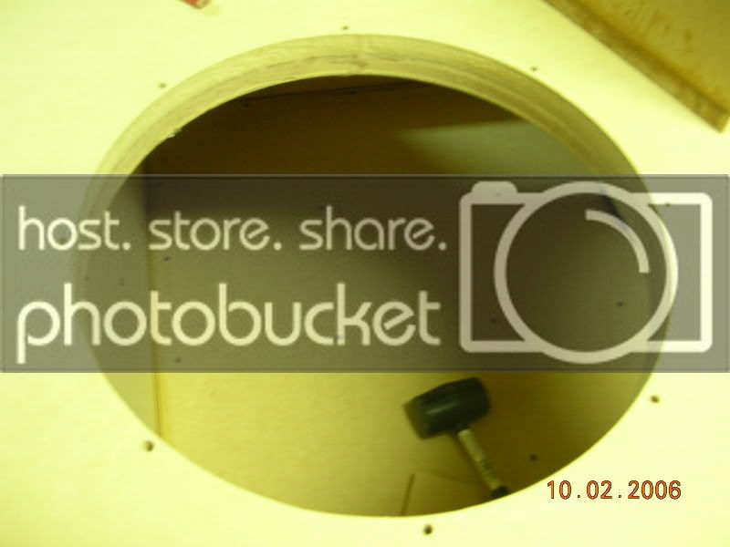

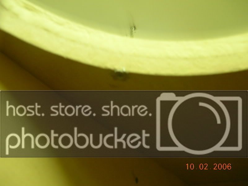

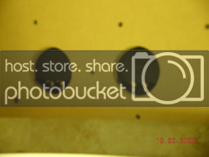

I routered my terminal holes and sub holes ($%#@$ DD since its 14.25 and not 14" cutout ... found this out the hardway)
i also used 10-32 tnuts from parts express...too bad their security screws arent long enough to go through double layered.

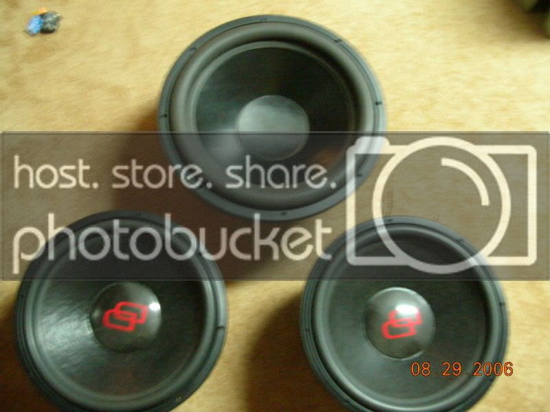

Oh yea, heres the 9515s that i'll be using
