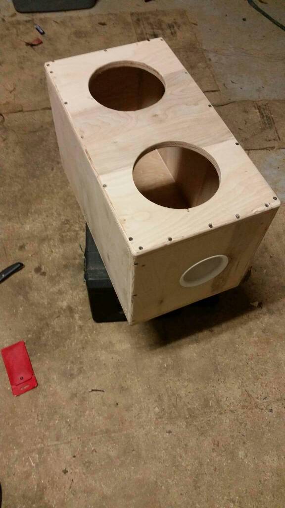

2 8 inch CT Tropo subs under the seat in a Chevy Crew. Design okay?

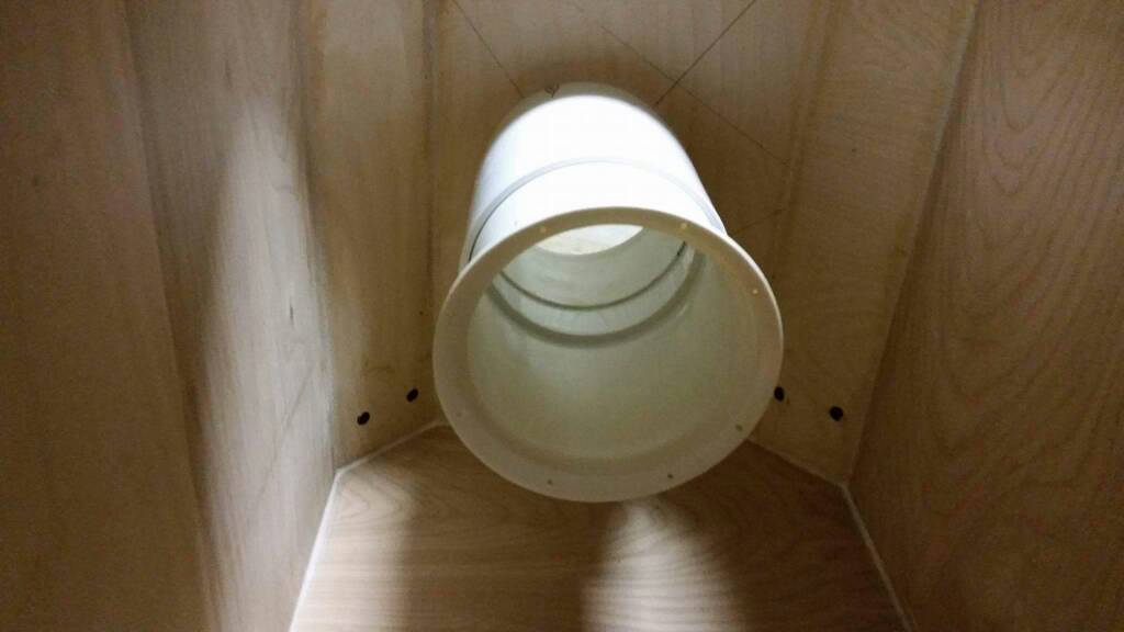

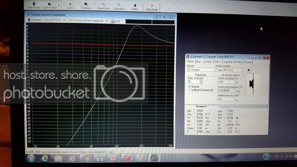

Anyone with any insight or thoughts? Cant get winisd working right. I removed the flush mount and gained the airspace. So I wound up with 1.61 cubes @ 34 hz with 20 sq in of octoport. Most likely building tomorow.

Thanks man. It wasn't an easy box to figure and took forever to bondo and sand smoothe but it was a pretty fun box to build. I took some video that I need to learn how to edit. Gonna mess around with that tonight.
