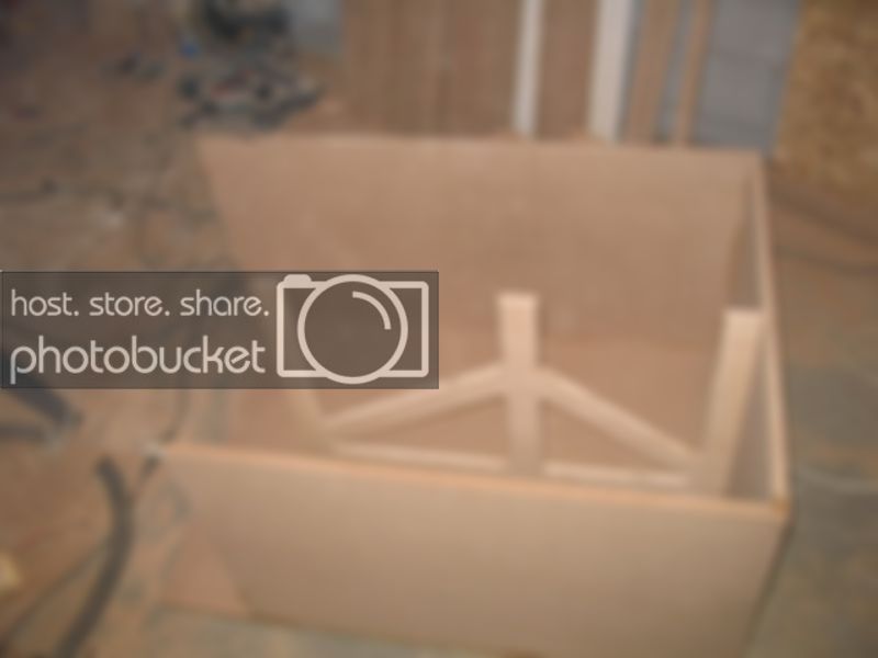

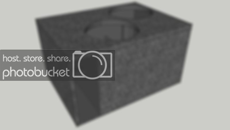

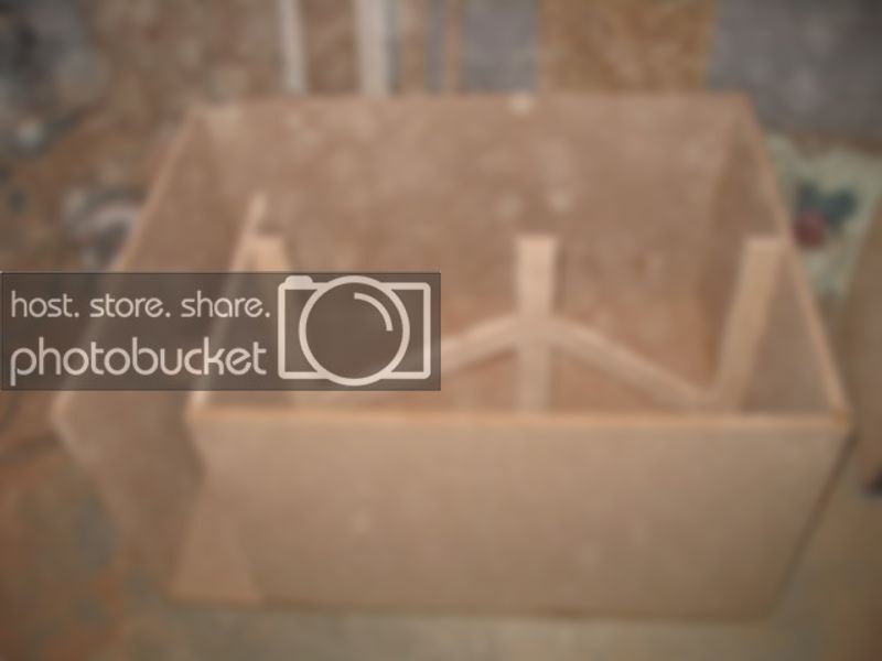

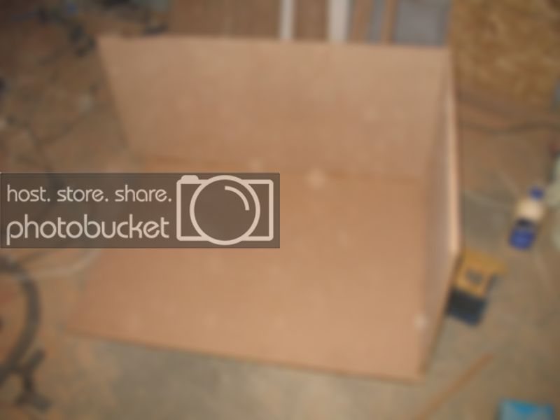

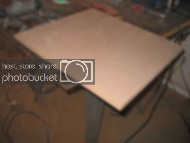

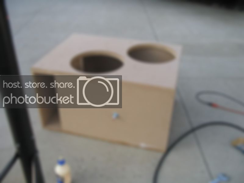

2 18" xl box build for DGold
Twisted_0912

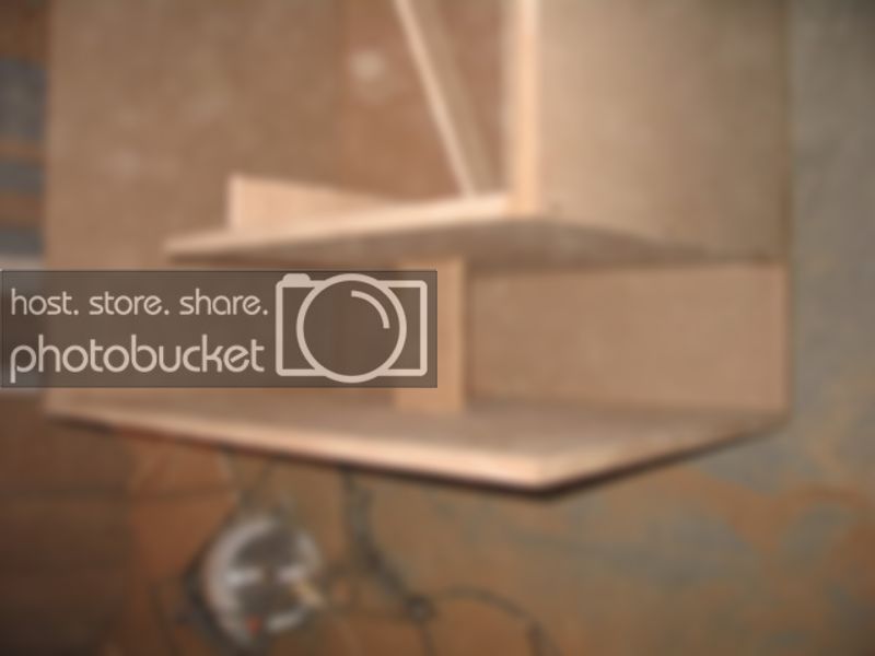

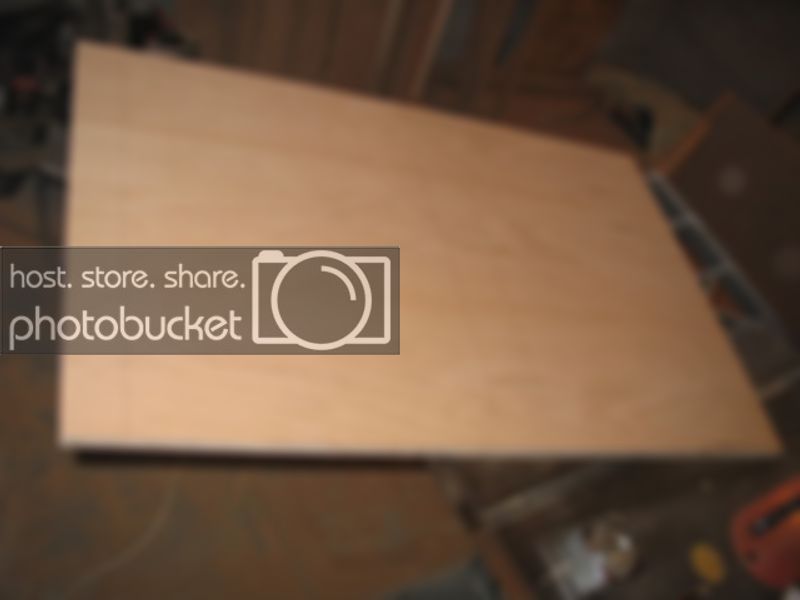

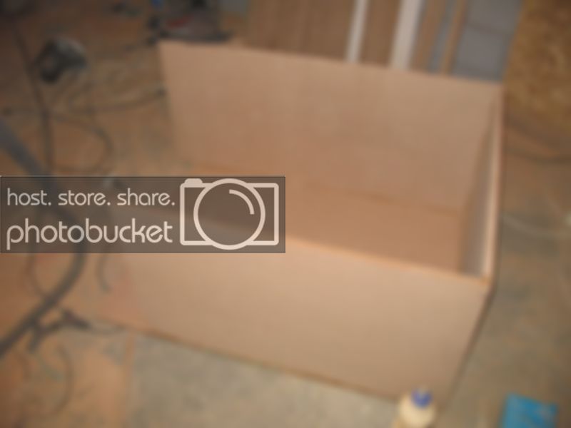

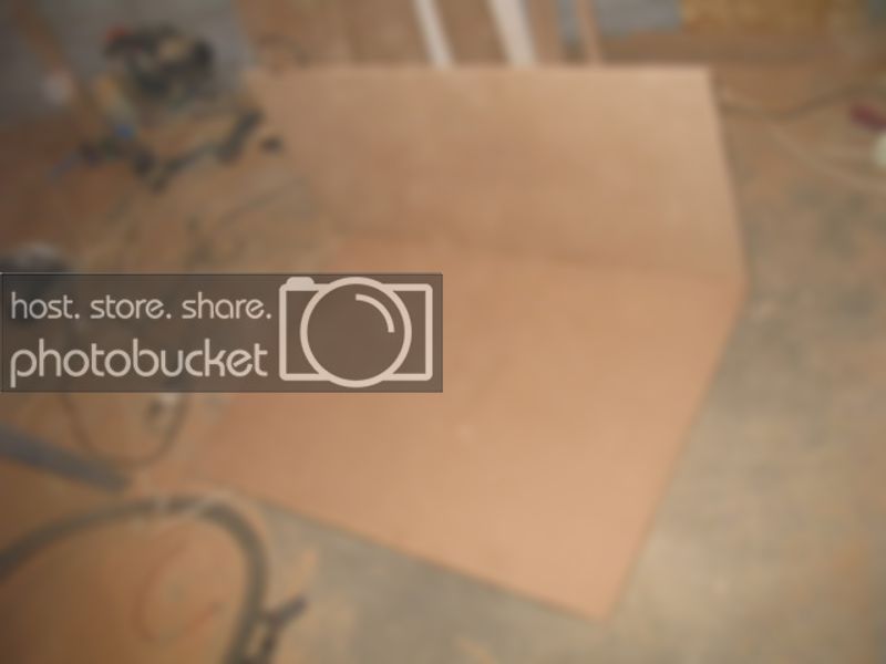

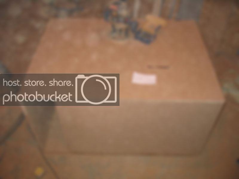

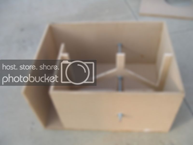

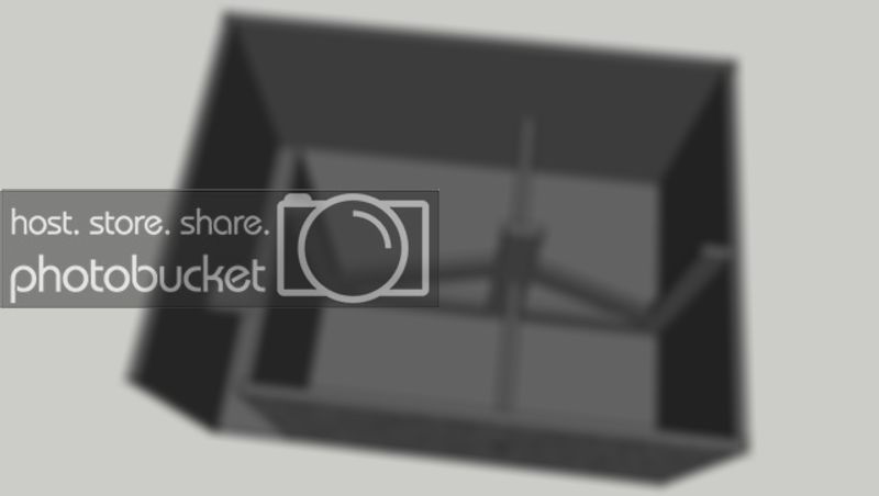

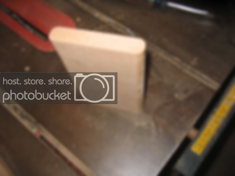

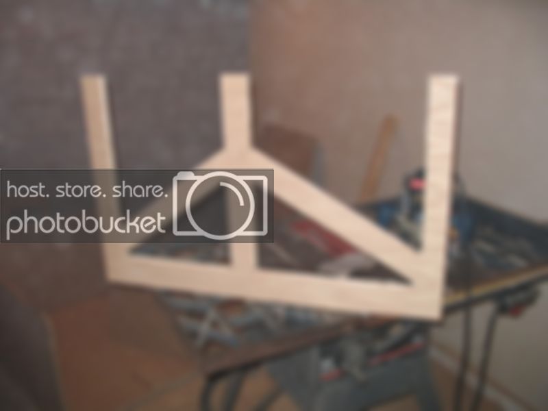

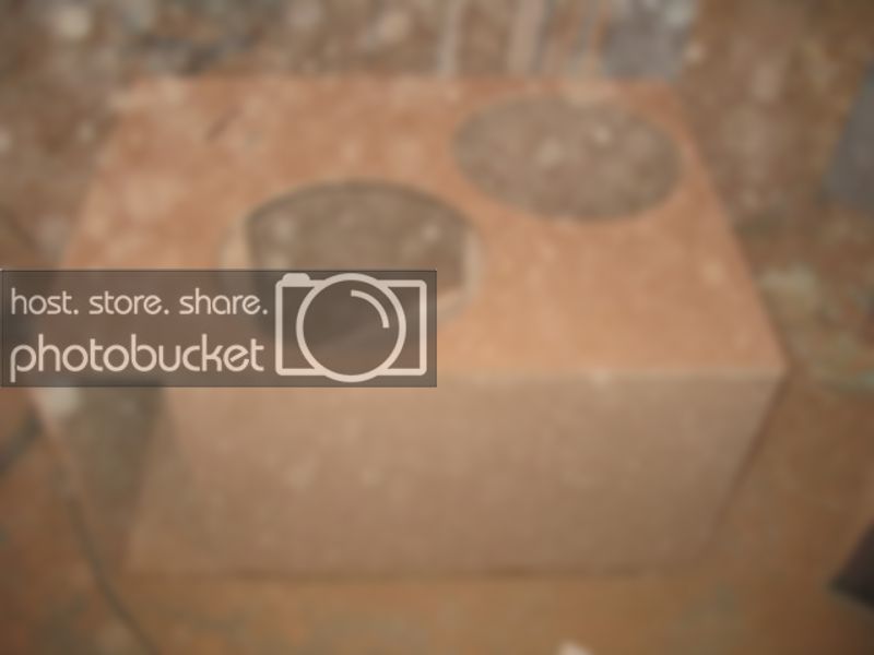

this build is for DGold's 2 18 inch dc level 4 xl 18s. it comes to 12 cubes after displacement tuned to 33hz with 147 inches of port area. uses threaded rod and normal wood bracing. heres the pics...
