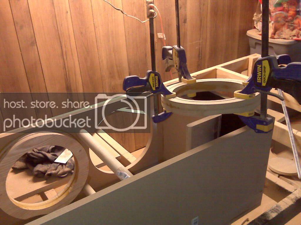

Didn't really take too many pics up to this point but here are a few teasers. Will be finished/carpeted tomorrow probably. Flush mount double trim ring, dowel bracing
is that hole 11 7/8" it looks like it may be a little small!

10 and 7/8" .... is that right? I think he will be running a Kicker 2500.1 on them

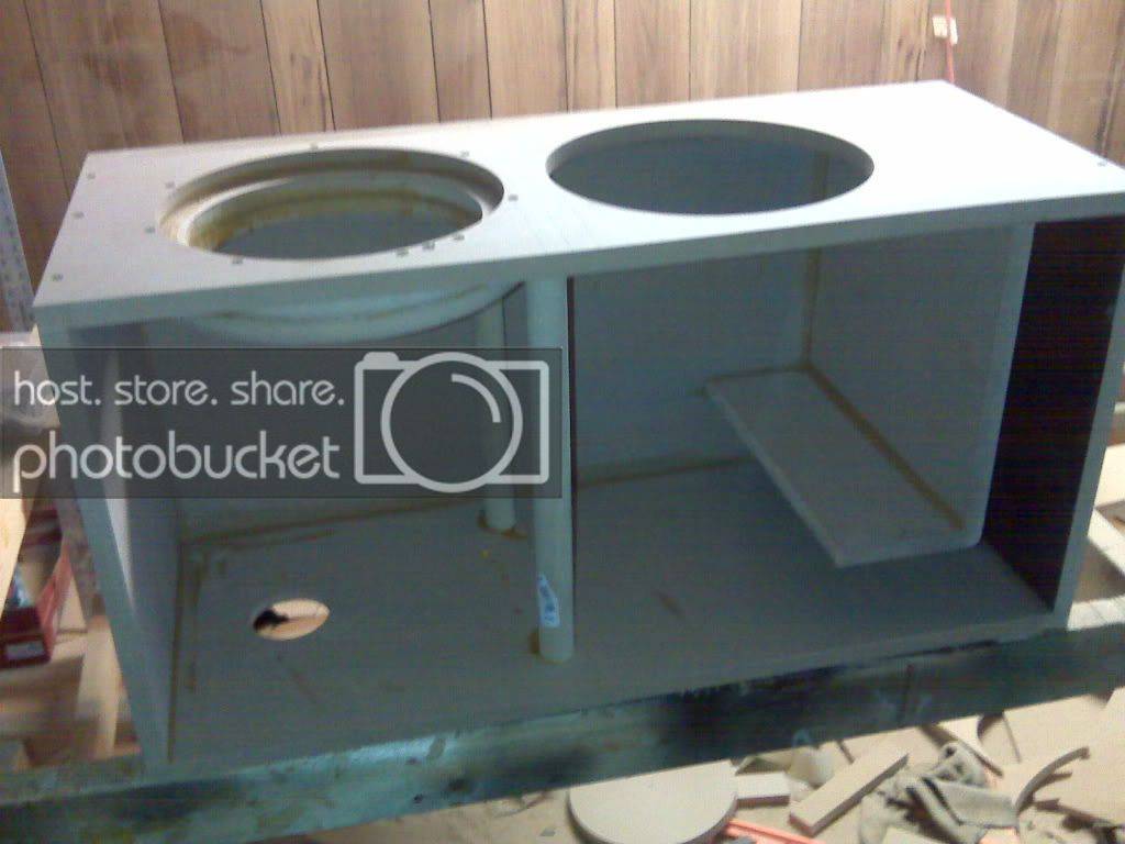

I might be retarded, but where does the port exit? It looks like it's covered up.
He's going to drill a hole and use a flush-trim bit to run along the port to cut away the panel on the outside that you see blocking it //content.invisioncic.com/y282845/emoticons/smile.gif.1ebc41e1811405b213edfc4622c41e27.gif
