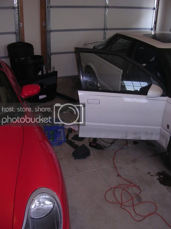

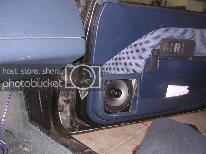

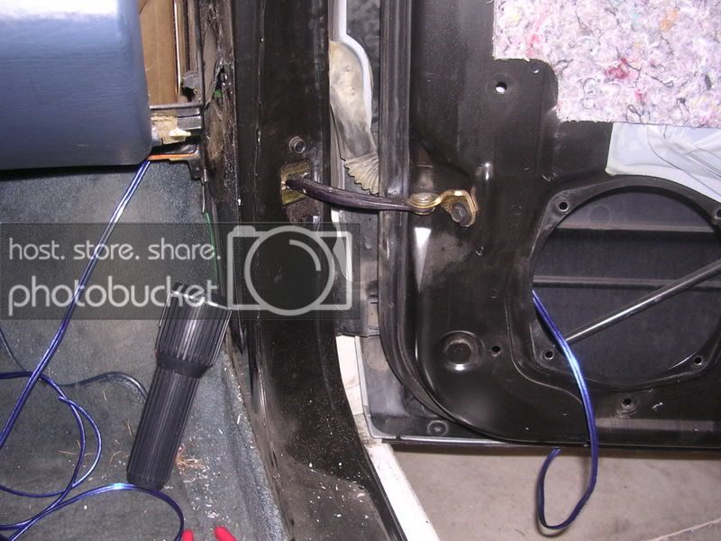

Did some work today, got the front left side door speaker installed. This time without ripping the rubber tube.

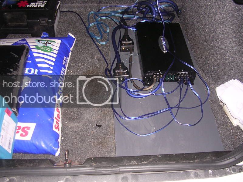

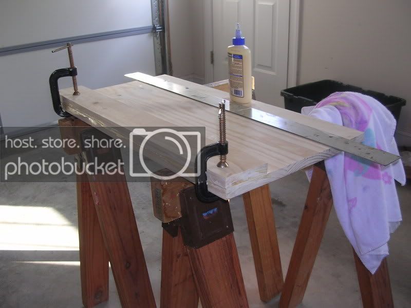

Got the amp mount painted today, color turned out really close to the carpet in the trunk. It should look good.

Finished installing everything today, just gotta clean up everything in the trunk, it's a mess.

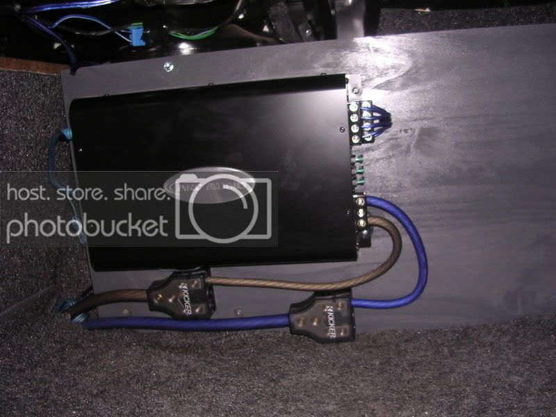

The amp rack is gonna be mounted horizontally against the right instead of how it's just laying down now.
This setup sounds really **** good for coaxial speakers. Actually noticed the trunk light dim a little when the bass hit. So not sure how well it's gonna hold up when i get a sub.

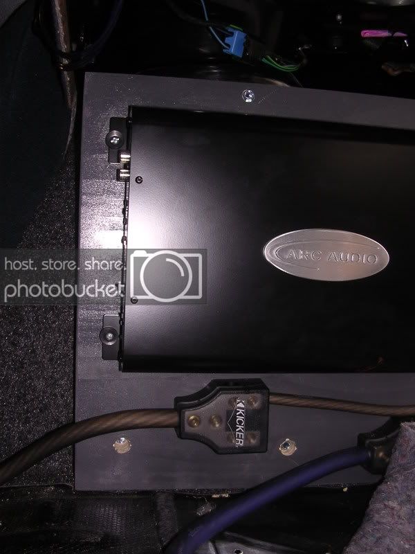

Finished up my install today.

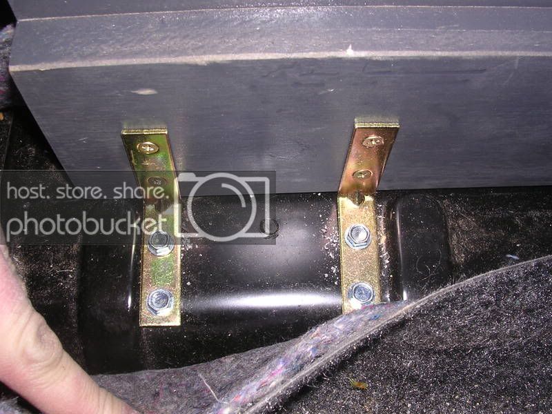

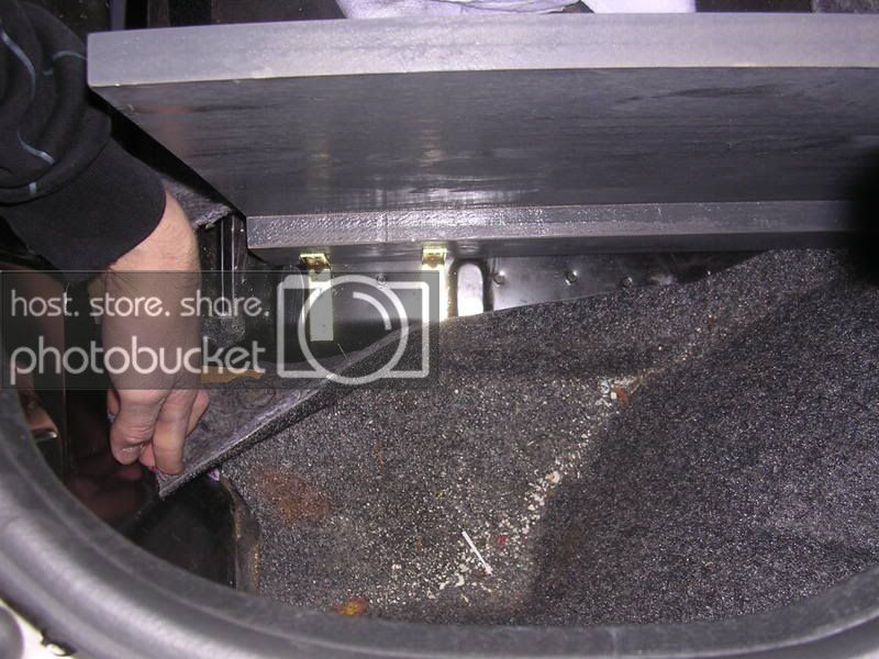

Mounting the amp mount, screwed into the metal sides.

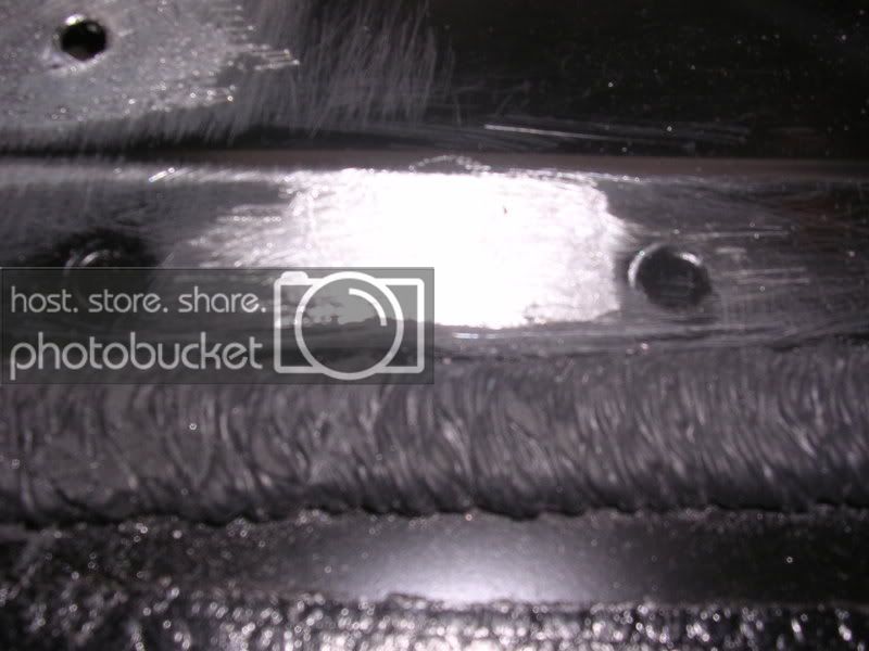

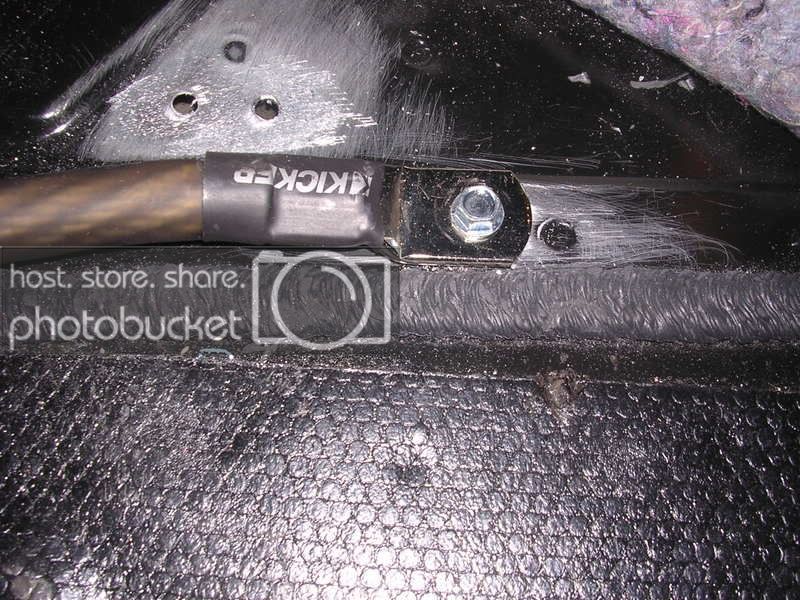

My ground. The first two holes didn't work because the self taping screws wouldn't tighten because the metal was too thin, so I screwed it into the part where it was thicker.
