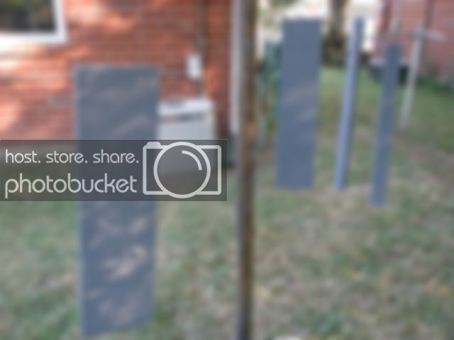

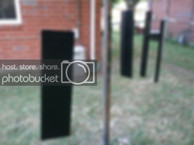

I also got the first four pieces of the amp rack for the RF Power 1000 and RF Power T3002. The amps are going to be installed on top of the sub box because of the lack of room in the trunk. The 3/4" MDF will give me enough clearence to run my power, ground and other wires underneath the amps to keep the install looking clean. Its going to work out really nice because the box is 36" wide, the Power 1000 is right at 23" wide and the Power T3002 is 12" wide so it should look really clean once its done. I cut two pieces that are 2" x 22" for the end pieces, a 5" x 22" piece for the middle and a piece that is 10" x 36" for behind the amps to hide the wires. After I get the amps installed I plan on making a couple more pieces for the front so you can't see the wires. All I did to the pieces was give them two coats of gray primer and three coats of a semi gloss black paint. They turned out really nice and I will get some pics of it when its done for you all.
Just a couple of pics right now.. Didn't get too much done yet this weekend..
Amp Rack Pieces with Gray Primer:
Amp Rack Pieces Painted with Semi Gloss Black Paint:
