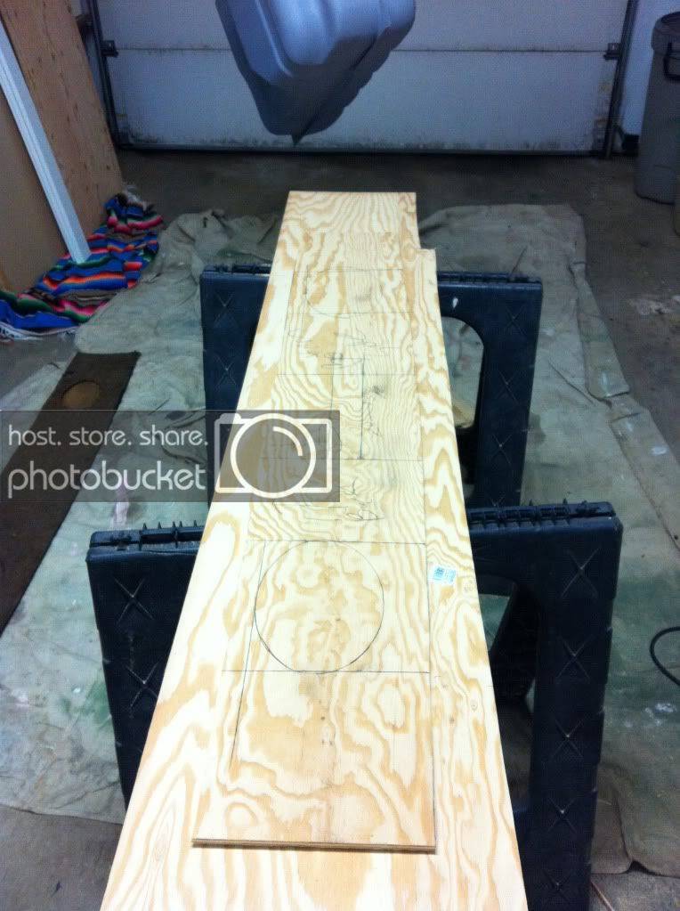

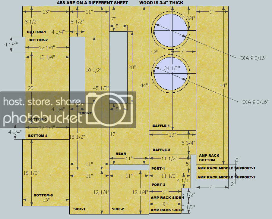

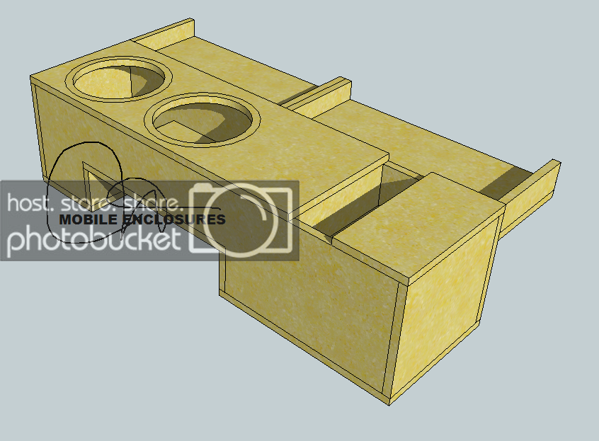

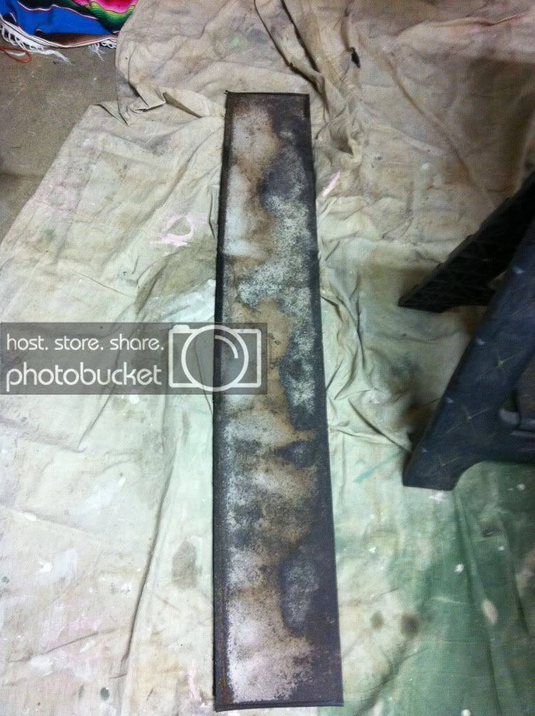

Alright, I purchased all of the MDF, and plywoud(package tray piece).
I pulled out my old package tray cut out, and already have the new one made. I will take it in tomorrow to see if it fits. Back in '74 cars only came with speakers if optioned for them. My car didn't, so my original package tray-insert is flat. Luckily that's just the insert, the actual metal package tray in the car already has cut outs for speakers, and a thin slot in the middle for a defroster. I don't plan on using a defroster, but my new insert will have the slot cut out. the shelf sits right above the sub box, so it will be like a port to my cabin. //content.invisioncic.com/y282845/emoticons/cool.gif.3bcaf8f141236c00f8044d07150e34f7.gif
There is one problem with it though. . . my driver side hole(in the steel package tray; part of the car's unibody) is a 6x9. The passenger side, on the other hand, is a 5x7 or something. //content.invisioncic.com/y282845/emoticons/eek.gif.771b7a90cf45cabdc554ff1121c21c4a.gif So we will see if I have to enlarge that hole.
Jason sent me the enclosure design, and I play on measuring everything, and cutting the pieces out tonight.
I decided to put my mids in my front doors. The holes are cut, and I will have pictures tomorrow. I was going to test fit my speakers, but I guess infinity doesn't include mounting screws in there boxes? Mine didn't come with any.
Wish my luck!
