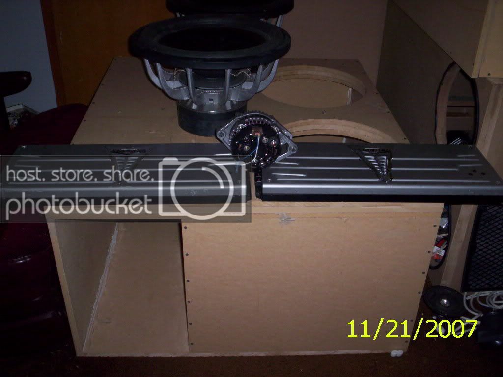

I was checking out Meade's (2) 18" RE MT install, he did both subs and port up, he is using 15sq.in. of port area per cuft of box volume. I plan to use 16.5sq.in. of port area for every cuft of box volume....
In his current design he is using the square port, I just cant believe it's only 130sq.in. of port for all (4) 18's...

got enough depth to put the subs on top of the port?
Not unless I raise the box 2", the mounting depth of the MT is 10.75, with the double baffle I only have 10".
This is why I'm kinda leaning to the design with the big square port.
Will the subs placed where they are on the slot port design not work out that well?
I think you'll have some loading issues considering the placement of the subs. Especially the black box with the big square port. Is there no way to get those 18's even? Good luck
