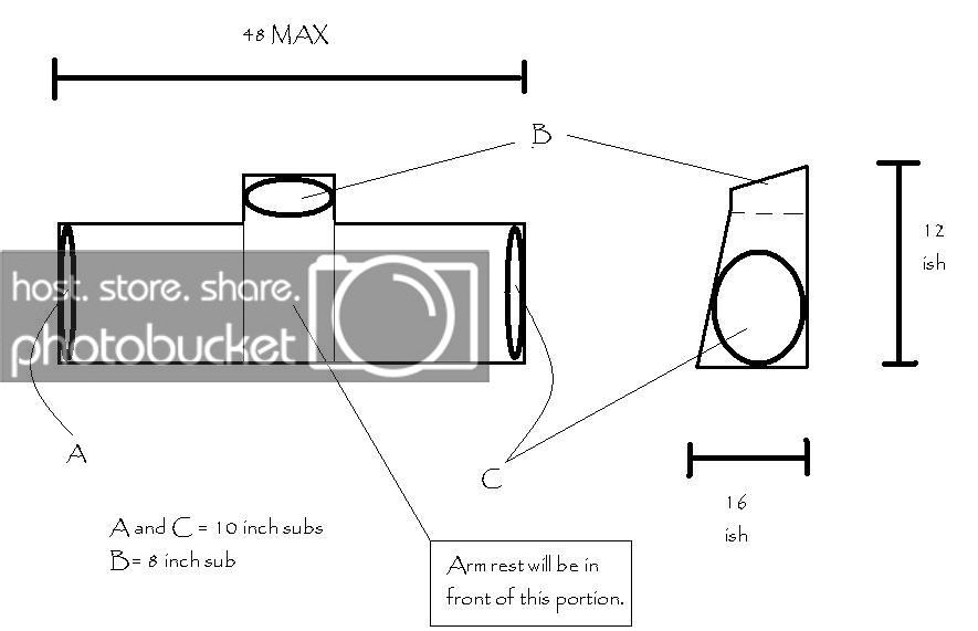

I need suggestions or any info you can give me on this idea. This is a rough draft of what I have in mind. This will fit behind the seats of a standard cab s10. I want LOUD. I'm wanting to port them. This will be my first box. I work at a plastic place and I'm thinking Plexiglas, maybe Polycarbonate. Then I will fabricate it at work. Or would light wood be better for bass quality? I also need to consider room for my amps. Under my seats? Anyways, check it out and hit me up with some feedback. Thanks guys.

why not have the tens on the front panel, facing the seat?
and people on here will tell u to lose the 8, don't mix sizes.
Go measure your space instead of saying "12 ish" or "16 ish"
Loose the 8" sub and if you want it loud I would suggest porting the box.
If you want help designing one post max dimensions and what subs and tuning for a ported box.
