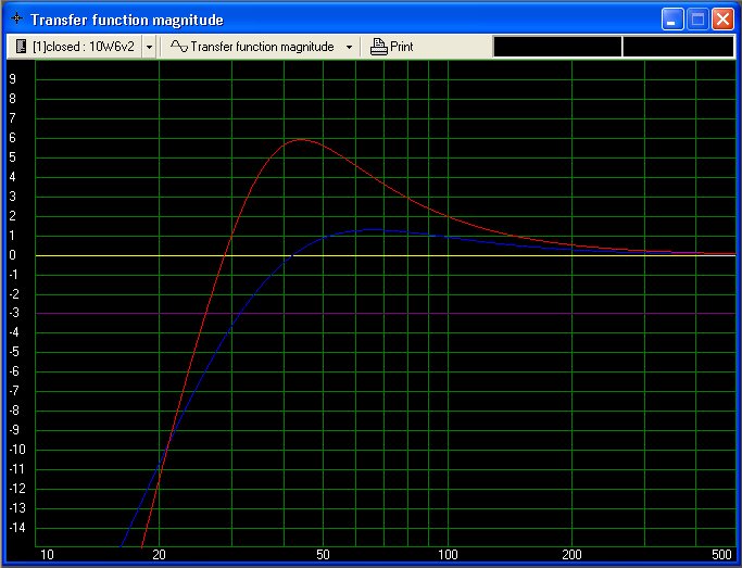

If your box peaks at tuning that means you have to much port area and no bandwidth.
The box's tuning frequency is where it peaks.. Doesn't mean it has no bandwidth.
If not, what would you say a box's tuning frequency is?

The red line peaks around 45 hz. Isn't it tuned at 45 hz then??
Cabin gain and imp rise at tuning. Software will not tell you what's going to happen when the vehicles resonance comes in. And that has no bandwidth.
Ah, I see. I know that picture didn't have a good slope either
