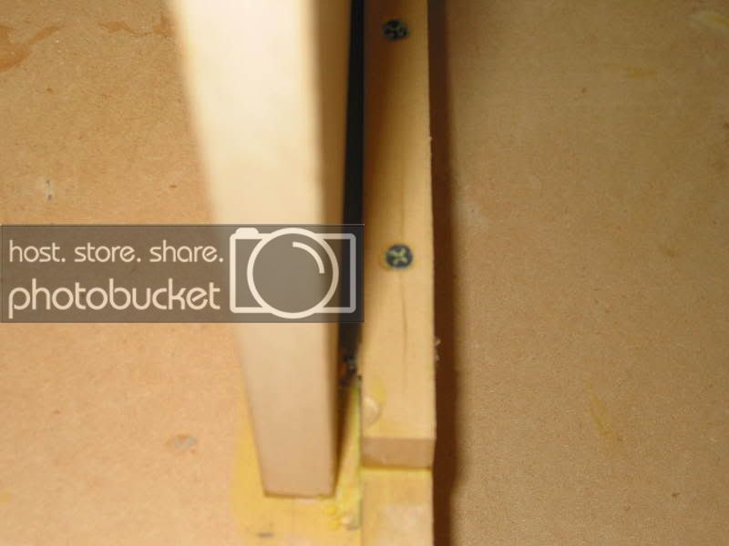

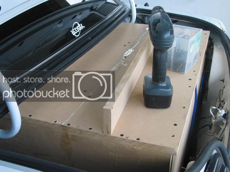

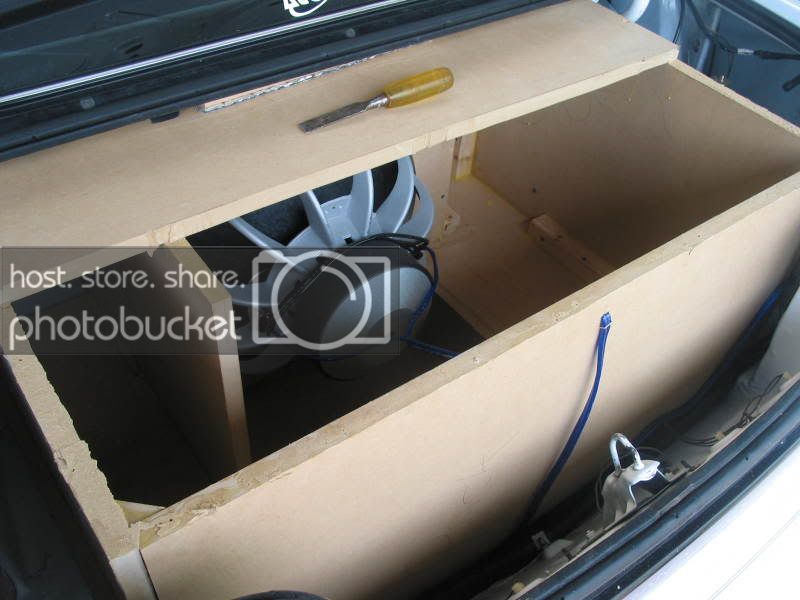

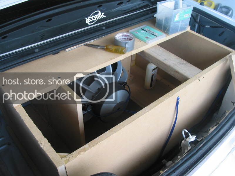

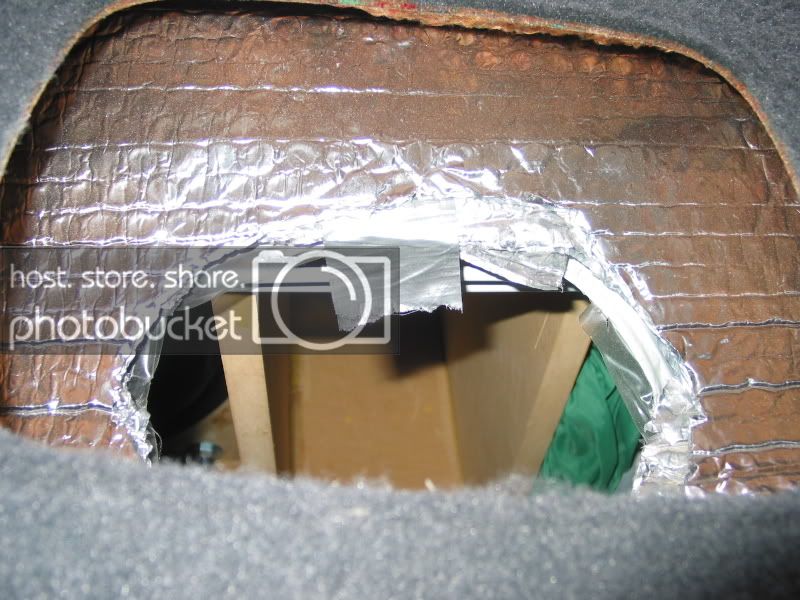

i took the top off today. since i glued it i didnt want to tear it all off, so i just took a jig saw 12" deep from the back. then when i got inside i found why its sounded shitty the past few days. as you will see in pic 2, the screw and glue holdign the port on broke free and has been loose. so i glued it up, fired more screws in it, and now its solid.

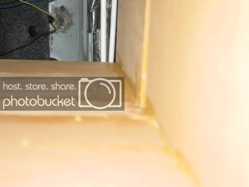

down the port shots

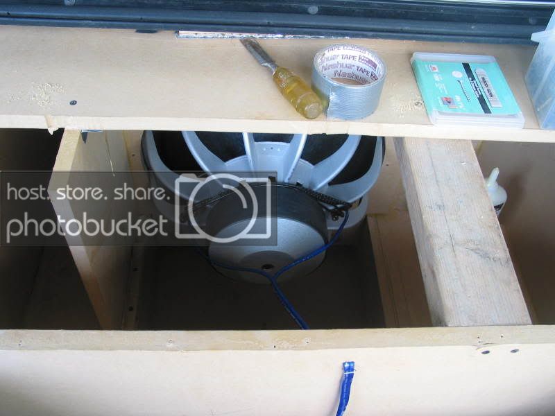

bracing

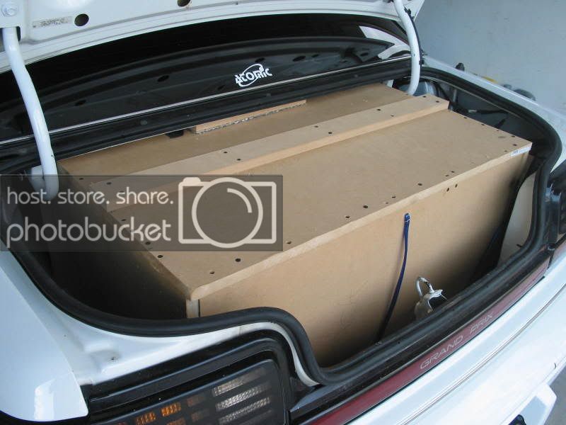

top back on. only glued down the middle crack...the rest isnt for now. it is well sealed though.

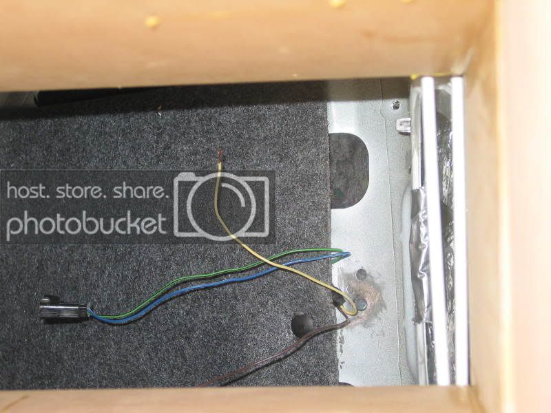

shot from between the seats

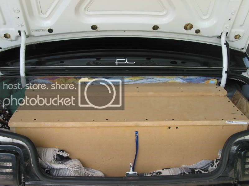

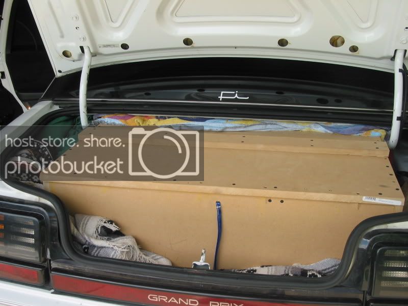

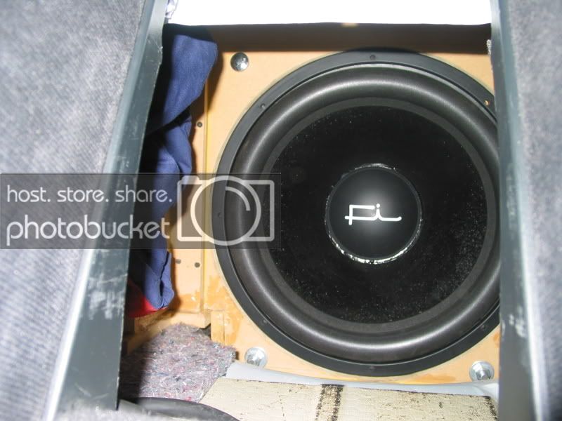

here are a few pics.i stufffed the backside and the sides with blankets. it really helped reduce flex and more importantly my car doesnt rattle as much anymore
i tried to make a video the other day but the **** camera died
lol i got the idea from mazdakid a while back. it really helps reduce panel flex behind the box and it doesnt rattle nearly as much. it almost completely seals of the cabin from the back half of the trunk. i havent got it metered yet after putting all the blankets and shit in but i imagine in will be louder thant it was:)
