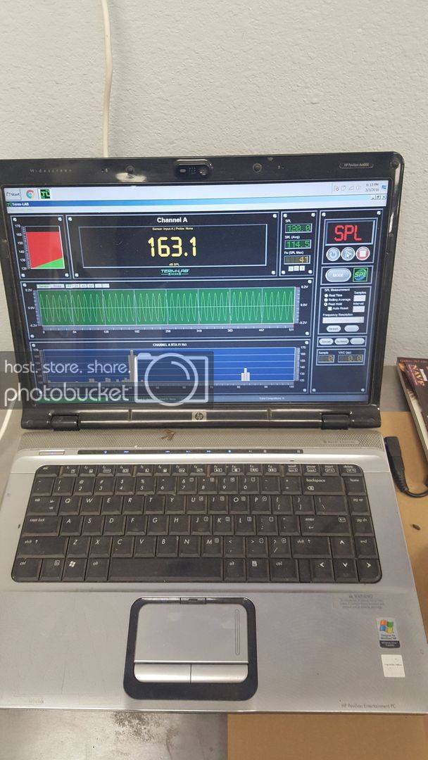

Thanks. I won't be that disappointed if I don't reach 170db. Ive made a few changes since the last post and almost getting 163db out of it. Still haven't done any deadning or bracing on the back door. I'm extremely pleased with the output and demos. It's even started to flex the windshield now lol

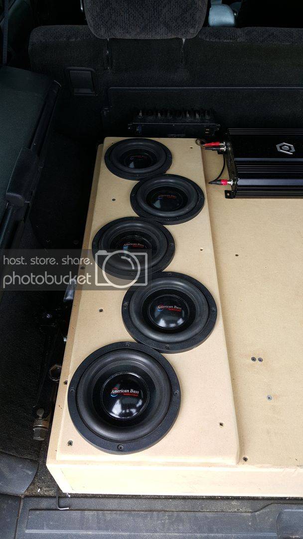

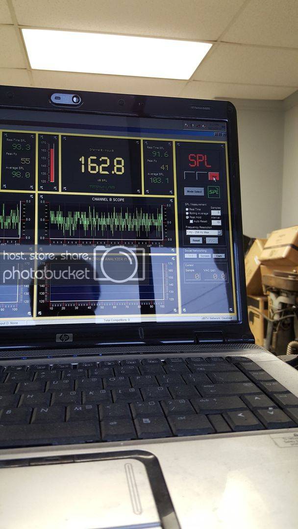

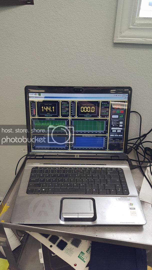

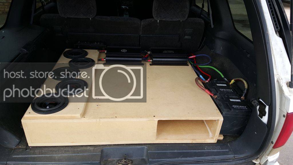

Update. I built a quick baffle and added 2 more 6.5s. Added a second SQ750 and strapped the pair @ .8ohms. Aslo added two 50ah batteries. Went to a show about a month ago. Took first place in port wars with a 162.8db. It also did 144.1 in the kick
Little update. I haven't been messing with this build much lately. These 6.5s are getting harder to find. I'd like to find 3 more and run 8 total or 5 more and run 10. A bigger tline will be in the works too when I find more subs
