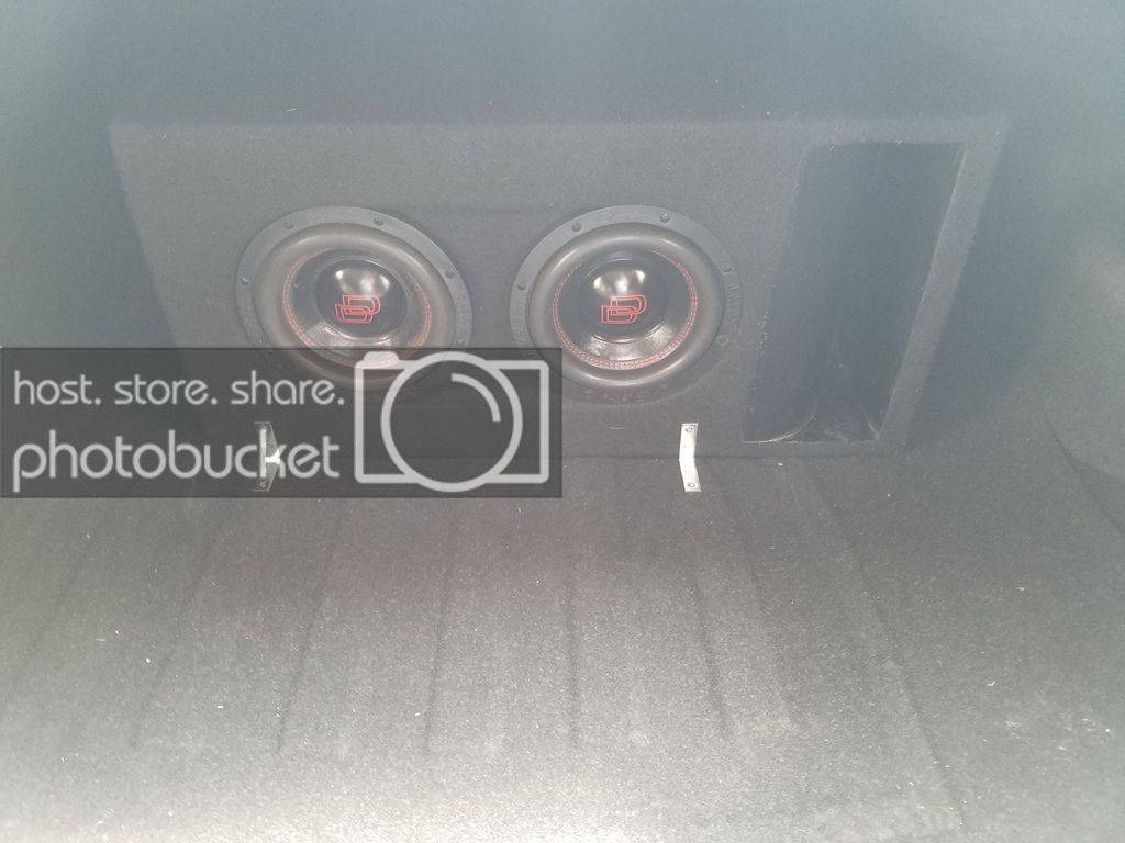

Finally got my power wire in today. Only running 4 gauge back to distribution block and 8 gauge out to amps. Only running a Twisted Sounds 1kw and a small 2 channel
Tomorrow I will get the LC2i in and get my two new DD608's installed
