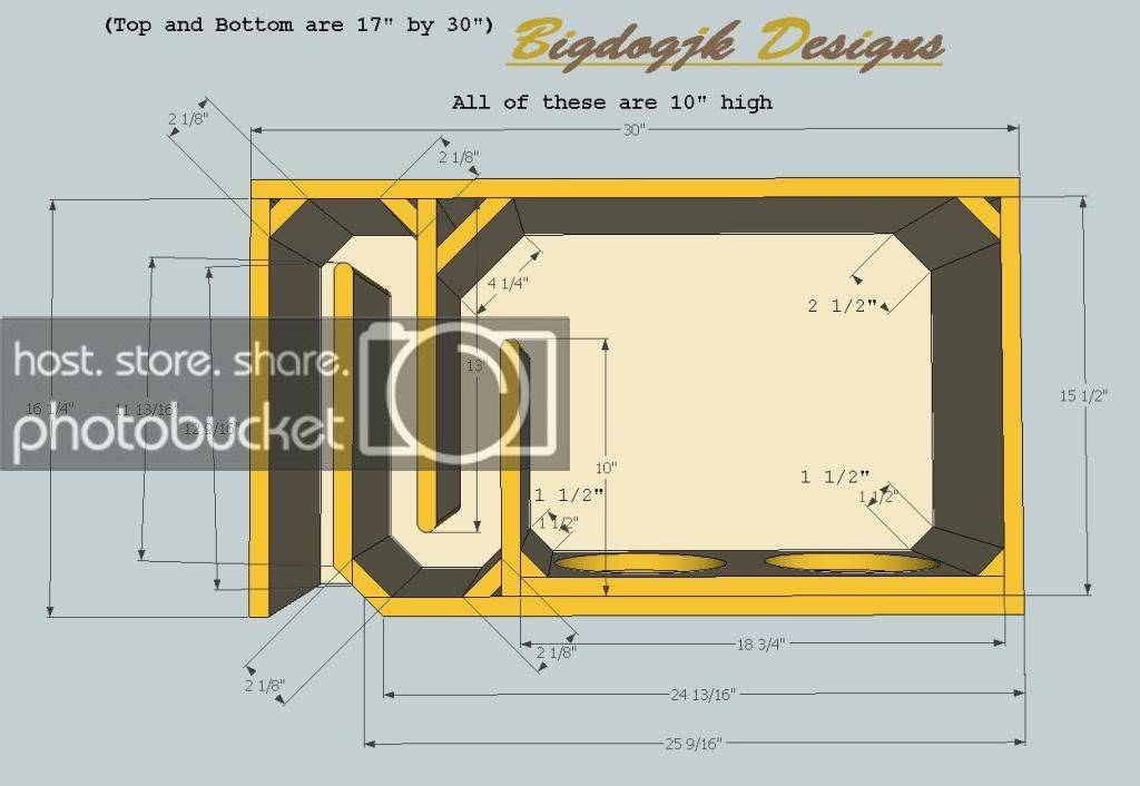

Setup atm is two sa-8 v2's (d4) @ 1 ohm on a Hifonics Brutus brz 1200.1d in a custom ported box tuned @ 30 Hz. Anyways, I sort of want to throw more power at these little guys, I feel as if 1200w isn't enough. Anyone fed a saz-1500 or similar @ 1 ohm to these guys? I'm sure my current amp doesn't do full 1200w rated @ 1 ohm.

How big is your box?
1.45^ft tune around 30hz (after sub displacement)
Box dimensions are 30"W x 11 1/2"H x 17"D
Port dimensions are 2 1/2"W x 10"H x 46"L
Port is 2 1/2" wide flared to 4 7/16" wide at the front of the box.
Port area 17 sq" per ^ft
