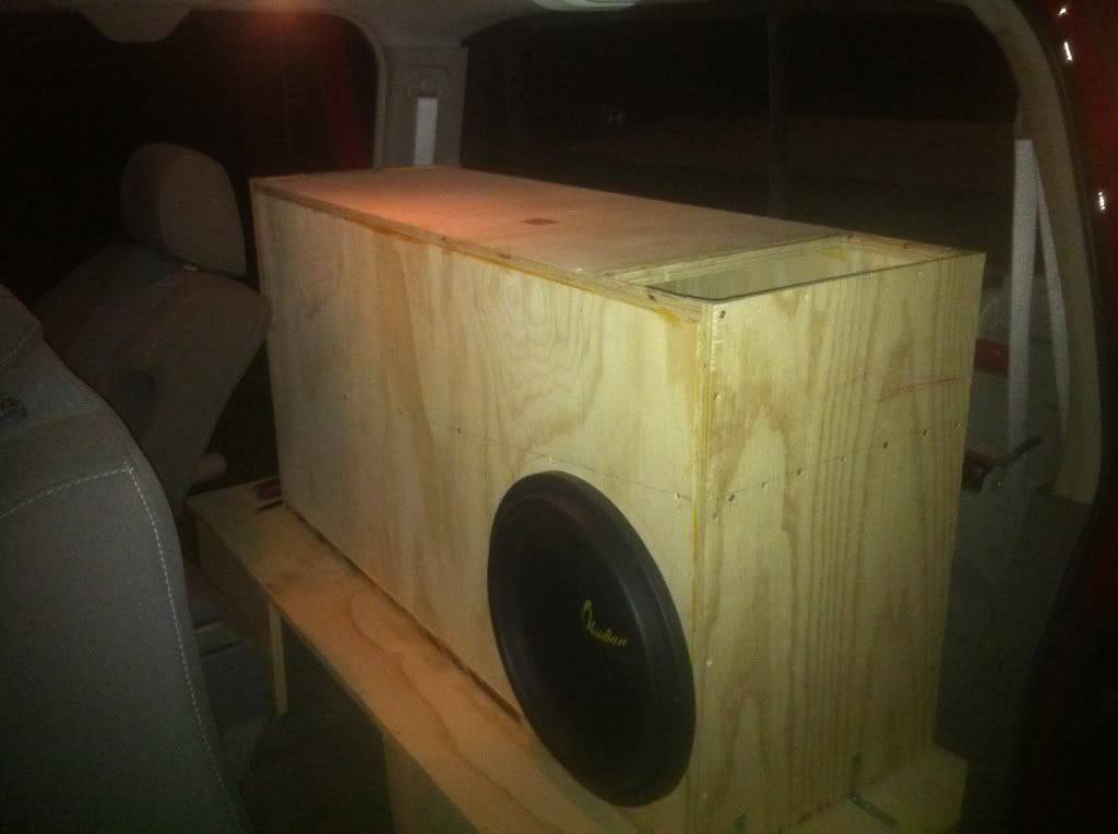

This one got pretty nasty. Obsidian 15 on a D9. Lol. 30hz tline (quarter wave). 9.4ft of line. 300sq in at throat tapered to 130sq in at terminus.
hornresp along with any other box building program is only half the battle of a proper design. Also, quarter-wave is a simple approach, and is not as applicable as you may think to accuracy. It does give great output in some designs, and acceptable(key wording) output in most, but relying on it may have adverse effects that you may not notice audibly. And the acceptance of it may have a high tolerance to errors.
Just some information that is needed for the OP to understand about Tlines.
