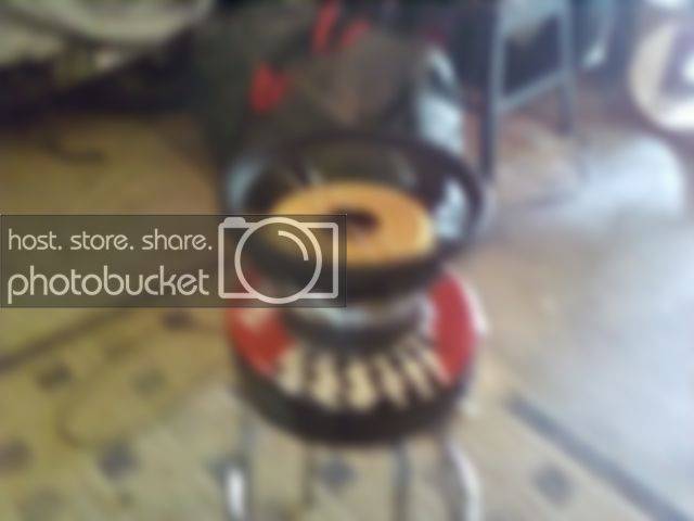

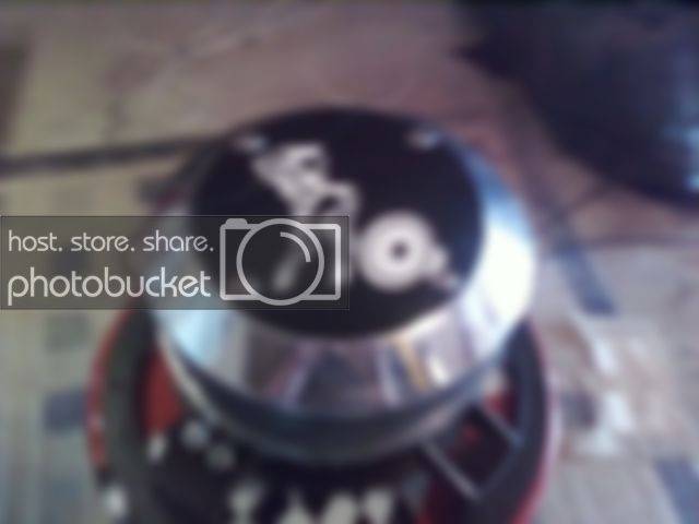

Removed the softparts from my 15" - Saved the coil

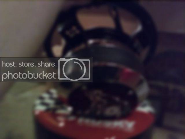

Bolted up the 12" basket
Side view

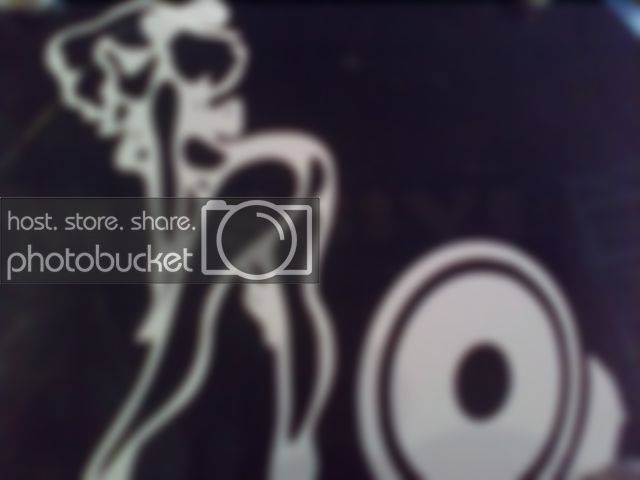

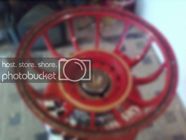

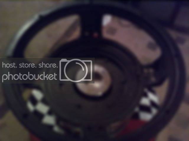

I removed the back cover and sprayed the back the same color as the basket. If you look closely you still see the massive but with a matalic black color. Also applied the decal.

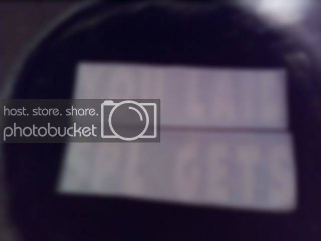

Mocked up the spider from dave
This may go on the next dustcap, sorry I have them backwards in this picture. //content.invisioncic.com/y282845/emoticons/biggrin.gif.d71a5d36fcbab170f2364c9f2e3946cb.gif

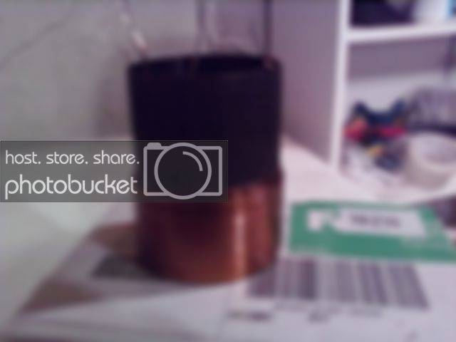

Update (6-19-09):

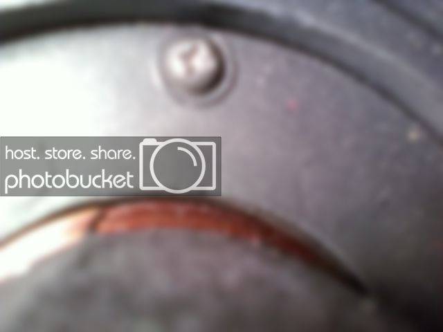

Small update here. Fedex showed up with my coil from scott. These coils are SEXY! Pictures does not do justice of how meaty they are. Maybe scott knows what I'm talking about here. Anywho, pictures
She's tight, but when centered, no rubbing at all. Perfect.
