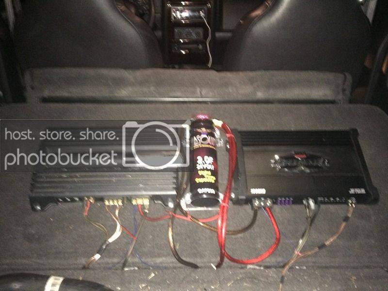

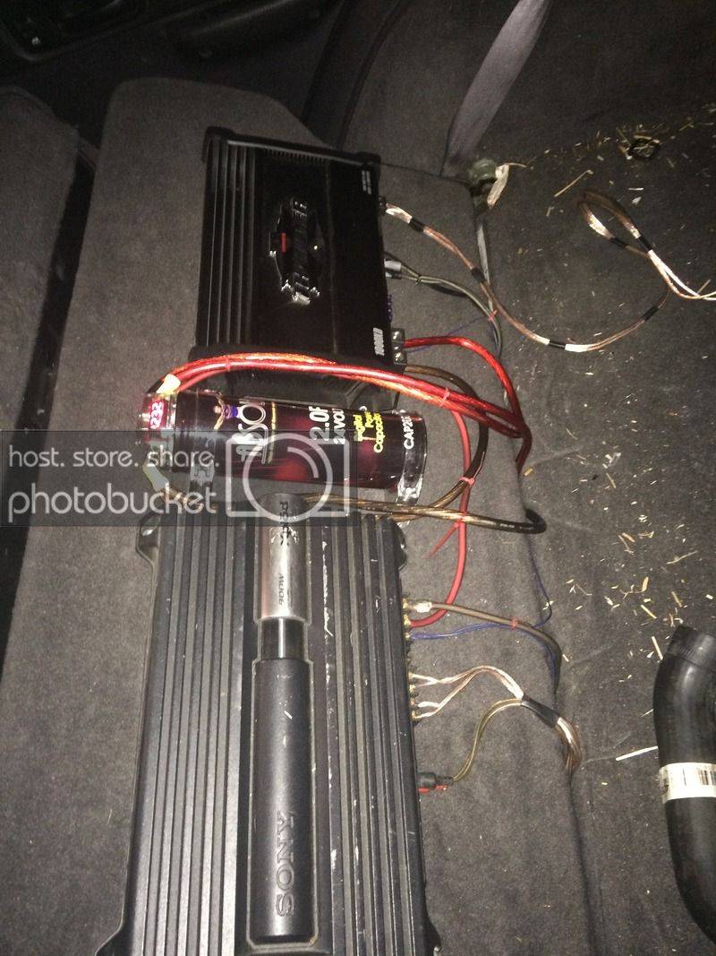

First post here (been reading a lot) and apparently I don't know as much about car audio as I thought I did. Anyway, I recently picked up a MTX 1000xd, 12" Kicker CVX, 2.0f capacitor, and all the wiring off craigslist for $150. Good deal?

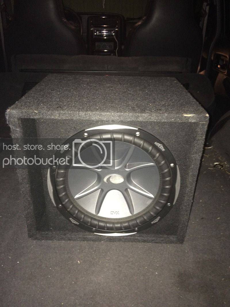

The sub is in a small ported box. Probably 1 cubic ft without the port and the port is maybe 2" wide 12" long. It seems to hit the higher frequencies good but won't hit lows worth a ****. Is it the sub or the box? I'm guessing the box might have quite a bit to do with it but I'm not sure. Anyway, is it worth trying to build a better box or should I look into upgrading to say a Sundown SA 15 or something else? I wouldn't mind something a little louder but I don't want to drop the coin on a new sub if I could get more out of this one with a different box. If you think I'm pretty much at this subs limit though I'll upgrade. I listen to just about everything, rap, country, rock, mostly rap though. And I have it in a Jeep Cherokee XJ.
If I end up upgrading I have about a $300 budget for the sub. My amp supposedly puts out 1000w rms so I'd like to get a sub that will work in that range because I want to keep the amp. I could build the box but I wouldn't even know where to start with dimensions, port tuning, port length for this sub or if I get a different one. Never got in this far with my systems before. Always had pre fab boxes with junk subs. So I'm open to suggestions. Thanks

I had two of those in a 3.5 cubic foot box ported with an external port in my 240sx at 600w rms and they were very loud and very responsive down low. My suggestion would be to buy/build a new ported box with a lot more volume (you will need it anyway if you upgrade). See if you like the response. If not, just get a different sub in your newly built large box and then you will be happy.

Larger subs to play lower is a myth. I build tline enclosures for single SA V3 8's that hit down into the mid 20's no problem. And they are very loud with a grip of bandwidth.

So you think I should try building a box for this sub? Would it be worth it or do you think I'd just be wasting my time?
kicker subs = junkprefab box = junk

Cables seem ok. I read where any aluminum in cable is bad and I didn't see any. Very soft too, not real thick strands. I'm no expert though so maybe it is crap. But seems ok to me.
If I do the big 3 and upgrade my alternator do you think I would still need a 2nd battery for 1000w?
