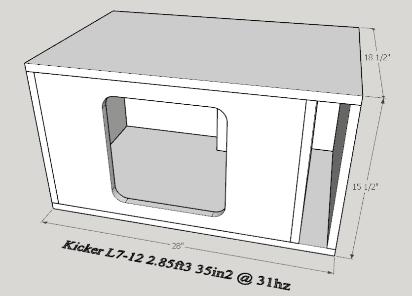

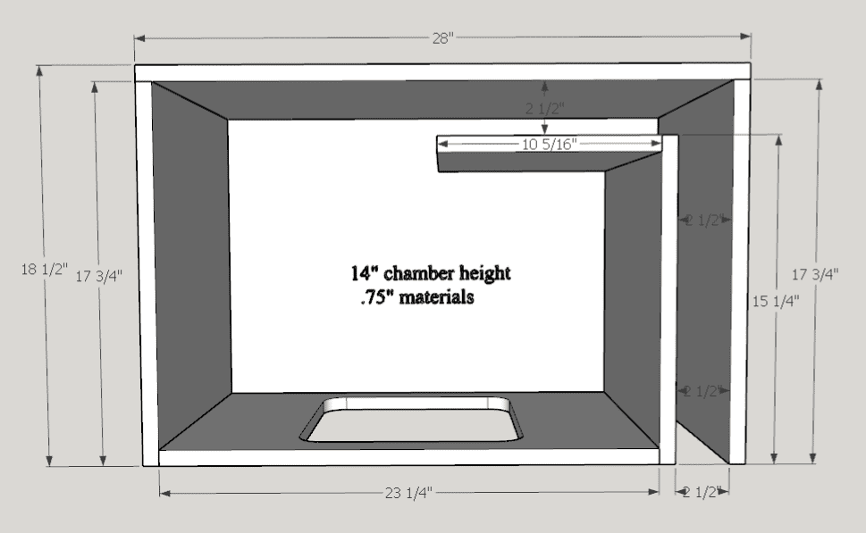

Decided to say screw it and just locked up a box quick and just gonna make one now
Basic L7-12 banger...
Or... hmu for anything different.
