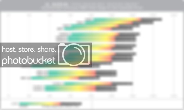

Technically you are both right. JL use to post that it was rated at 500 watt rms, but they have changed it to 750W (thermal power handling) on their website, However, if you look at the power chart, you can see that 500w is in the optimal zone, and 750w is in the black warranty void zone. I've personally have used a Alpine MRV-1002 600w at 4ohm and a JL 500/1 on a 10W7 and it was enough power. I wouldn't recommend anything more, definitely nothing at 1000w.
