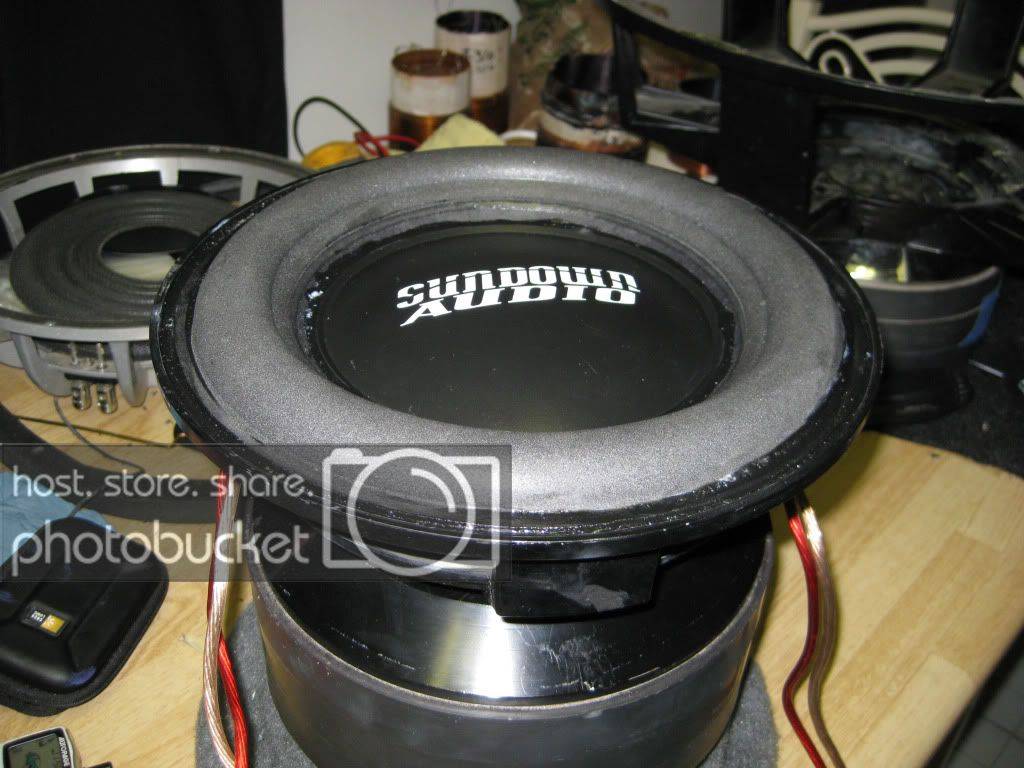

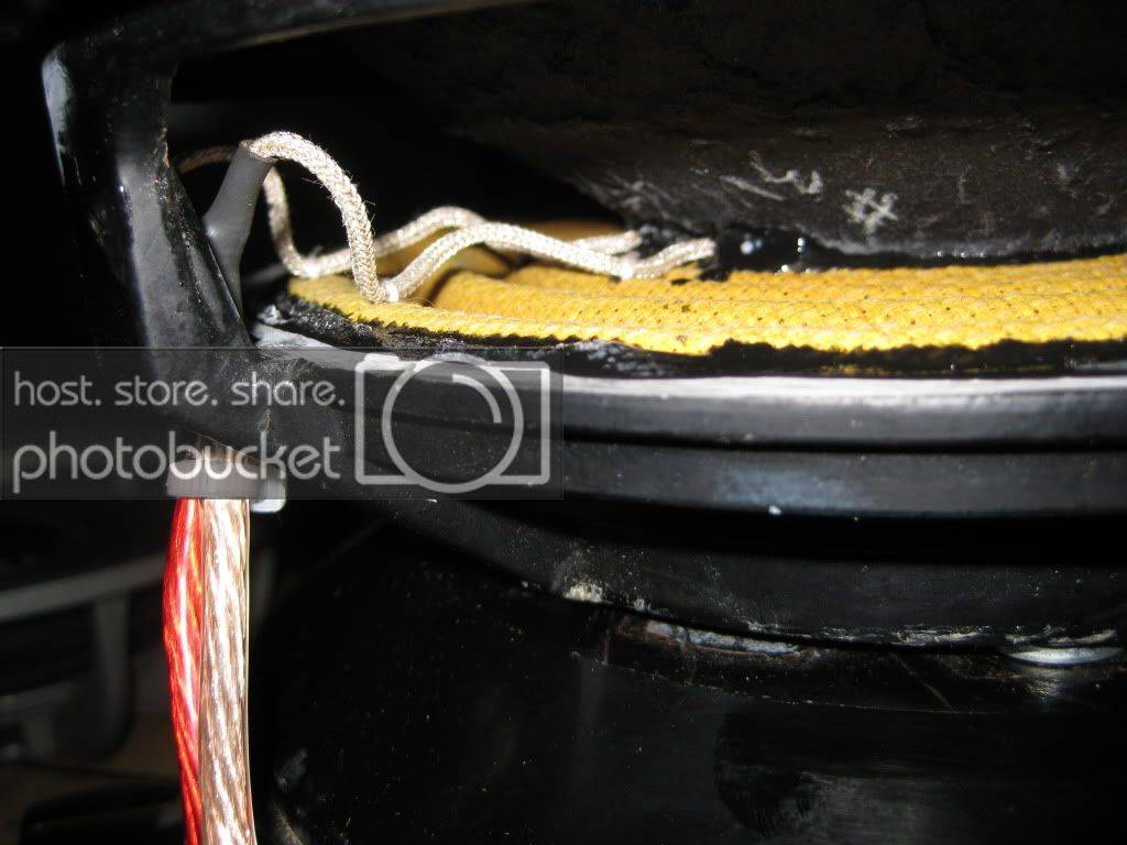

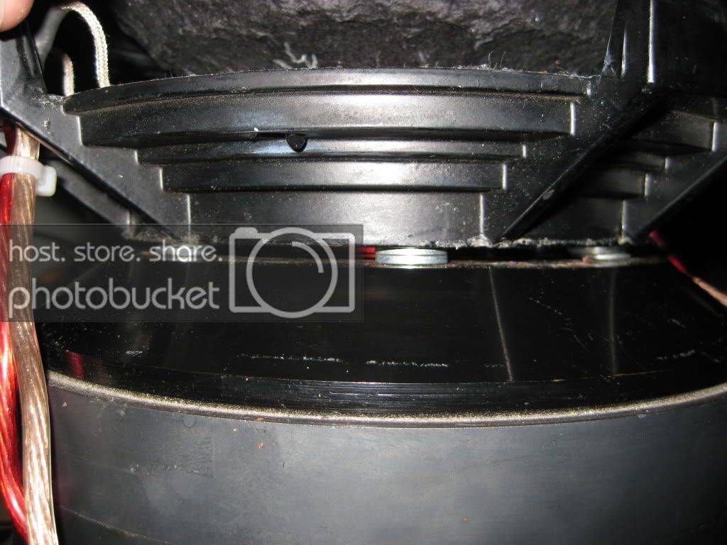

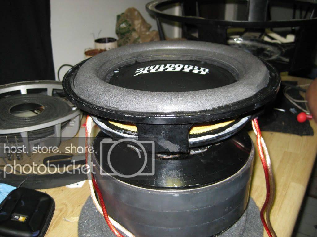

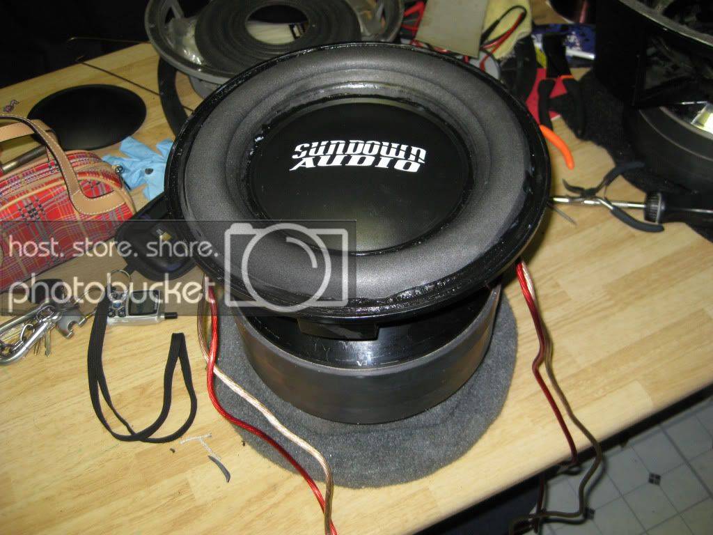

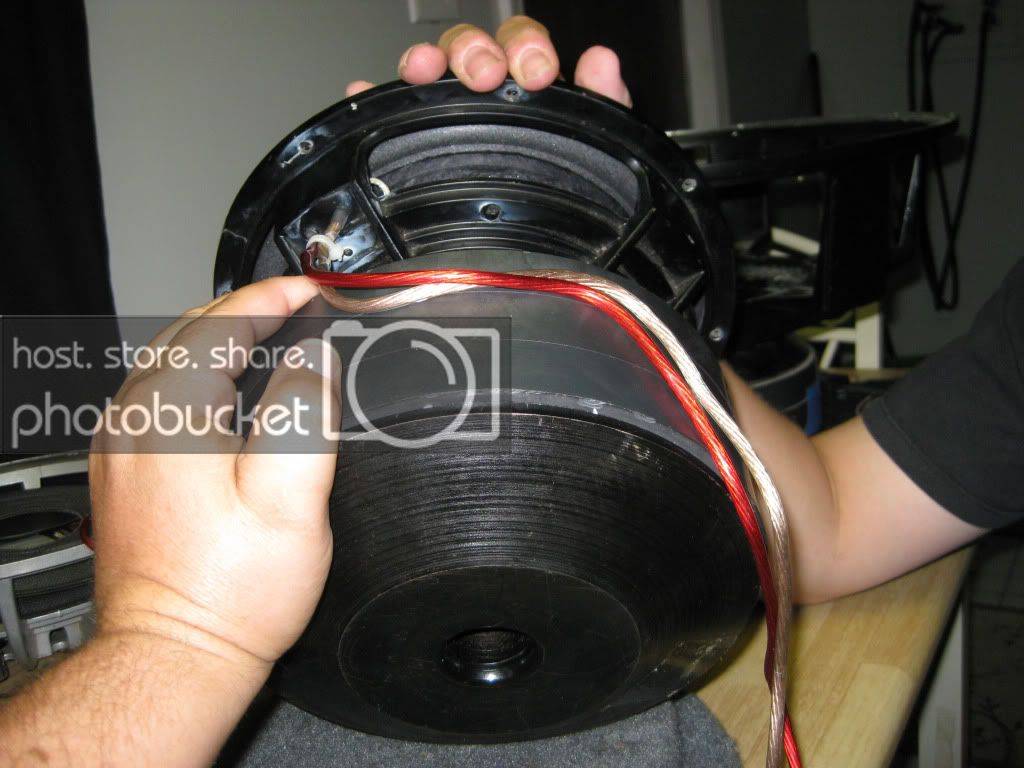

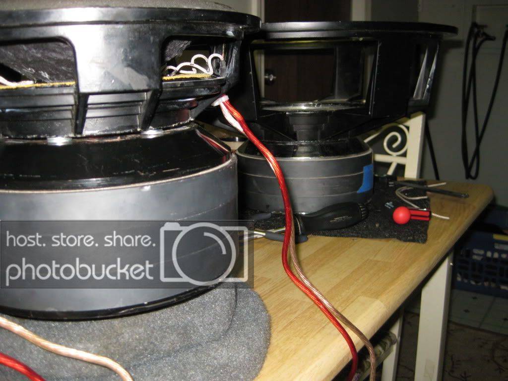

Sundown Nightshade motor / built into a 10" / by Alan Hall
:drinks:
built for a local Kid in Hammond Louisiana
I like big 10's like that //content.invisioncic.com/y282845/emoticons/biggrin.gif.d71a5d36fcbab170f2364c9f2e3946cb.gif
Im sure this is going to shreed itself apart in a week / the spider has more SD than the cone does //content.invisioncic.com/y282845/emoticons/smile.gif.1ebc41e1811405b213edfc4622c41e27.gif
the motor is going to ripp that surround a new @ss / the excurrsion alone is going to do this thing in /
i see a re-build into a 15" SD NS asap / the kidd was warrened, but he insisted on a 10"
Im sure this is going to shreed itself apart in a week / the spider has more SD than the cone does //content.invisioncic.com/y282845/emoticons/smile.gif.1ebc41e1811405b213edfc4622c41e27.gifthe motor is going to ripp that surround a new @ss / the excurrsion alone is going to do this thing in /
That's what i was thinking in my first post,lol!
