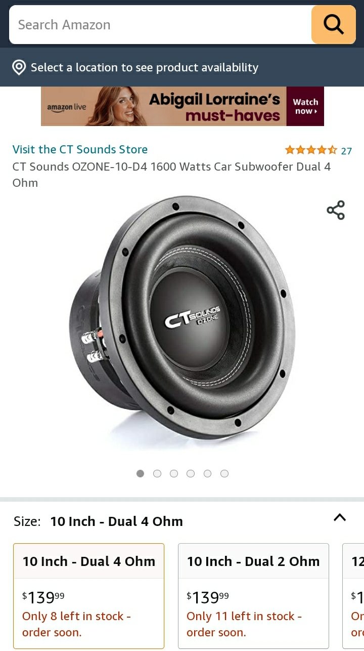

Have you considered these subs? The SIA amps are actually a Chinese board with Korean parts. I currently run an SIA3500 and haven't had a problem.
I don't really know much about CT sounds but the price difference is really close to the American Bass, not sure which one I should pick in this instance. Do you think my electrical could even handle 2k+ watts (after factoring in inefficiencies)?
You've recommended me a Sundown SIA in a previous post and that line of amps has been intriguing me since. I really do want to get the Sundown SIA amp because of its features and price point, but I still am off put by people talking about the SFB line catching on fire and apparently 2 amazon reviews talking about fires on the SIA (which tbh I think are probably fake because they were posted within the same month and almost the same complaint). I believe it is said that these amps are "smart" because they have a new system that prevents common failures for these types of amps, but should I trust it enough if I end up abusing it?
You just need to stay above 11.5 - 12 volts and you will be fine. I went through two SFB 3K's and Down4Sound immediately replaced the first one and let me upgrade to the SIA after the second one went into protect. I've been fine ever since. It's actually my installers new favorite mono amp for his budget minded customers.
